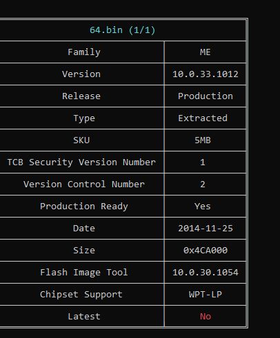

            Re: hi i need bios for dell latitude e5250
            Please help with ME region in E5250 ZAM60 LA-A891P i5-5300U.
            I change ME myself, but the size in MEanalyzer is different after replace. The board won't start.
            On my bin it work OK, but screen occur after 15-20s, as this is copied from other working board.
            Here is proper size of ME region on picture.
            Please help.
            p.s. Both above BIOS tested and wont work for me
              Please help.
              @rbvndonh
              What is the problem with your original BIOS?
              • rbvndonh
                • Mar 2021
                • 162
                • B
                Originally posted by onizzbox
                @rbvndonh
                On original BIOS computer switch on without without screeen. ME region looks half-empty on original one.

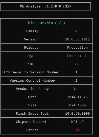

                    Originally posted by hoaca388
                    Try this file, make by me.
                    Unfortunatelly not working. Just switch on white diode 1 time for 2 secons and switch off Thanks for try
                    I see that available FIT from internet change size of ME Region. I think this is a problem why it won't work.
                    Do somebody have Flash Image Tool ver 10.0.30.1054 or could repair my bios with proper ME region size?
                    CPU is i5-5300U, i know some bios could be for i5-4310U, so maybe there is some difference also?
                    thank you
                        Do you have sevice tag number ?
                        ST on PW,
                        Here is missing 32bit bios:

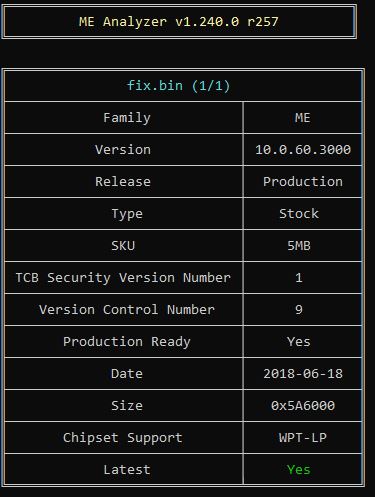

                        • hoaca388
                          Badcaps
                          • Jan 2022
                          • 11683
                          st on pw,
                          here is missing 32bit bios:
                            Thank you for your time and teaching me something new.
                            I made myself according to your hints and i think i get working file
                            On your file working like all others E5250, without lag.
                              I have a hint for every E5250 user. Seems the same is in E7240 model.
                              After replace BIOS and/or BIOS battery, if PC will be totally dead (no DIOD light and so on):
                              just leave it for at least 1 hour or even night.
                              Next day with plugged BiOS battery just connect it to power supply - most probably it will be fully working.
