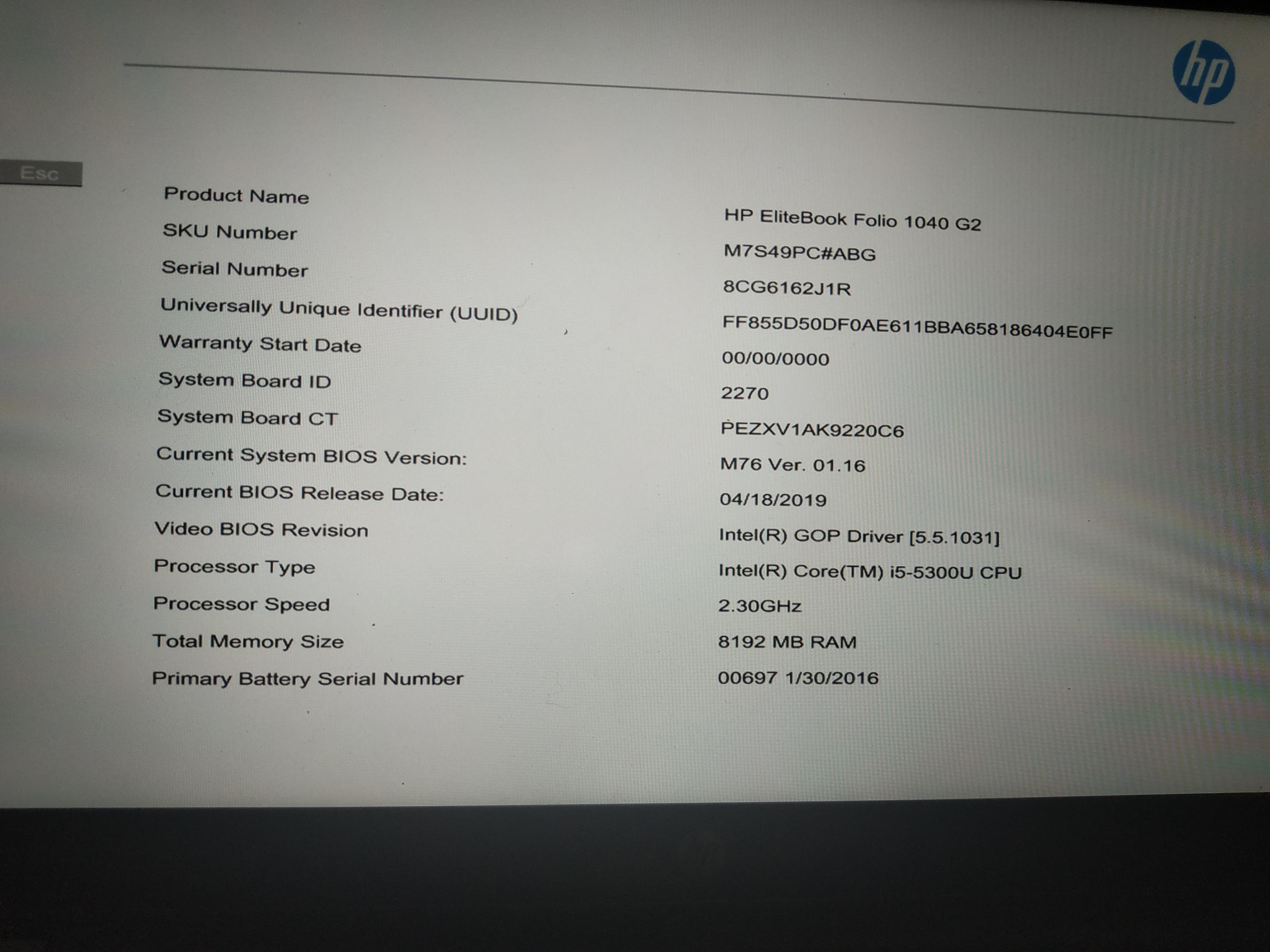

        Need 1040 G2 bios
        This my bios information

            I just bought a used folio 1040 G2 that's bios pw locked. HP is no help as they do not support this process anymore.
            How do I use this file to unlock it?
            • RethoricalCheese
              • Mar 2013
              • 1519
              • Estonia
              Re: any one unlock this 2 dump for folio 1040 and probook 650
              You don't use that file. You need to buy an SPI programmer, read your bios, use HPUnlocker tool on it or just upload it here. Then you write back that unlocked bios.
