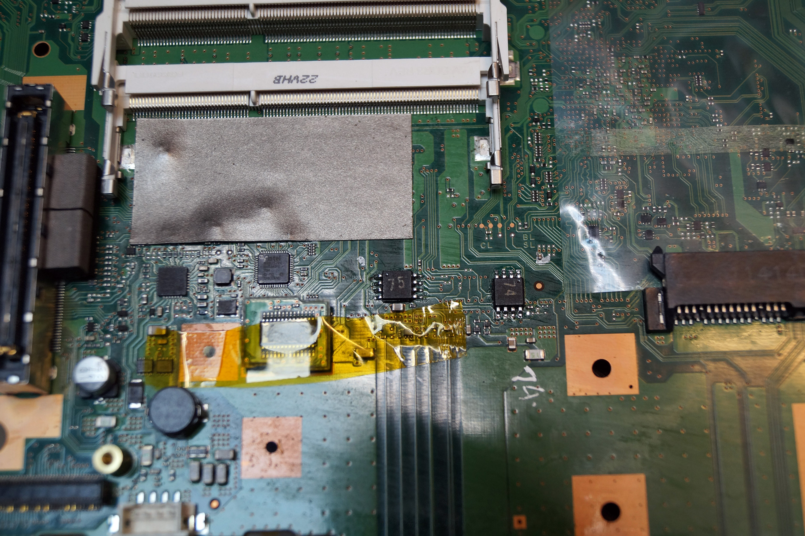

            Hi, I have the same issue with a locked bios on the E751 and wondered if anyone can help me further.

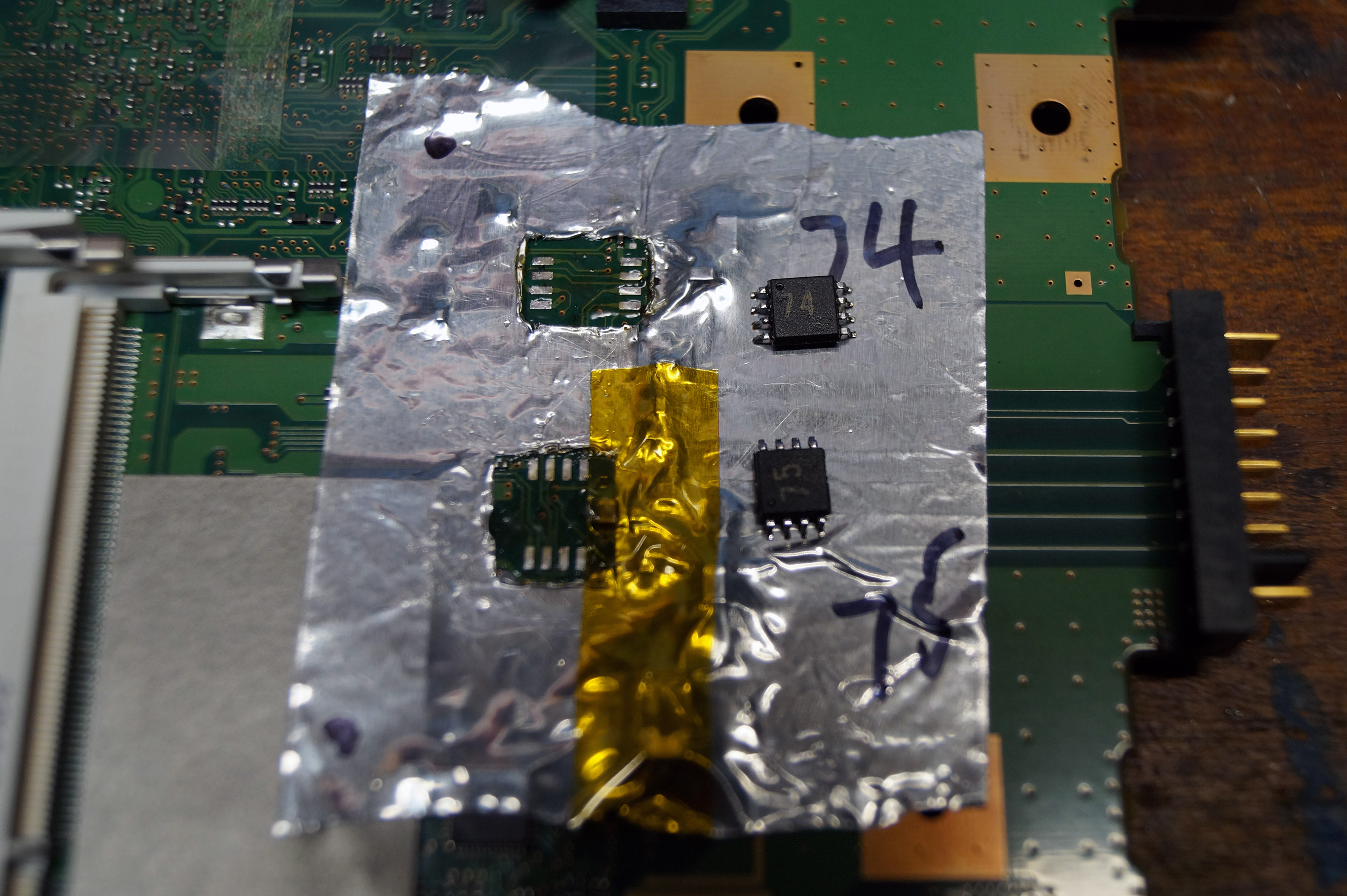

            I found on the motherboard a removable plug in TPM SLB9635TT12 chip next to two Winbond flash chips models 25Q80BVSIG and 25Q32BVSIG. These chips have had the numbers "74" and "75" stamped on them as below.
            Removing the TPM and booting without it installed made no difference to the password lock so I removed the flash chips and dumped the code.
            I could not find a password in this though (although I am not a pro at doing this) and only one of the chips looked like a bios file anyway.
            I downloaded the latest bios from Fujitsu and it doesn't look like I can just write the bin to the chip as it looks too different. It also comes bundled with a ROM so I am a bit confused!
            Any help as always greatly welcomed...
