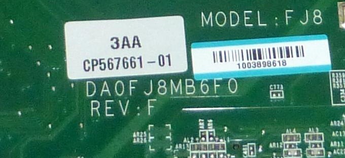

    Could you please make a clean me region Fujitsu LH532 for me ? Shutdown every 1 minute, need it so badly. Thank you so much, cheers..
    I Attach M/B Code and Ori Bios

    Backup your U7 chip (2MB), there is me region are storing...
    file above no me region...

      Oh OK, sorry , here is the backup u7. And thank you for your quick respond, salam kenal om..

        this is your file...bios-u7sd_new.rar
        But i suggest you:
        1. Before you flash u7, try U35 first with my file (FJ8A_110_W32.BIN), it is pure bios region extracted from update file FTS_BIOSAdminPackLIFEBOOKLH532G22_110_1074082.zip from fujitsu site
        2. If the file above also fails,then you can use the new U7 (bios-u7sd_new.rar) file ... and try again but still use file new U35
        3. if they fail also, try to flashing ec file U24(EC_U24_NEW.BIN) it was extracted from update file too...
        goodluck...

          Thx rioreno, I've follow step by step as you suggest.., and here is the result :
          1. It's display with Product name & S/N " Not Define "
          2. Power on but no display, current stay at 0.9 till 1.0 A
          3. same as step 2
          When I re flashed u7 with the old one while keep u35 & u24 with new files, an image on screen appears with current up to 1.4 A
          Wait for the next step from you

            1. Need fixed DMI only, i can fixed it.. but how about symptom shutdown every 1 minute? still appear?
            2. maybe has failed when i Clean ME region, i'll give another file
            3. Your old EC is ok.

              Thx a lot for your time, this is the result:
              1. Still " Not Defined "
              2. It's display now but the problem still there just like before, completely off after 1 minute even at bios setup
              3. As you say it
              Actually, I've 3 of this M/B at my table, same symptom and same model.
              FYI: Already try flashing them all and reball the PCH one of the M/B to make sure, very curious. I'm waiting for your next advise
              Best Regards

                This final clean me region for your files, if this file isn't worked too,So you must think about hardware problems not bios problems...
                u7=outimage(1).bin
                u35=outimage(2).bin
