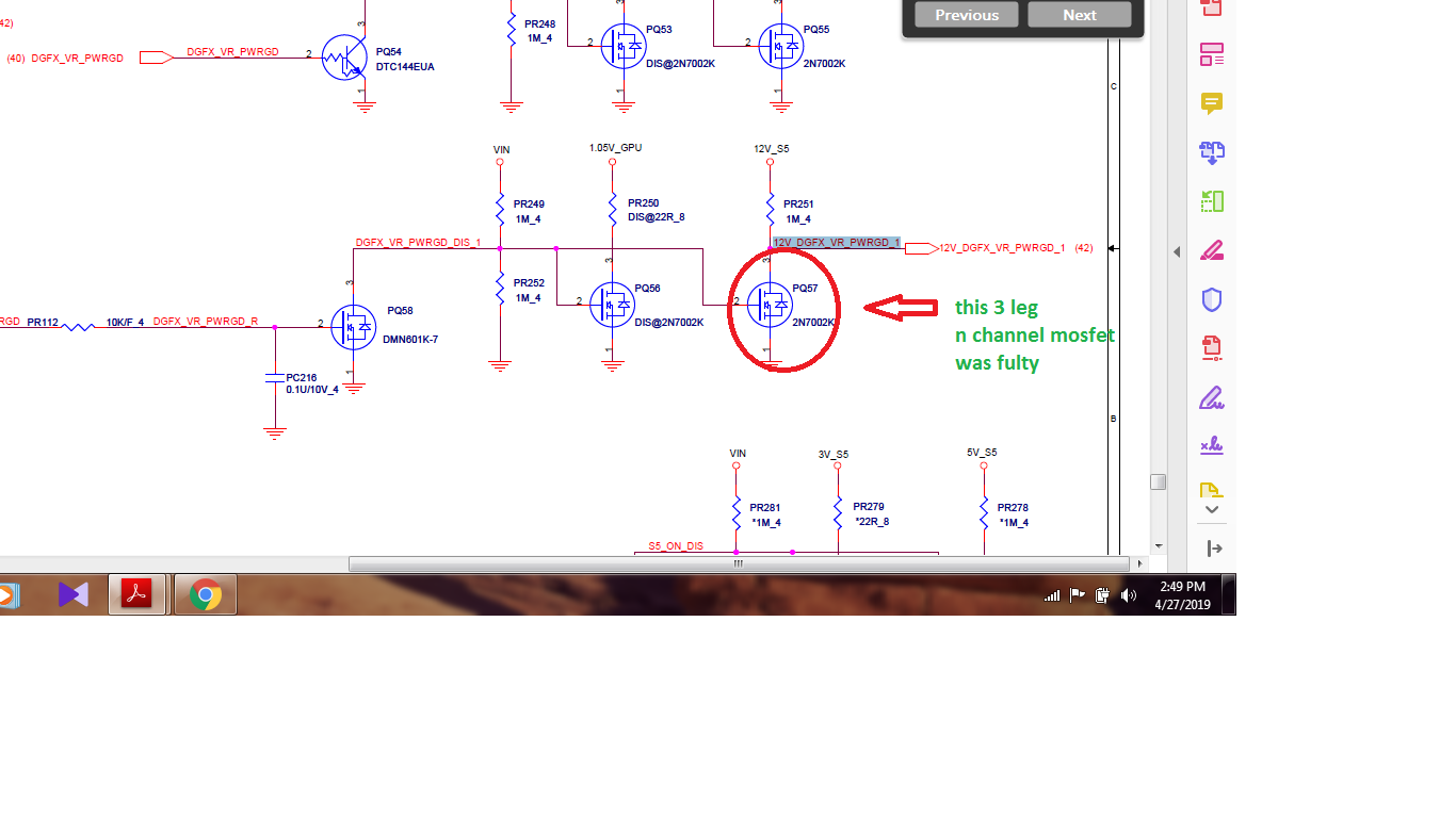

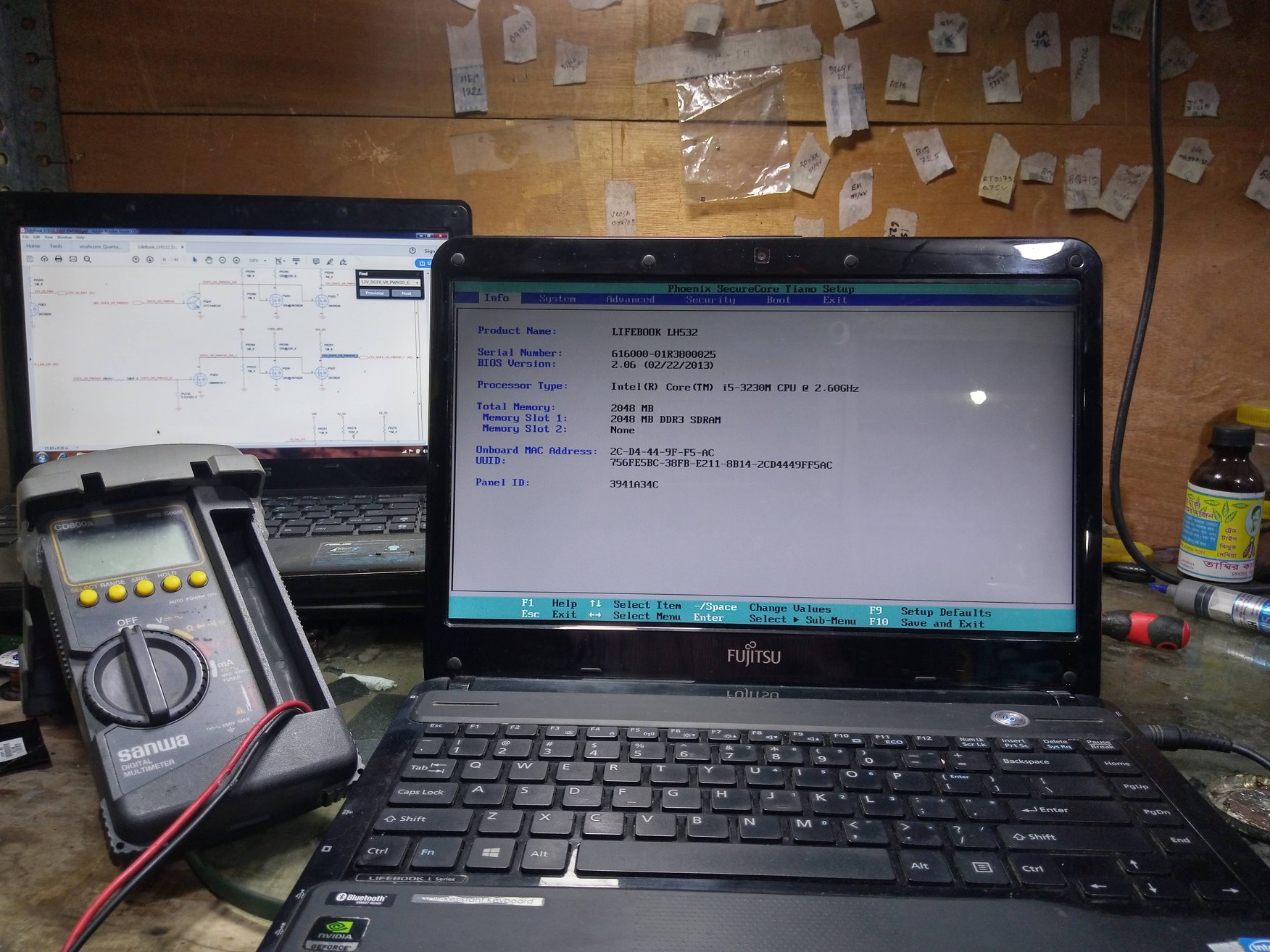

Fujitsu LH532 1 minute shutdown fix
  • Arsrin
    • Mar 2018
    • 9
    • Thailand
    Try........
