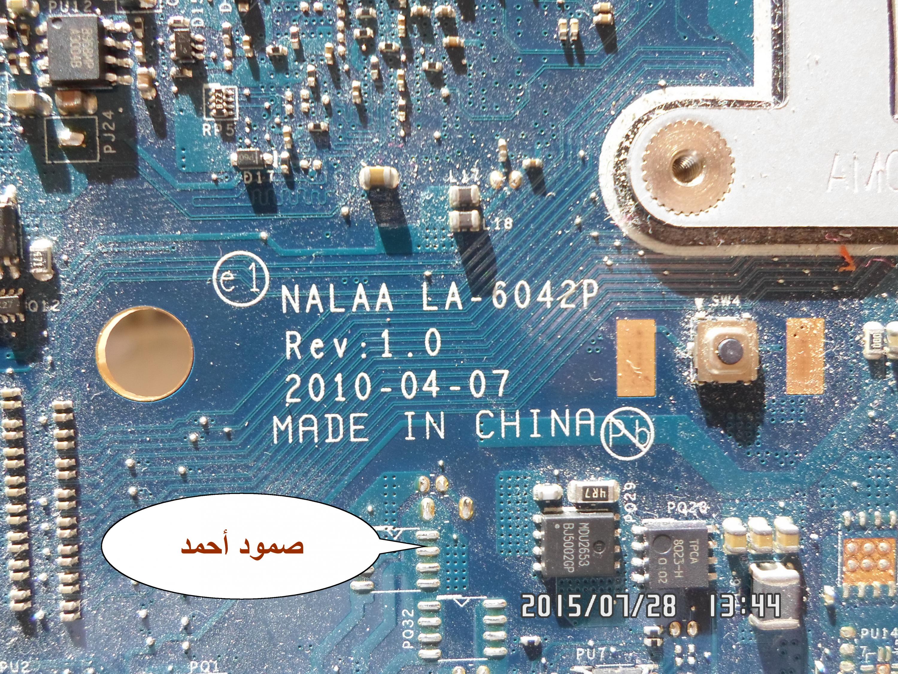

    Guys,
    anybody can post BIOS + EC Toshiba Satellite L670-1DW NALAA La-6042P?
    Thanks a lot!

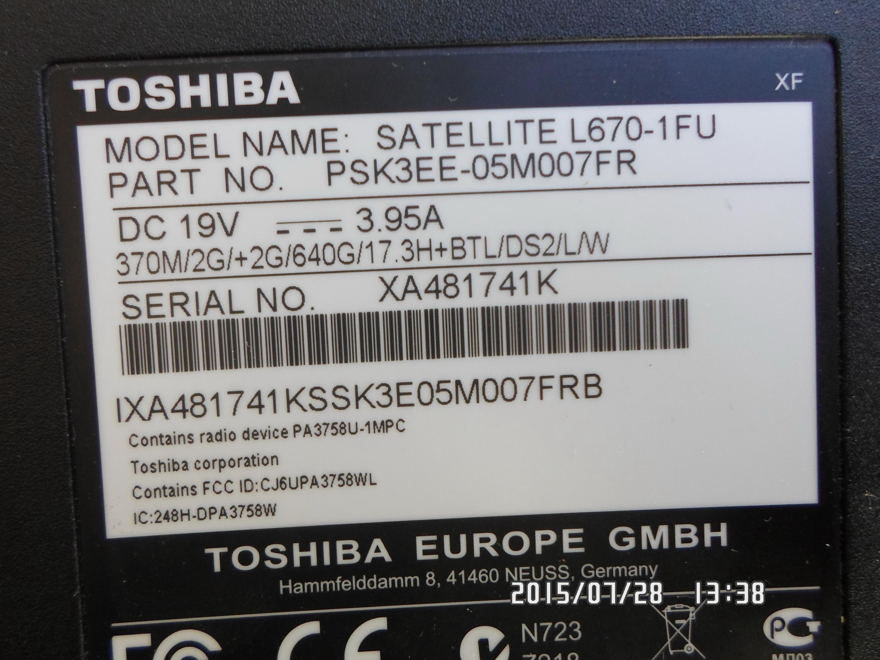

    Re: Toshiba Satellite L670 BIOS please
    i have only the main bios of L670- 1FU core I3
      but i have 2 bios from arabic sites web of laptop maintenance
      and working bios EC+MAIN
          here you go
          backup your eproms
          if your ec is bigger than 128k read and post it here i will fix it
          if its 128k just write it
            Ala_borbe: probably different board, I have EC chip 256kB, not 128kB, but thanks anyway
            Ridamouh: one of that BIOSes have more than 4096kB, is that correct?
            Finally I found my BIOS and EC are OK, probelm was in the PCH. So I attach my files 100% working
              those 128k are first 128k from 256k ec, rest stays the same
              so with hex editor it can be pasted on old ec read from board
              Im Back... sort of...
                Thanks for explanation.
                If I understand right, when I use old EC chip, I can write 128kB dump, but If I have a new chip, I should write all 256kb image?
