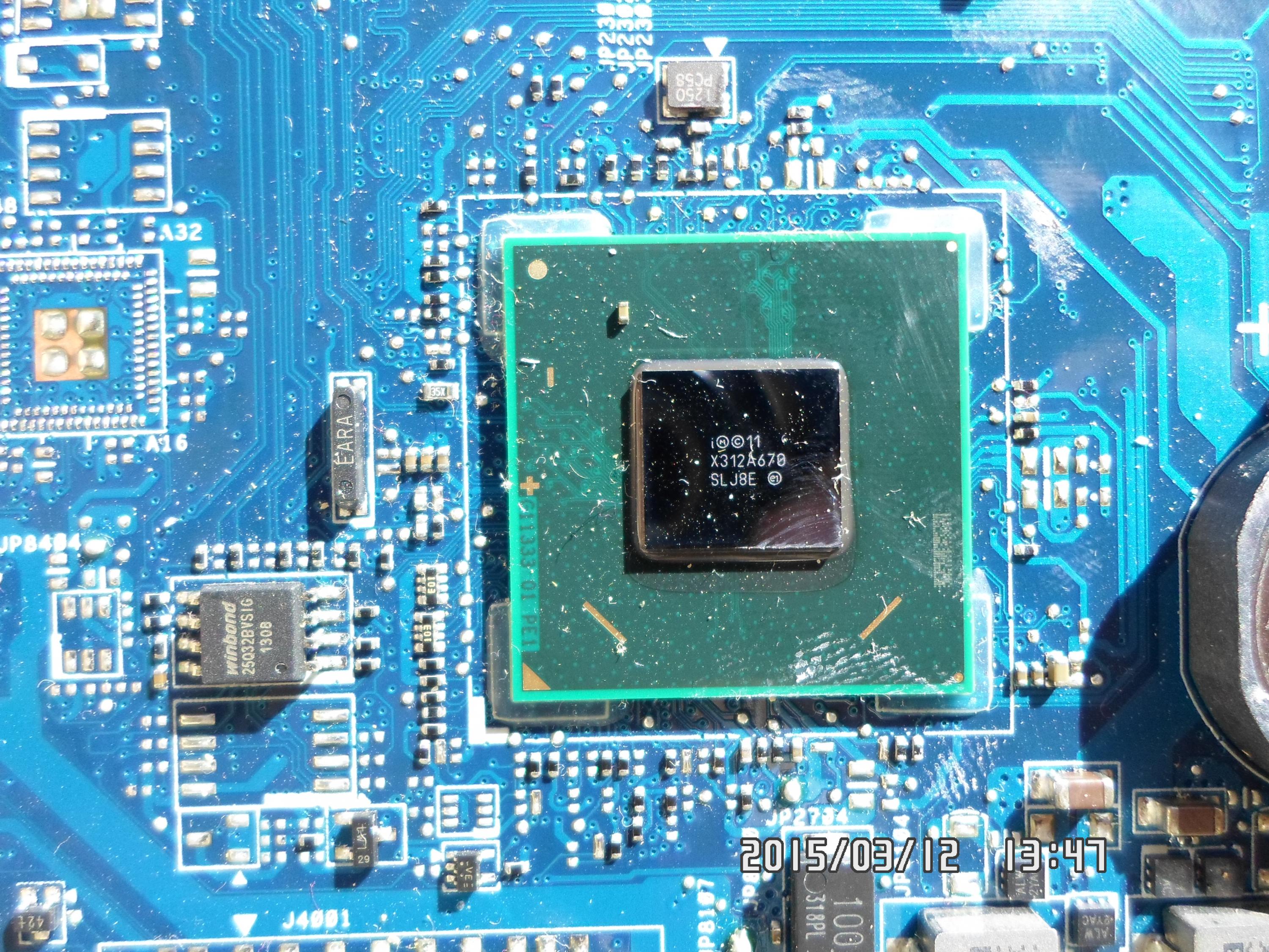

    Hi. I need to know / find out where the BIOS chip is on a Toshiba Satellite L855-10P.
    I looked through the manual (about half way through thus far).
    I have taken some pictures of the mobo which I will try to attach when I figure out how.
    Seeking advice please!

    Re: Location of BIOS chip on Toshiba Satelitte L855-10P?
    near from chip
      Hi, the BIOS chip is a Winbond W25Q32BV, U300 on the motherboard.
