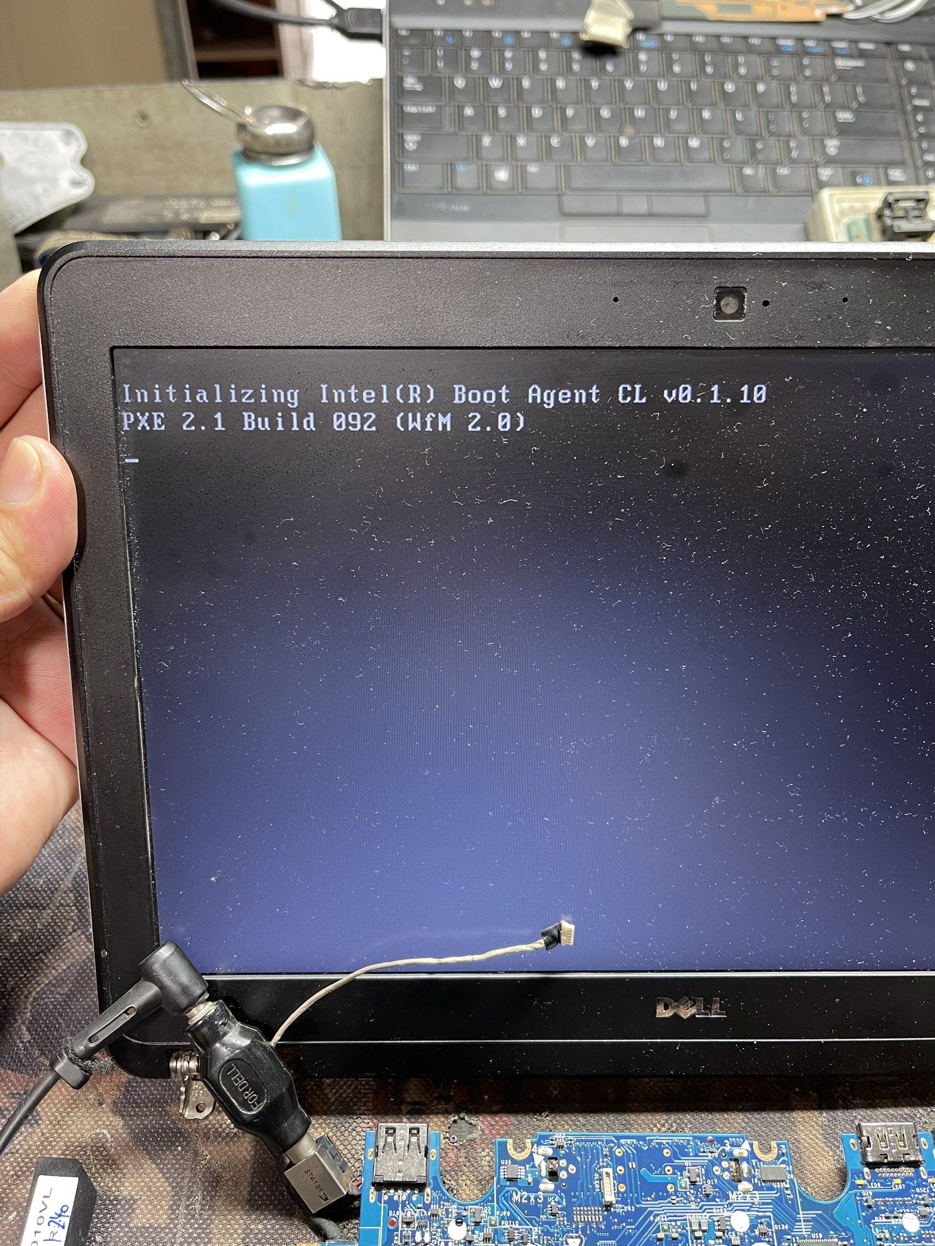

    ME with 9.5.14.1724 seems to crash very often in this model
    Just 8mb chip reflashed and all work great.

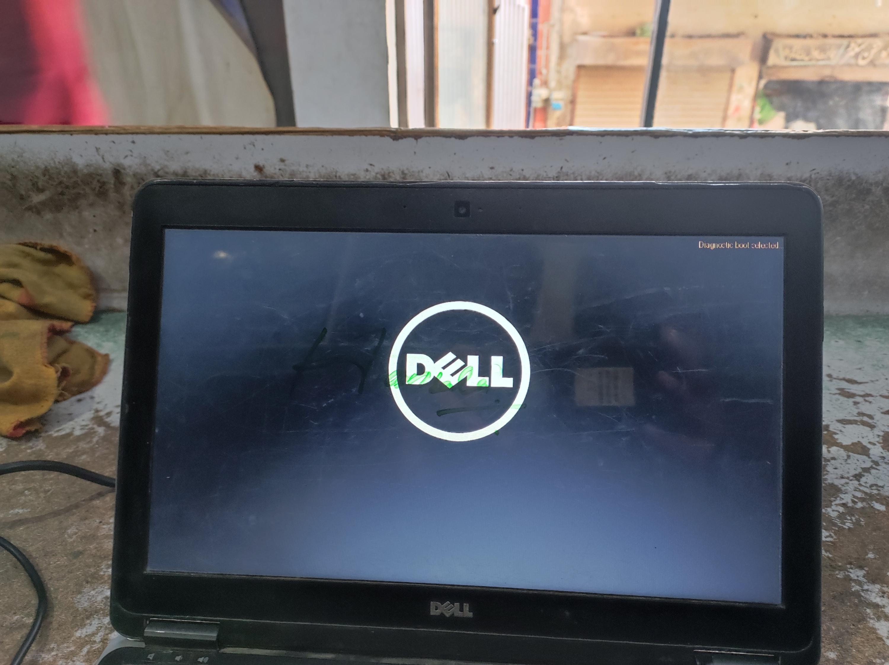

            i have e7240 laptop VAZ50 LA-9431P REV 1.0 (A00)
            Somebody already changed its original bios and now first display comes late and hangs. sometime there is dignonistic boot on screen and hangs.
            Need working bios for that laptop. can anybody help me???

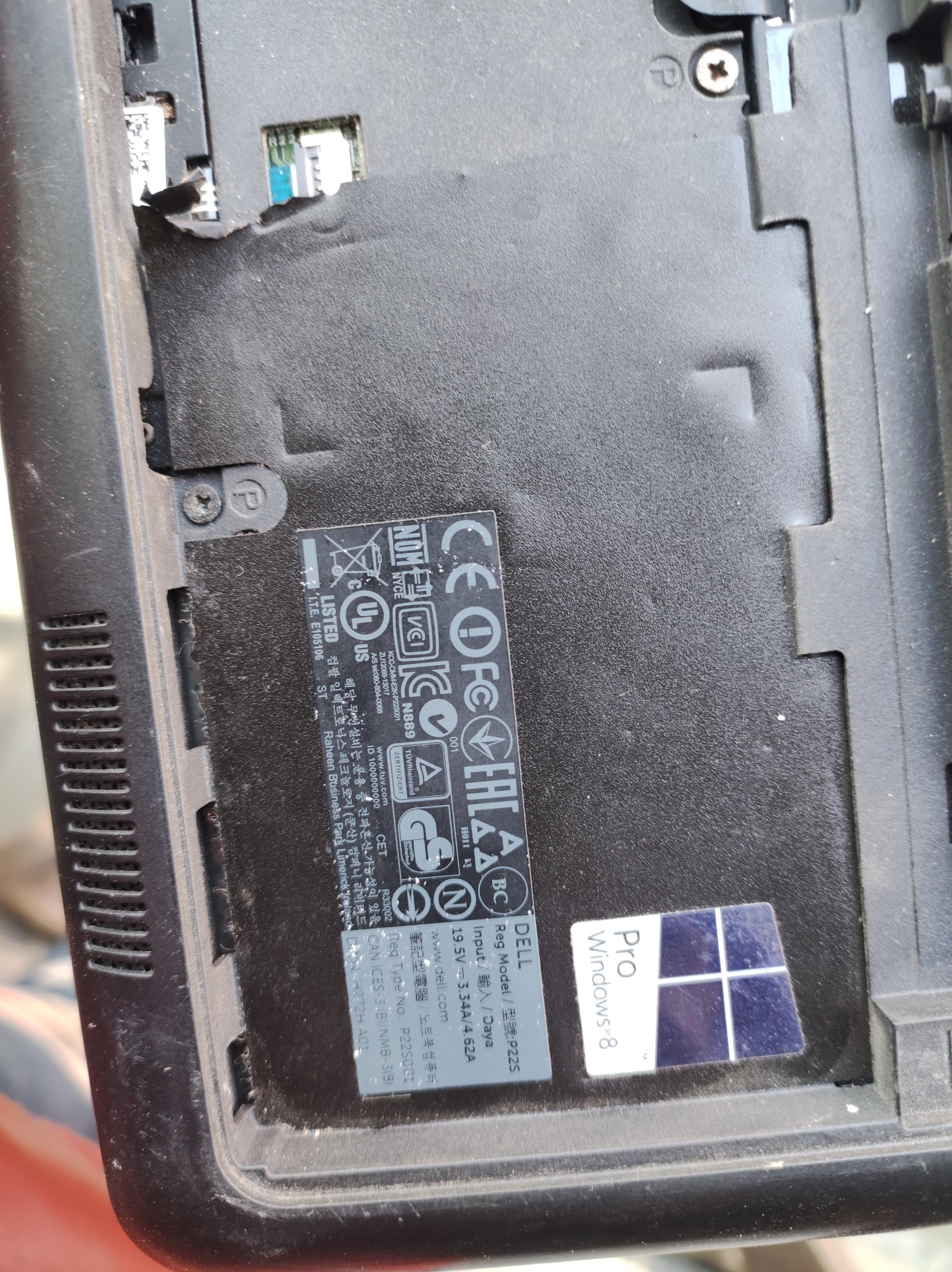

                service tag sticker already removed by someone
                just have 1 more info sticker

                  Youve attached 3 bios. The third is from post #19. This model can have 2 configurations with a single bios chip, (post #19 bios) with 1.5MB ME firmware and the other configuration has 2 bios chips with corporate ME firmware.As the ME firmware is bigger 5MB it can`t fit onto a single chip so its split accross U1 and U2 . To clean the ME firmware both chips U1 and U2 have to be joined together first using a hex editor.
                  You can`t flash the single chip bios (#19) to U1 as your configuration is 2 chips.

                    Yes sir u r rite, but i cant do it myself

                      i know but you should try .

                        Thanks sir
                        Its working
