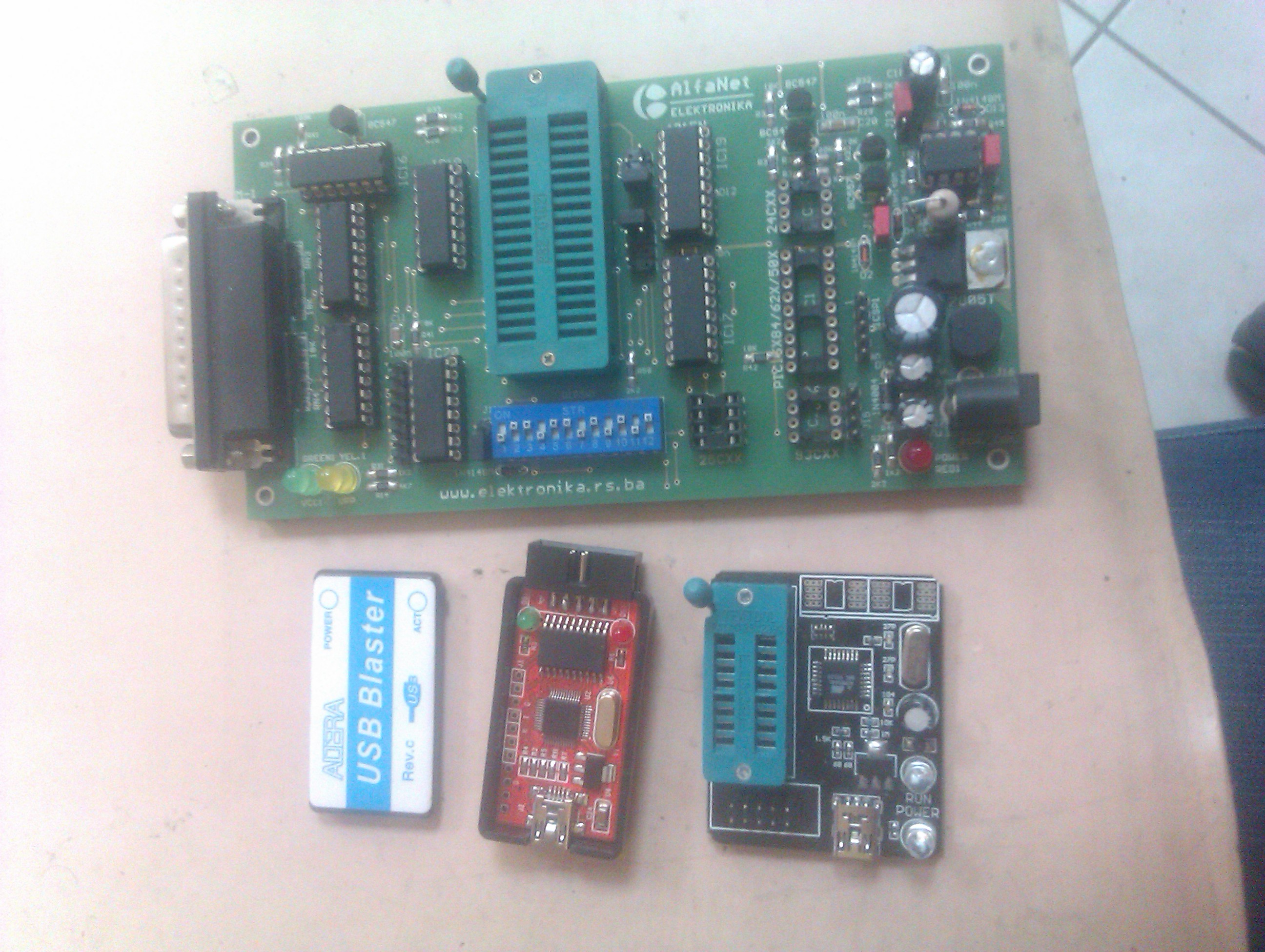

what do you mean with "what eprom"? if you think what programmer i use some cheap 25T80 from ebay but i also have built Willem for some other stuff
