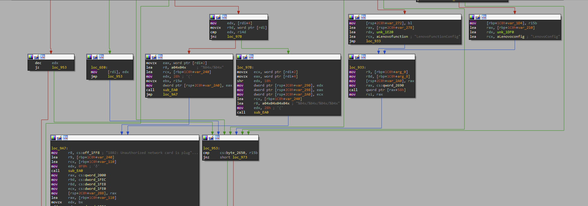

    My Lenovo X380 Yoga:
    Model: 20LJS0MP00
    SN: MP1ME1R9
    BIOS: 1.41
    BOard: LA-F421P
    does not accept my WWAN cards Sierra 7305 or 7455. I get the dreadful "1802 unauthorised card..." message.
    I have spent hours searching for a patch and stumbled across
    https://github.com/digmorepaka/think...rmware-patches
    I have tried the xx70_xx80_patches_v7.txt file (using UEFIpatch) and some patches could be applied but not
    those of the whitelist section.
    I even extracted the LenovoWmaPolicyDxe_LenovoWmaPolicyDxe part of the BIOS and fired up ghidra. I found
    the 1802 message but not the place from where it's referenced so I am stuck now.
    I have attached the BIOS dump (obtained from the unsoldered Chip) in case s.o. can help me.
    Thanks in advance!

    https://www.badcaps.net/forum/troubl...55#post3576855
    you need to change your jumps here. compare files to find
    Click image for larger version  Name:	image.png Views:	0 Size:	99.4 KB ID:	3732825
    use only efi file (pe32 body) to disassemble and make your modifications on the FFS

      Thanks, but thats exactly the file I analysed in ghidra. I even found now the function which references
      the 1802 message (after enforcing a disassembly on that region). It leads to a result comparable to
      your pic.
      However, this function is called 4 times, but only from another function which also never is being called.
      I must admit that I've never been an x86 assembler guy (ask me 68k or MSP stuff and we're fine ;-)).
      I might be able to patch the return codes or remove the "while true" loop in the end and do try-and-error...
      The problem is, I have to solder and desolder the chip each time since using some clip adapter and accessing
      the chip in-circuit proved to be error-prone.
      • LncAhG
        • Dec 2021
        • 4
        • deutschland
        The function which checks vid and pid and so on does more than simply compre them.
        For a match, it apparently also calls some kind of initialisation code, depending on the device found.
        And this does more checks that can lead to a failure which in turn emits the 1802 message.
        The whitelist contains (among others):
        Code:
        00001f60   02 00 00 00     uint32_t  2h                      category
        00001f64   99 11 79 90     uint32_t  9079 1199h              vendev_id
        00001f68   99 11 78 90     uint32_t  9078 1199h              subsys_id
        00001f6c   00 00 00 00     uint32_t  0h                      unk
        Which is a EM7455. I inserted such a device but the 1802 remains...
