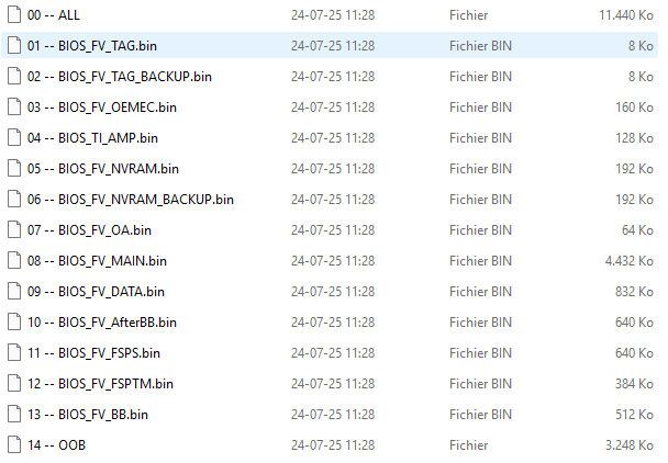

    Alienware area 51m R1 Bios avec BiosUtilities LA-G881P Rev : 1.0(A00)
    I maybe posted on the wrong forum so i post it here, tell me if it's not good :
    I would like to flash the bios chip with the latest bios found on dell's website and we'll see what to do next.
    I got the RCV file (Alienware_Area-51m_1_28_0.rcv) and extract it with biosUtilities, the result was in this picture
    My first questions are: -Is it the BIOS_FV_MAIN.bin tnat i have to put on the chip, because it seems to short?
    -Taking into account that there is no ssd nor hdd is it ok to flash a "factory" BIOS?
    hope it's clear enough, if you have any questions don't hesitate.
    thank you in advance😊

    Post your bios backup and the service tag

      Hi, thank you for your response,
      the service TAG is 3W0QMV2 but i didn't do a backup bios yet because I bought this Alienware -->
      https://www.badcaps.net/forum/troubl...51m-r1-bricked
      without any ssd or hdd and given the history I don't know if Ihave to or if I can go with a "brand new fresh" bios if I make myself clear​😅

        Sorry, i just saw that the image was not uploaded, here it is.
