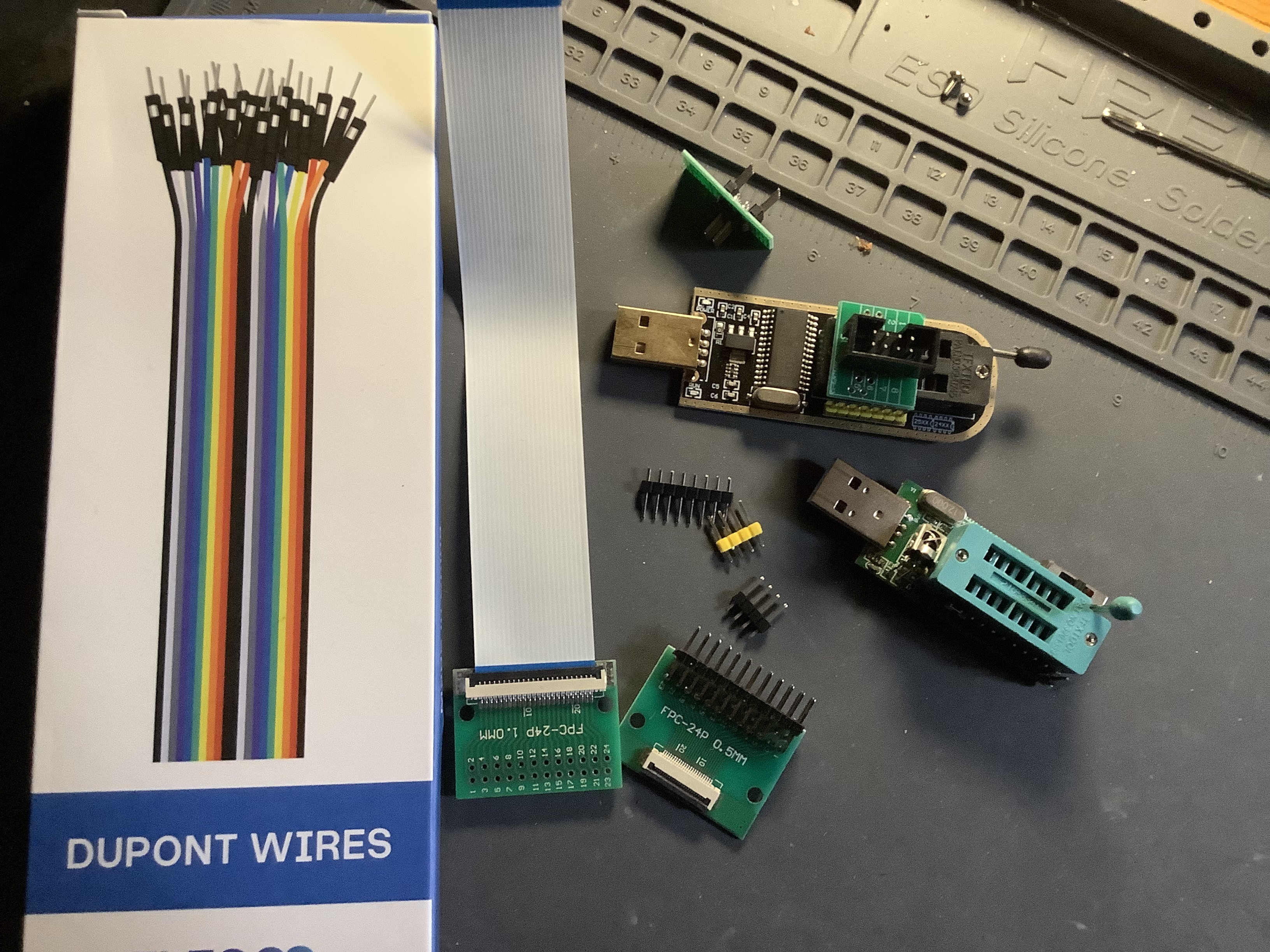

    Which ITE EC SPI programmer hardware do you have, post a picture of it.
ID:	3675476 I will access the EC via the keyboard connector

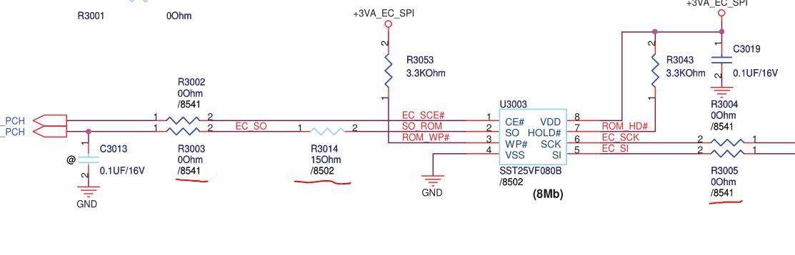

                    The board with IT8570E dont have U3003?
                          This is the schematic i was looking at https://bachkhoapro.edu.vn/fileuploa...34a453c2da.pdf

                            Originally posted by SMDFlea
                            ok.
                            In that schematic U3001 are a IT8512E-L ( IT8512BX / IT8512CX / IT8512DX ) and exist U3003 ( SST25VF080B ).
                            In the another schematic, U3001 are a IT8500E-L ( IT8570E ) and dont have U3003.
                            Thats its my observation.
                              • 20674
                              The IT8570E chip currently on the board might be different to what was originally there. A question for the OP is, is U3003 populated or not.
