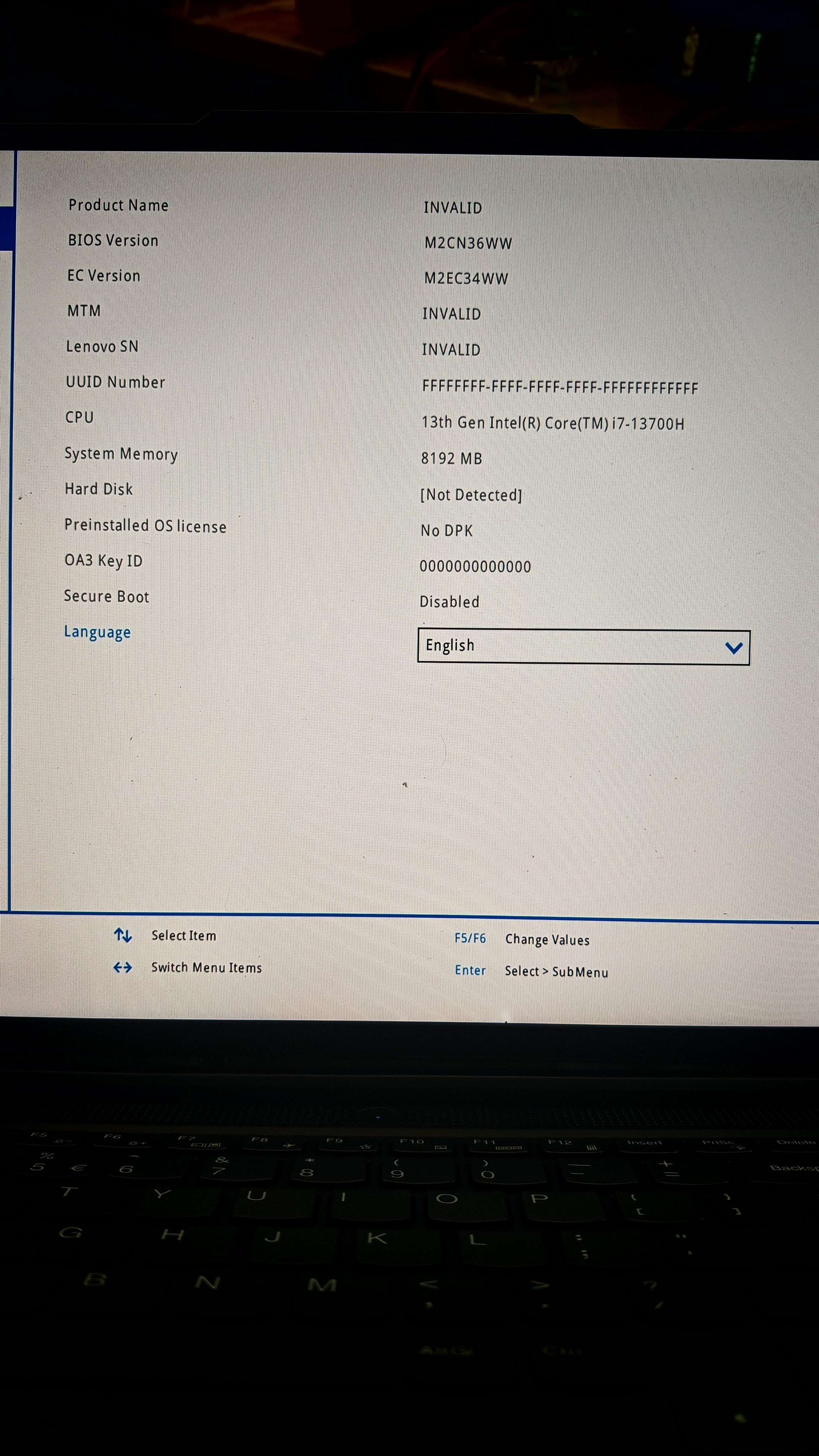

    Hello. Could someone fix my bios? It is damaged and does not start the laptop properly.
    After uploading another clean one from the Internet, the laptop starts but I do not have the SN numbers and Windows Key transferred. Please help​
    S/N -MP2KYGXH MTM; 82YA00FDMH
    MO- MPNXB3A05053
    motherboard -LA-M542P Rev.1
    MO- MPNXB3A05053
    bios extracted from Lenovo website update for Legion Slim 5 16IRH8 - Type 82YA
    DMI 1040000 - 1041FFF​
      I copied the code 1040000 - 1041FFF from my bin file but still No SN numbers

        • 24906
        Try it now. It looks like that area of your backup was corrupt, (i only copied length 780 rather than 2000) + additional DMI at 10F1000 - 10F103F

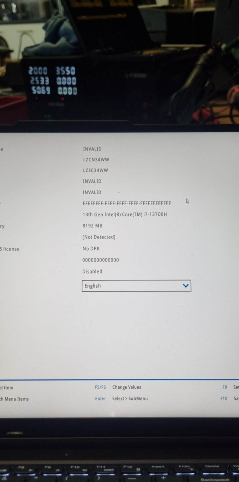

          Unfortunately, still the same ☹️☹️☹️
            https://www.badcaps.net/forum/troubl...r-bootable-usb
