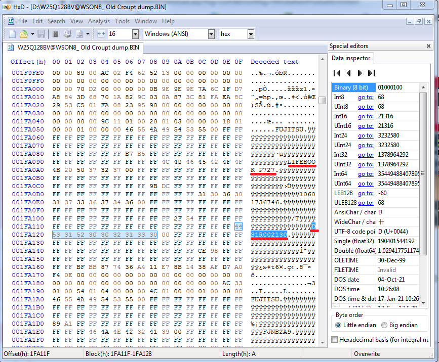

    Please someone Repair this bios?
    Board # CP719303
    CP717250-Z3
    I am attaching two bios one is original corrupted bios (no display system keep restarting)
    the second one from my friend (its working but when select boot from any source system restart but if stay on bios setup or boot menu its fine no restarting).

    Post the laptop serial number. There is a clean bios in this topic https://www.badcaps.net/forum/troubl...rd#post1660903 ,the offsets are provided so that you can copy your DMI,key, MAC address using a hex editor.

      No sticker at bottom cover, Possible to get it from Original dump?
