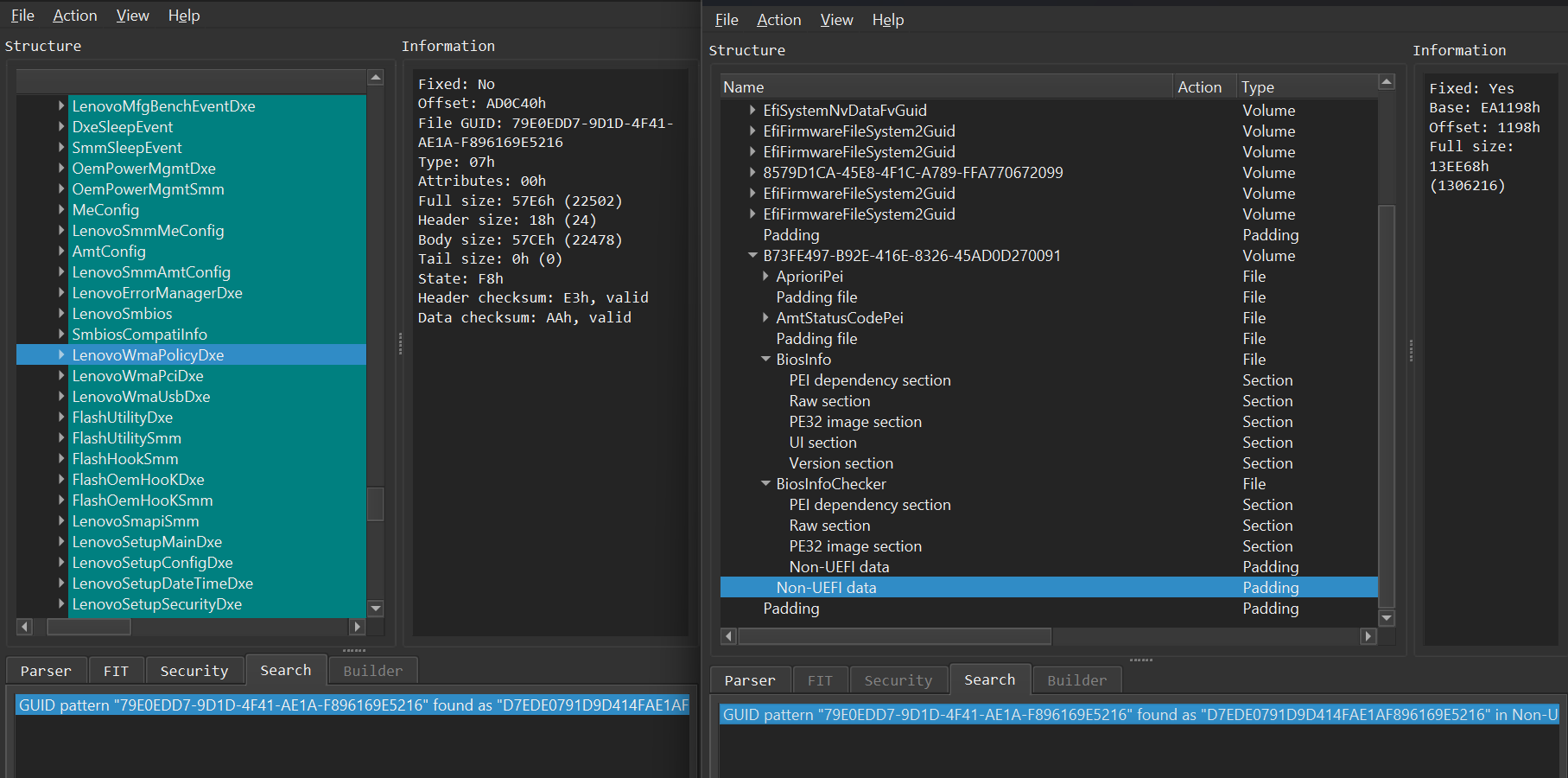

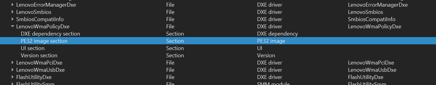

        I don't understand your bios.
        We should find LenovoWmaPolicyDxe there as in the T580 bios above.
        Guid 79E0EDD7-9D1D-4F41-AE1A-F896169E5216 but it tells me NON-UEFI Data.
        Are you sure about reading the bios​ ?

          Hmm, i've got this dump by CH341B programmer tool. Maybe it wasn't done properly.
          Let's try another dump - i did it via Universal BIOS Backup ToolKit 2.0 under windows
          • Maxpower3
            Bad Veteran
            • Feb 2018
            • 1375
            • France
            yes it's better

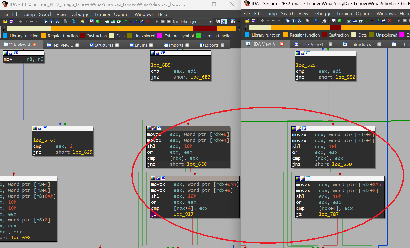

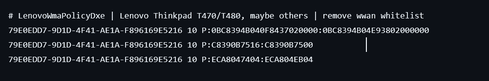

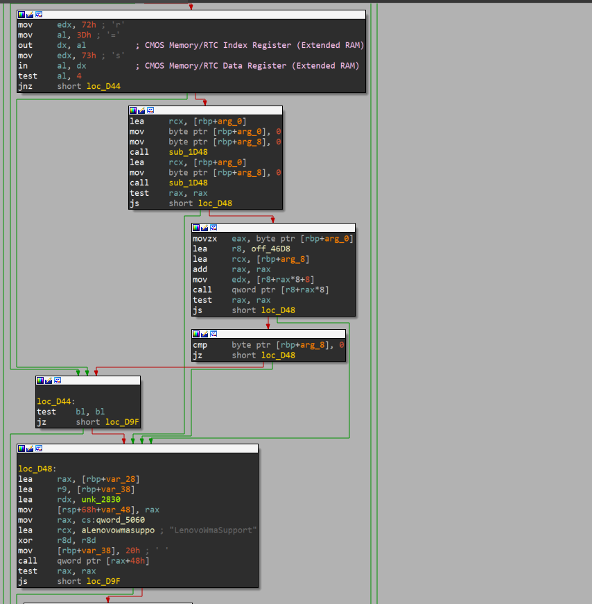

              from this patch?
              https://github.com/digmorepaka/think...rmware-patches
              Click image for larger version  Name:	image.png Views:	0 Size:	5.0 KB ID:	3576856

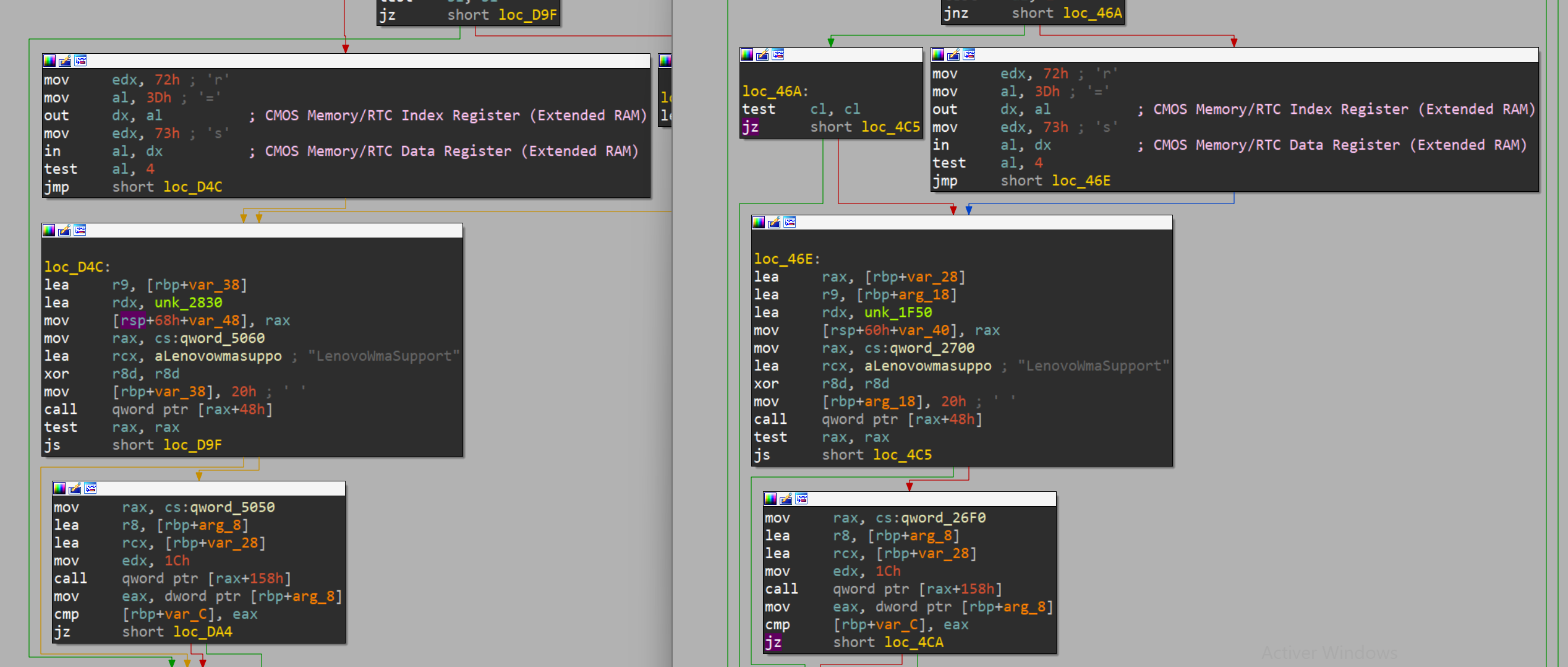

              we manage to find the first 2 conditional jumps.
              the addresses are different but the jumps are identical.
              Click image for larger version  Name:	jump compare.png Views:	0 Size:	229.6 KB ID:	3576857
              the problem is the 3rd modification. because the jump is different.

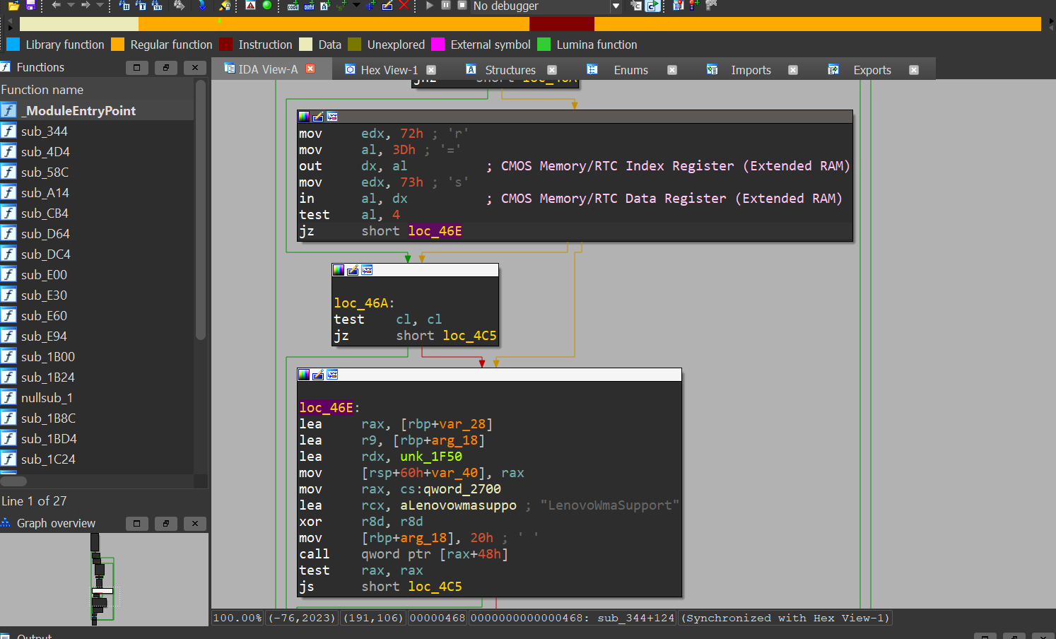

              if we look at the jump on a T480, we arrive there
              Click image for larger version  Name:	image.png Views:	0 Size:	137.2 KB ID:	3576858
              you must therefore find the location on the T580.
              what gives here
              Click image for larger version  Name:	image.png Views:	0 Size:	128.2 KB ID:	3576859
              several jumps are added between and it also contains a jnz (75) instead of a jz (74).
              Click image for larger version  Name:	image.png Views:	0 Size:	459.8 KB ID:	3576860
              it would therefore be necessary to do a jmp+4 to arrive at the same place
              so the solution would be to do
              ECA8047549:ECA804EB51 instead ECA8047404:ECA804EB04
              I made a file if you want to test it
              Difference between T480/580 or LenovoWmaPolicyDxe version?
              I don't know

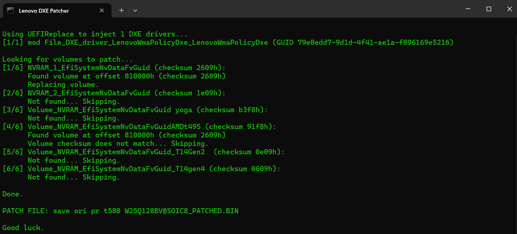

                • Maxpower3
                  Bad Veteran
                  • Feb 2018
                  • 1375
                  • France
                  Hello, thank's, will try
                  I succeeded on mine, however it will not work with the file provided.
                  You have to do otherwise.
                  Reread the bios with the programmer
                  (look at the comments on ch341 here on the forum. desolder the chip and do not use a clip)

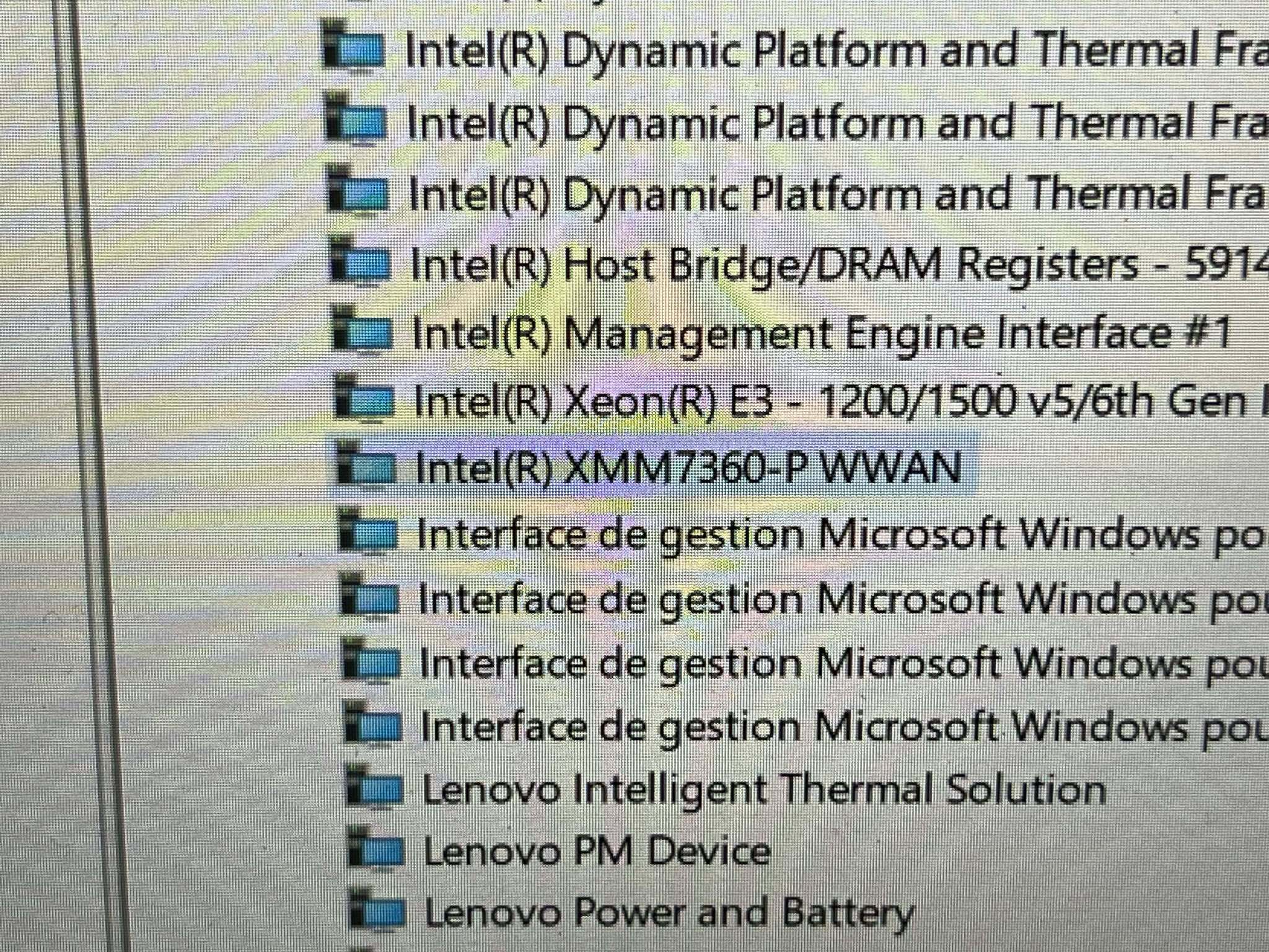

                  Tried with cards that are not compatible.​

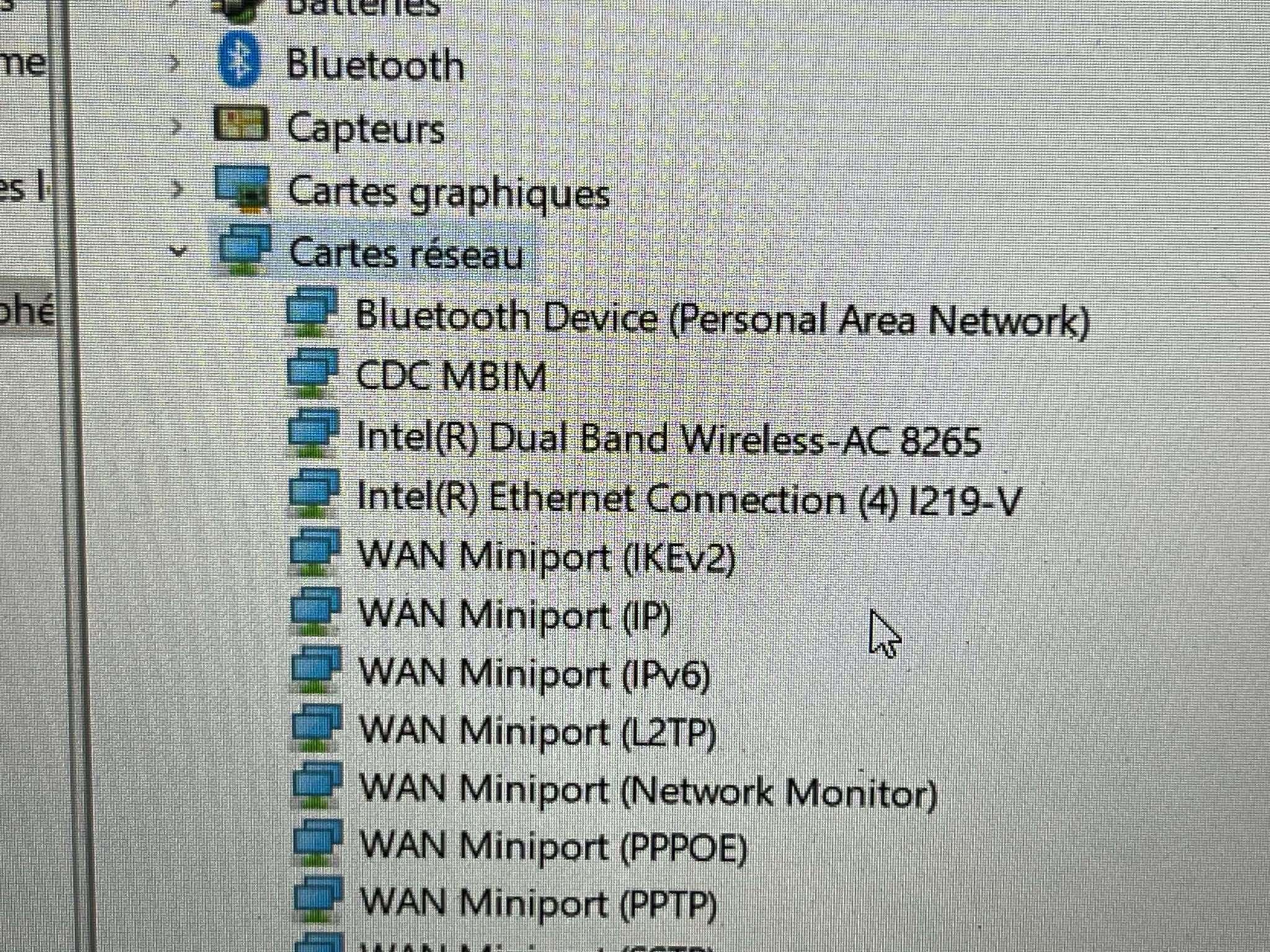

                  Now no more error 1802
                  Click image for larger version  Name:	478151117_508764395577541_2718516724426780089_n.jpg Views:	0 Size:	708.4 KB ID:	3578031
                  Click image for larger version  Name:	479727648_1686455428630353_1488921458446183968_n.jpg Views:	0 Size:	748.8 KB ID:	3578032

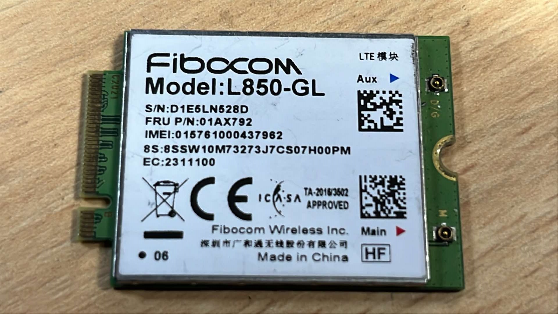

                  WWAN tested with this card
                  she is special (sick) supposed to be compatible but still error 1802.
                  Tested on dozens of PCs, always in error.
                  There is no better test than this

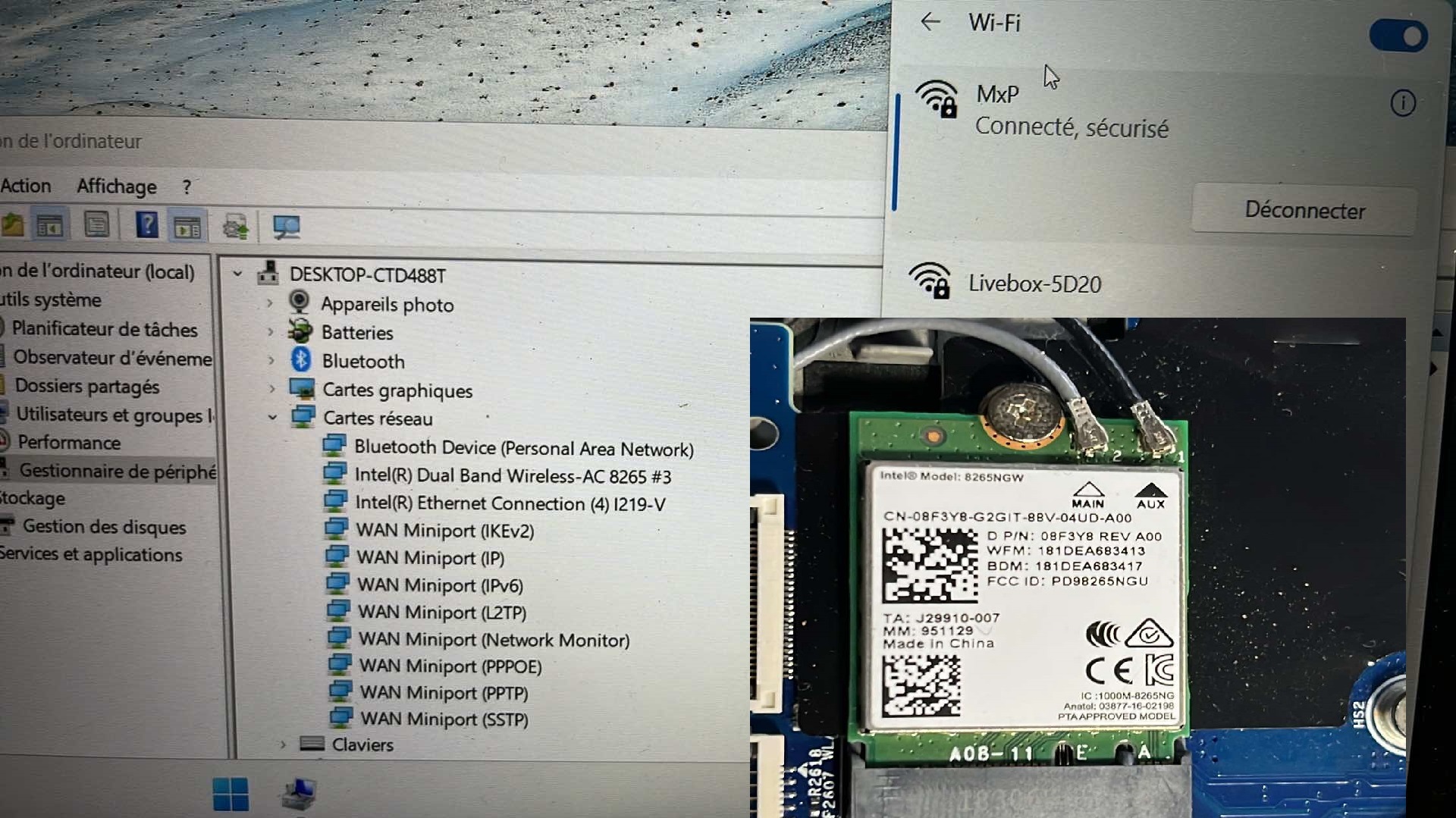

                  Click image for larger version  Name:	476223513_675469104805830_4197262753839642896_n.jpg Views:	0 Size:	257.7 KB ID:	3578061
                  Wlan tested ok with Dell card
                  Click image for larger version  Name:	477286837_2030696200730159_7750622164153905859_n.jpg Views:	0 Size:	381.9 KB ID:	3578060
                  Click image for larger version  Name:	image.png Views:	0 Size:	44.1 KB ID:	3578037

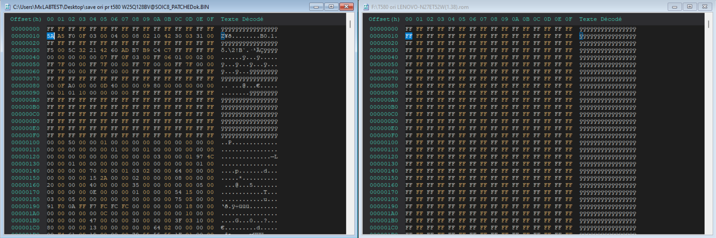

                    you cannot use Universal BIOS Backup ToolKit 2.0
                    because the start of the file is not present
                    Click image for larger version  Name:	image.png Views:	0 Size:	301.0 KB ID:	3578041
