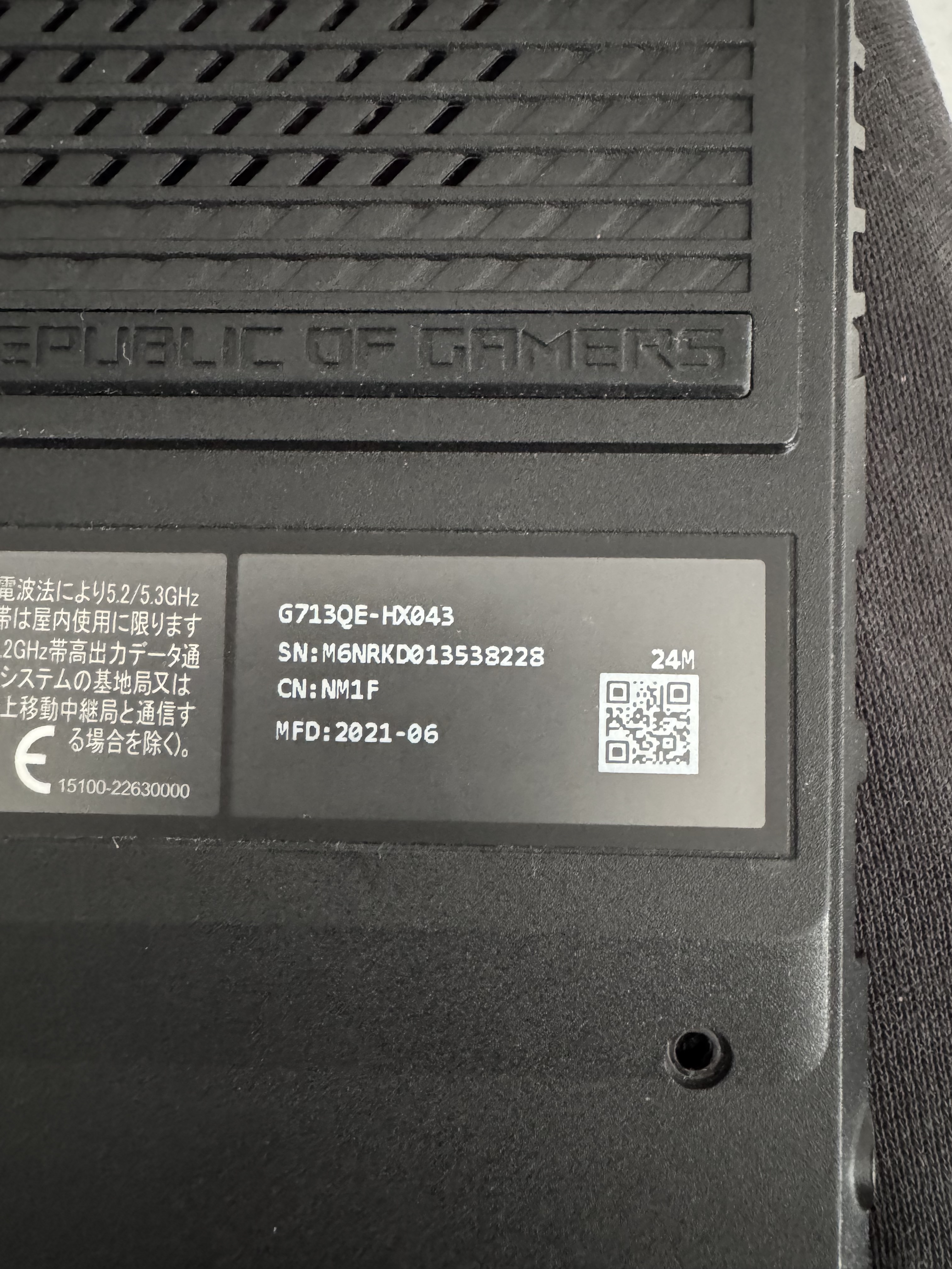

    I have this ASUS laptop that has a password locked BIOS.
    Can someone help me with a fresh dump or just clear the extracted one, please?
    Model number: G713QE-HX043
    Motherboard model is G513-6050A3249301-MB-A03(A3)
    Serial Number M6NRKD013538228​
    Thanks!

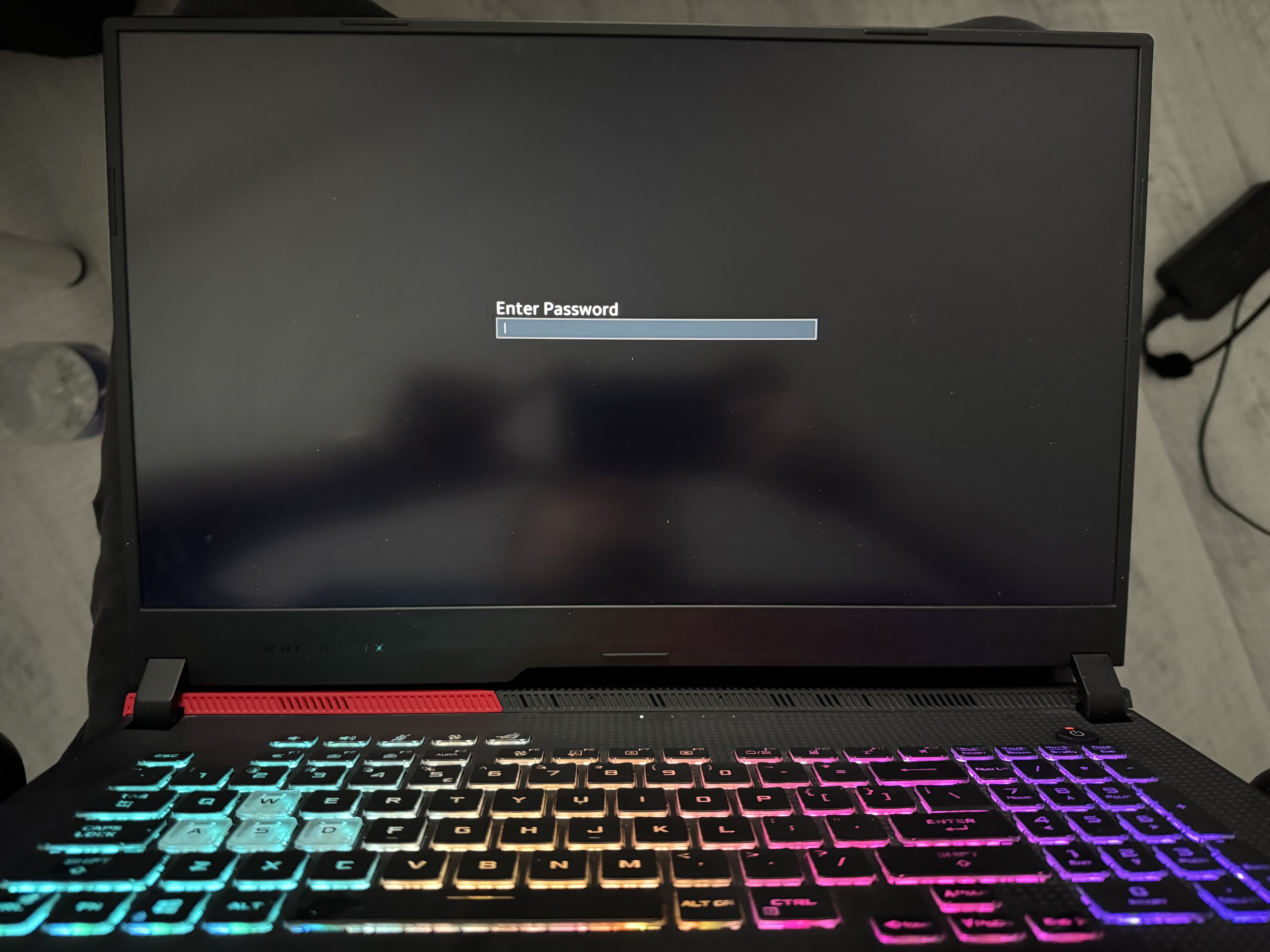

    DariusBogo attach bios backup and attach password screen .
    • DariusBogo
      • Apr 2021
      • 29
      • Romania
      Here's the BIOS backup. I uploaded in the original post but it doesn't appear for some reason.
      I'll update with the password screen shortly.
      Edit: Attached password screen

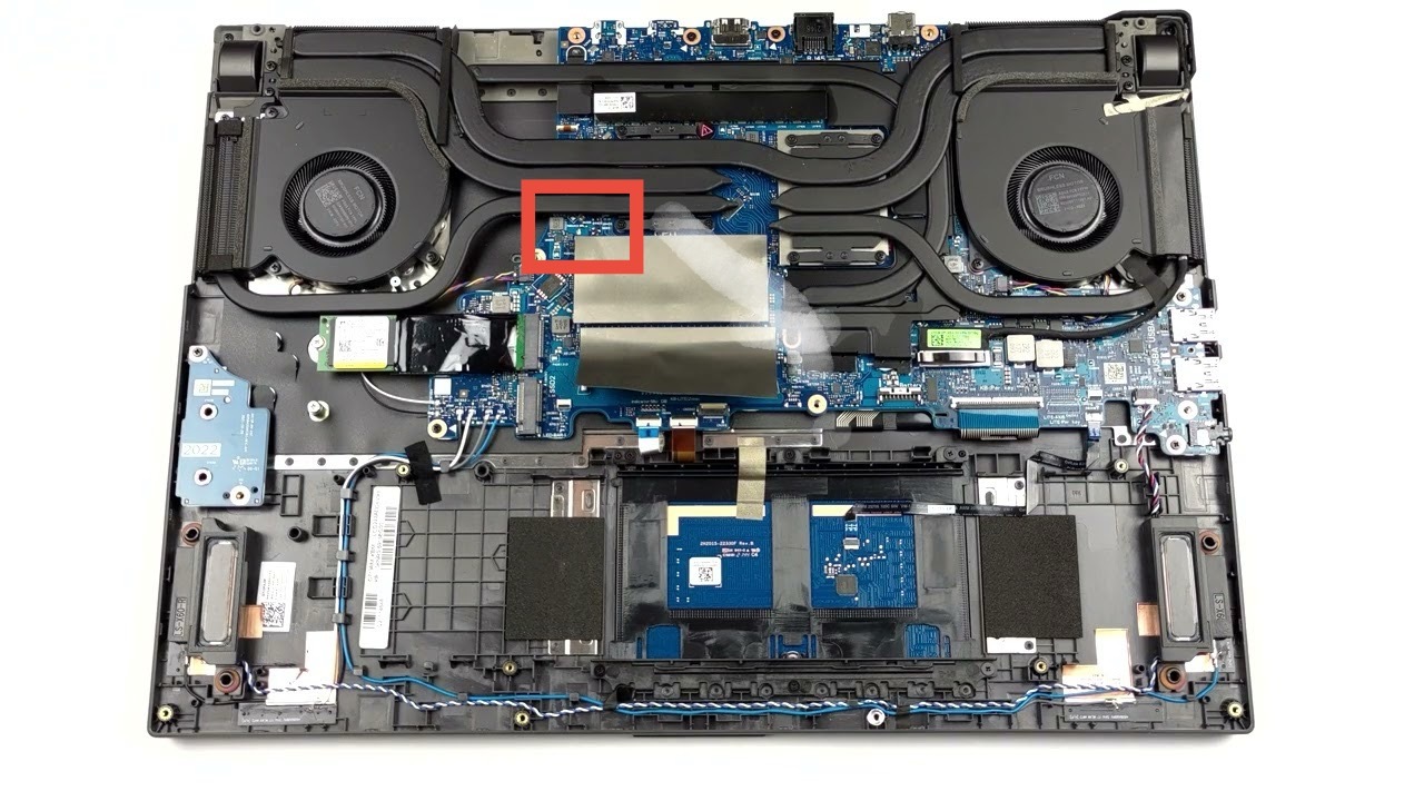

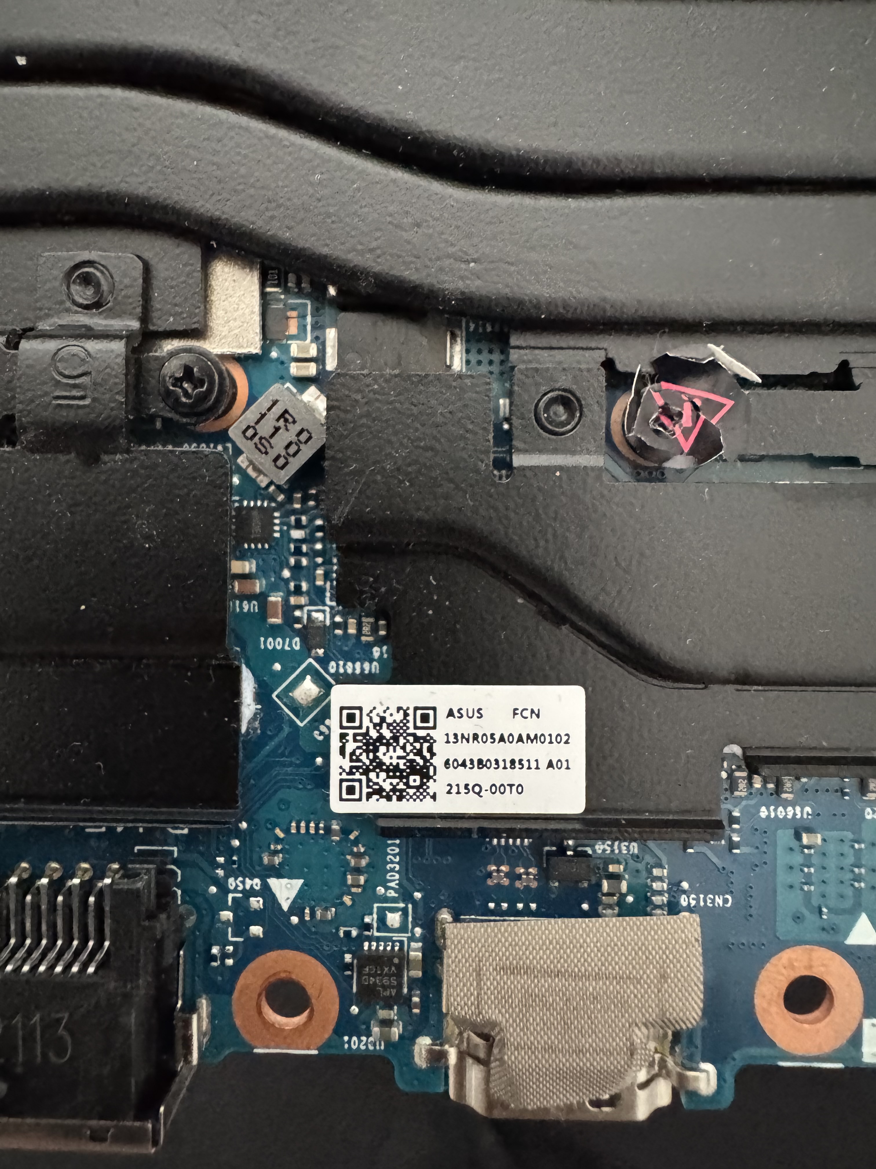

                          Hi, borrowing the thread as I have the same problem, where is the bios chip on that computer? Yours sincerely Thomas
                          • DariusBogo
                            • Apr 2021
                            • 29
                            • Romania
                            The chip is located under the heatsink in the marked area of the attached photo.
                            The second picture should how the chip looks.
