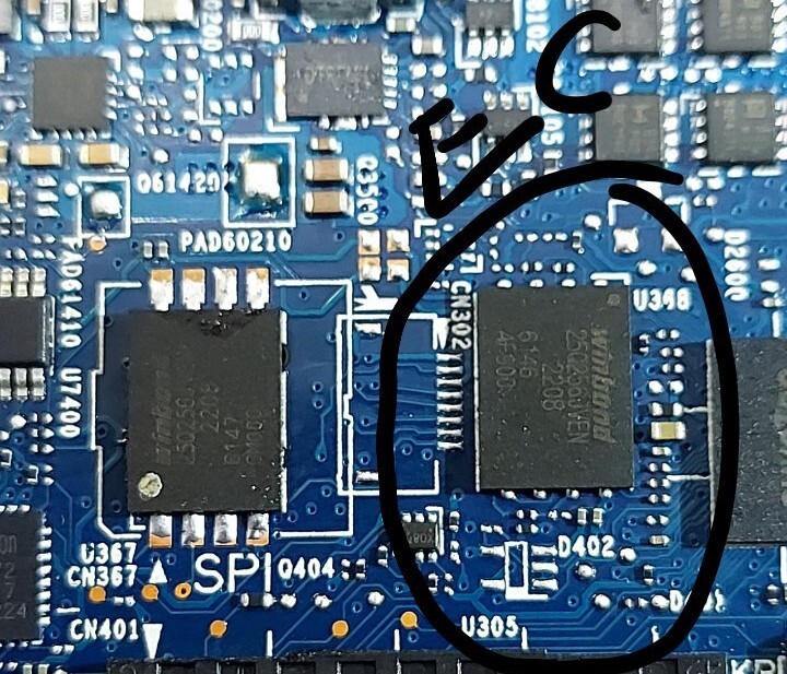

      Hello everyone, I'm asking for help from anyone who can help me. I've performed a dump of my HP x360 11 Fortis G9 computer, with motherboard: ANOLE10-MV-GMB 6050A3332901-MB-A01 2021-11-09. I noticed that it has two identical chips (W25Q256JVE), one on the top of the motherboard and one on the bottom.
      I've performed a dump of both chips (W25Q256JVE), both with the same reference; the top one is marked as BIOS SKT and the bottom one is marked as U351 (screenshots attached).
      I used the RT809HSE programmer to read/dump the chips so I'd have them on hand in case I needed to reflash the BIOS if I had any problems and needed to flash again.
      I read the chip without removing it using a WSON 8X6 pogo pin and a stable, fixed clamp on the board (no reading errors or poor contact). The connection is stable, as shown in one of the screenshots I added. But I have several problems:
      The RT809HSE in automatic detection identifies the chip as: W25Q256FV@WSON8 8X6 instead of W25Q256JVE, and if I manually select: W25Q256JVE, no chip appears in the WINBOND menu, only: W25W256FV@WSON8 8X6, W25W256FV(X4)@WSON8 8X6, W25W256FV@SOIC16, W25W256FV(X4)@SOIC16, W25W256FVC@TFBGA24, W25W256FC(X4)@TFBGA24, W25W256FB@TFBGA24, W25W256FB(X4)@TBGA24, and W25W256FV(ISP).
      I've done 3 readings with:
      W25Q256FV@WSON8 8X6
      W25Q256JVXXQ@WSON8 8X6
      W25Q256JVXXQ(ISP)
      I've done a full analysis comparison in the HxD program and all 3 are different, so my question is, which is the correct reading? Which chip should I choose in the menu? I've lowered the reading speed on the RT809HSE to the minimum, and I've done the same with the U351 chip in the same way as the first one, and the same thing happened to me. The 3 readings/dumps are different. Which one would be the correct one? Am I doing something wrong? Am I selecting the wrong chip type?
      I'm attaching the readings/dumps for the two WINBOND W25Q256FVE chips. I hope you can solve my problem and see what I'm doing wrong.
      Thank you very much in advance.

            Now I have a serious problem and I ask you for help please; as I could not get any readings, I was doing tests in all possible ways both with the CH341a programmer and with the RT809HSE and with a WSON8 clamp cable, I must say that I did not have bad contacts because I use a clamp that holds it well without movements, from so many readings that I have done I have blocked the equipment; I have connected a reading by putting the charger and the led on the board lit up and I think I have done something to the equipment, since the power button led lights up and the Caps Lock key led flashes 5 times and there is no image, it stays on a black screen and the equipment does not start; it doesn't turn on and before doing the readings it did turn on, I simply wanted to make a copy of the bios reading and now I've messed it up, please can you help me see what I can do? I've given you all the device data and I've read the bios again with the CH341a and it gives me a file identical to the one I had read before it crashed, to all this with the CH341a I have done the reading always isolating pin8 VCC to not supply voltage to the board and both before it crashed and now that I have read it again it gives me the same file, so I understand that I have not damaged the chip but now it won't turn on, and I don't dare flash anything with any programmer because as always they gave me different readings, I'm afraid of making it worse and doing more damage, please I ask for urgent help, please !!, I add all the readings that I have been able to do to see if you can solve my problem,
            thank you.

              All readings made with the CH341A are identical and look good to me. The others made with the RT809 are all bad. So what`s the problem , no boot ,black screen , password, running slow ?

                  The CH341A backups seem good, all data intact. I don`t know if you`ve corrupted the chip or not but you can try flashing back one of those backups. You could have dislodged a resistor around the bios chip so check around it carefully. With the CH341A the chip has to be erased before programming.

                    I looked at the board with a magnifying glass and none of the resistors around the chip were damaged. I also didn't remove the chip because I don't have the air conditioning station yet. That's why I took the readings with the chip on the board. However, the RT809HSE never gave me the same reading when comparing data in HxD, which is what surprised me. The RT809HSE is supposed to be better than the "CH341a," but the most likely scenario would be for the chip to be damaged because I've applied voltage to the board with the power supply and voltage with the RT809HSE programmer. However, could you clarify some questions for me? Is the RT809HSE not suitable for taking readings with the chip on the board, not even in (ISP) mode, which is its own mode? Do I have to remove the chip because it could interfere with the other identical chip (W25Q256JVE) underneath it, which shares the BIOS with the main one? (I attached screenshots of everything in #post3).
                    What I'm going to do while you reply is something else;
                    I'm going to redo some readings of the two chips with the "CH341a" and without voltage (with an isolated 8 VDC) and I'll upload them here for you to review and compare. You're the professionals, and maybe I'm doing something wrong...
                    Let's see if we can get something clearer this way...
                    Thank you very much, I'll upload the files soon...

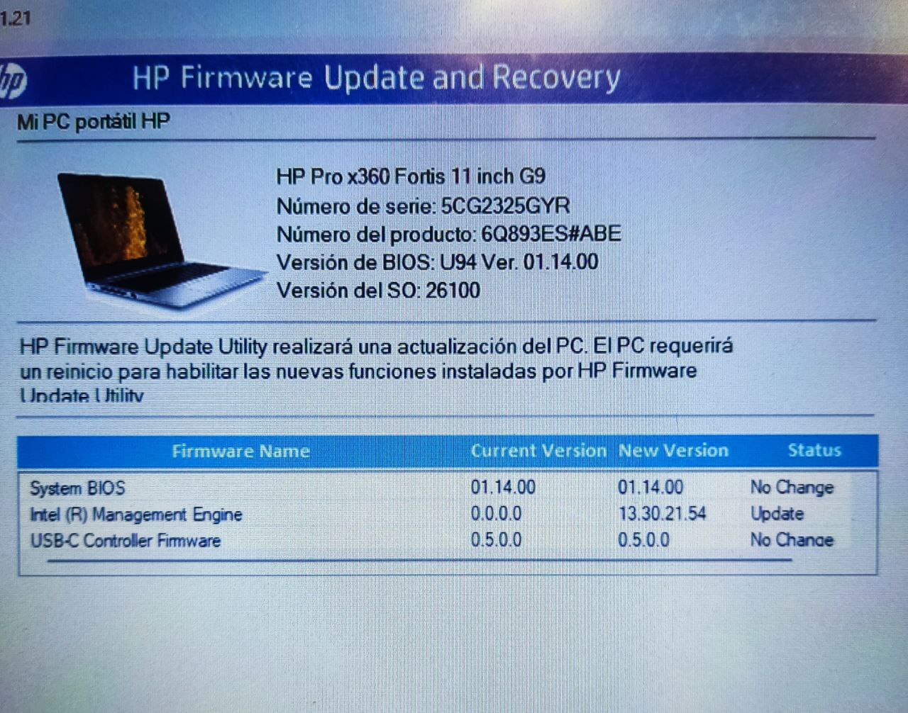

                          Well, I managed to get the computer to boot with the attached file, but it takes a very long time for the BIOS to boot, and it takes a very long time until Windows appears. There's a problem with the BIOS, because I tried updating the BIOS downloaded from the HP website once in Windows, and I got a firmware update error message: "Update of the Intel management engine firmware failed, because the target Intel management engine firmware update was found to be invalid." (screenshots attached).
                          Am I missing something in the file I flashed?
                          In that case, is there anything I can do with all the files I've uploaded in previous posts? Maybe you can see if the firmware I'm telling you is missing is there and add it to this latest file, which at least "takes a while," but boots the computer?
                          Come on, we're almost there. I'm sure you know the solution. Please, help me out and see if we can fix it...
                          Thanks...

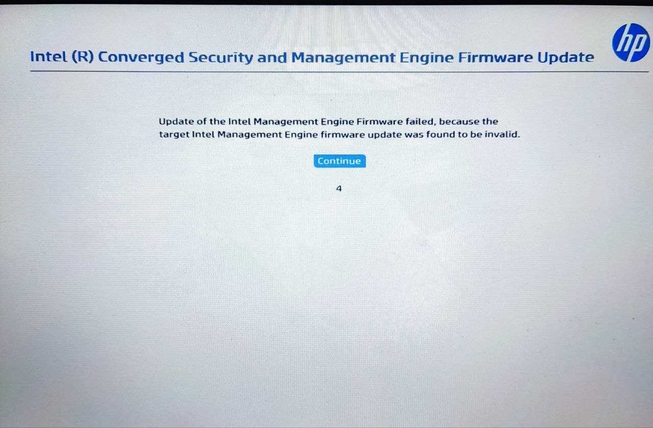

                                Thank you so much for your help, your time, and for helping me, SMDflea. I really appreciate it. I know I still have a lot to learn and test, and I'm working on it, but I still have a long way to go, so thank you all.
                                One thing: thanks for the file you offered me, but before testing it, I wanted to tell you:
                                With so many tests, I think I've also corrupted the other lower chip (the one similar to the SKT BIOS -> W25Q256JVEN), and I don't know if I should flash it and set everything to 00 or FF, or if I should flash some file on it. I'm also not sure if they both work together at the same time communicating with each other when I boot, or if it's just that when I boot for the first time, only the main SKT BIOS works, and then it writes information to the lower one... The fact is, right now I'm sure I have it wrong. I've also done some readings on it, but I don't know if they're good. The thing is, I don't know the structure it should have. The official softpaq for this official BIOS model from HP, when unzipping it leaves 2 . bin that I mentioned in another previous post (U94_01140000 of (31.3 Mb) and U98_01140000 of (31.4 Mb), which makes me think that maybe one file is saved in the main SKT and another in the lower secondary chip...
                                I also tried (just to test) through the softpaq to do the option to update the bios via USB (when running HpFirmwareUpdRec, it only gives 2 options: "Update on Windows restart and USB Recovery"), on Windows restart I kept getting the ME Region firmware error, and via USB it didn't even read it, but the structure that it set up on the USB was several folders: "HP\DEFW\Firmware" and this file called firmware is 62.8Mb, meaning it must contain information that is saved on both chips because the maximum size is 32Mb on each chip, which It makes me wonder if both chips can work at the same time or if they must contain some joint information in order to boot properly. Do I make myself clear? I hope so....
                                I also have to confirm that after multiple tests, reading the chips on the board can only be done with the "CH341a" and isolating pin 8 from VCC, but from what I've been observing, sometimes and depending on the file to be flashed, the verification fails. That's why there must be something on the board that can interfere with the reading, writing, or verification (it took me a lot of work and many writing tests to get the computer to boot again). And without isolating pin 8, the board turns on when supplying 3.3 volts and the reading is false or incorrect. The RT809H has been ruled out because it doesn't read correctly and the board also powers up.
                                The ideal, I know, is to extract the chips from the motherboard and do everything directly on the programmer, but I won't have one for about a month, which leads me to I'm not sure if the lower chip can be removed because it barely has any pins. I hope you can confirm if it's possible to remove and read it.
                                But since I was able to do something with the "CH341a" and since I already have corrupted chips... having said all that:
                                Could you tell me what I should do? Should I leave the second chip empty with zeros or FF and try with your file? Should I still try with your file regardless of the state of the other chip? Or should we look at the structure of the file created in USB Recovery and see if the information can be extracted from both chips? In that case, I don't know how to do it...
                                While I wait for a response, I'll send the file generated in USB Recovery just in case you need it for further investigation...
                                Thanks!

                                  Well, while I waited for news, I ran more tests and nothing. Thanks for the SMDflea file, but it didn't work. With that file, when I plugged in the computer, the motherboard's LED flashes yellow continuously, but it doesn't boot...
                                  Now that I'm done, I've run every test I can. erasing the other chip, leaving it empty, and nothing, the computer does not start, I have noticed that every time I flash any file, the verification always gives me an error, so I do not know what it can be, if some kind of protection or if the two chips are intercommunicated and while you erase one the other is erased and if this is the case it is normal that it never starts, but what is certain is that there is something between them, at the moment I do not know what else to try, in fact I have flashed again with the files that did start the computer and again it did not turn on, I do not know what happens but it is something very strange, when it coincides in some way it seems that it can boot but with the usual ME region problem, but for it to start it is a matter of finding the way or coincidence so that it can turn on without being blocked; It's crazy. I think the only way is to have the files for each chip, extract them, flash them off the board, and then check again on the board, because I don't think there's any way to get this device working... a shame.
                                  Thanks anyway for your attention and help...​
