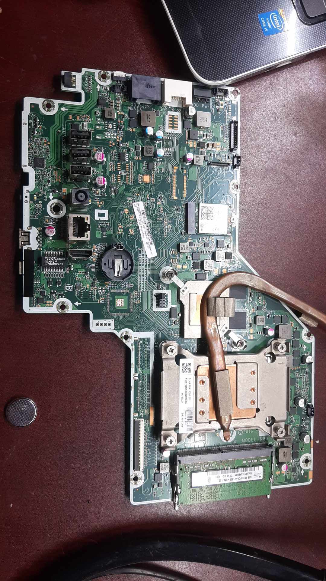

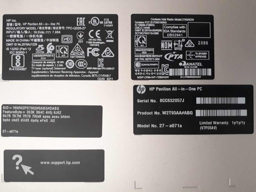

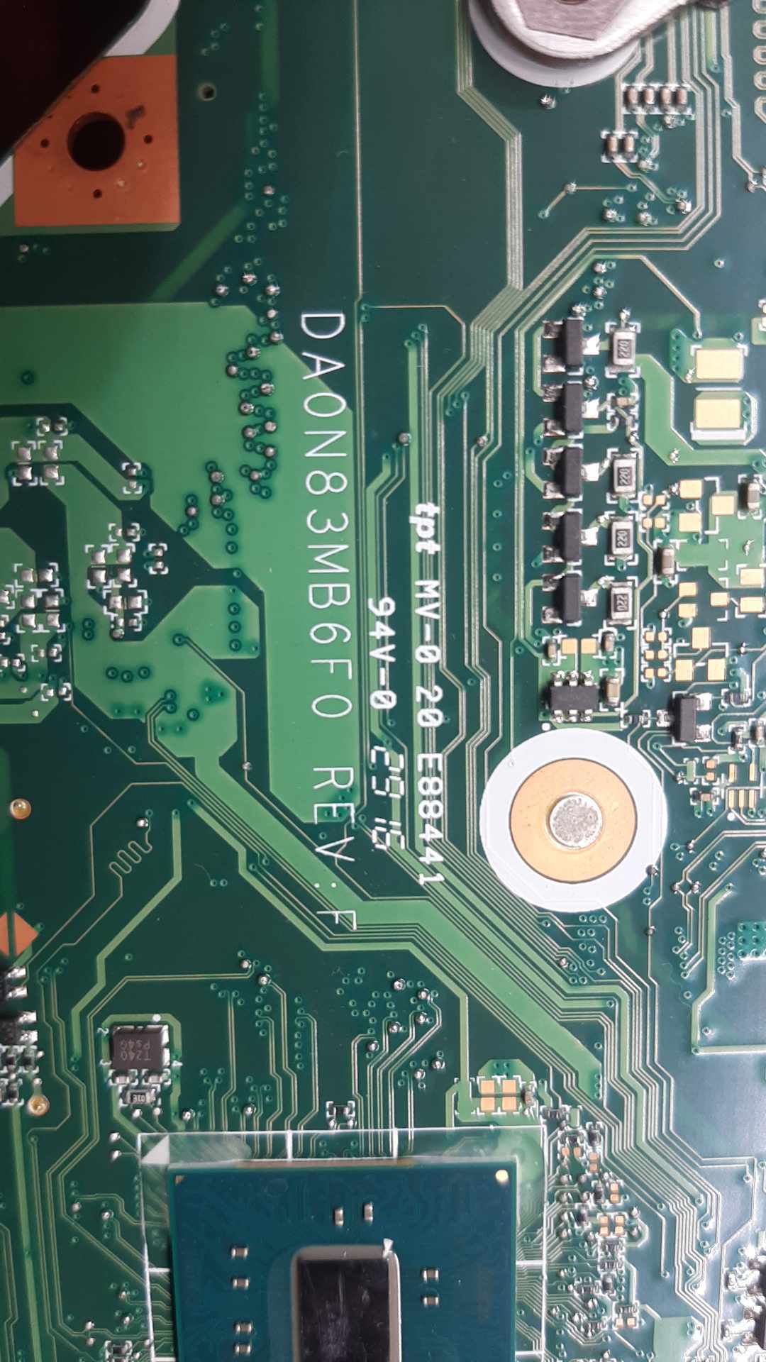

    i have AIO HP
    The problem appeared suddenly with very slow booting and Windows tried a new disk, new RAM and a new processor, but the problem was not solved and there are no traces of moisture on the board.
    plz claer ME for me

    Originally posted by mhle101
    i reupload the fiels
    the messages
    1-me fw update failed please try again
    2-error sending end of post message to me heci disabled proceeding with boot
    Try this virgn bios
      the messages

          May God bless you and your knowledge
          I was able to save my computer from slowing down again
          I loaded a new BIOS with the serial number, and, and, retrieved
          Thank you​
