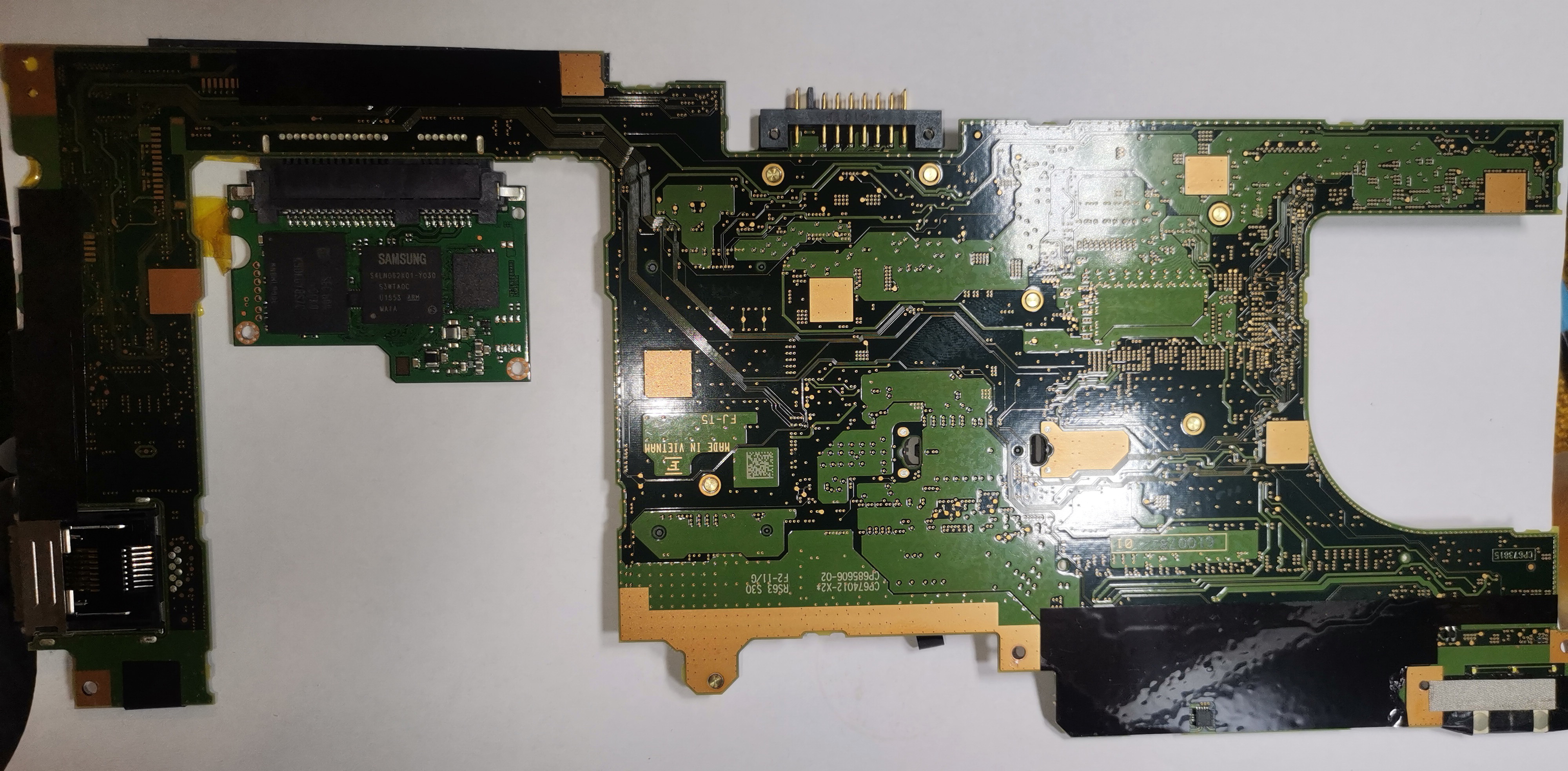

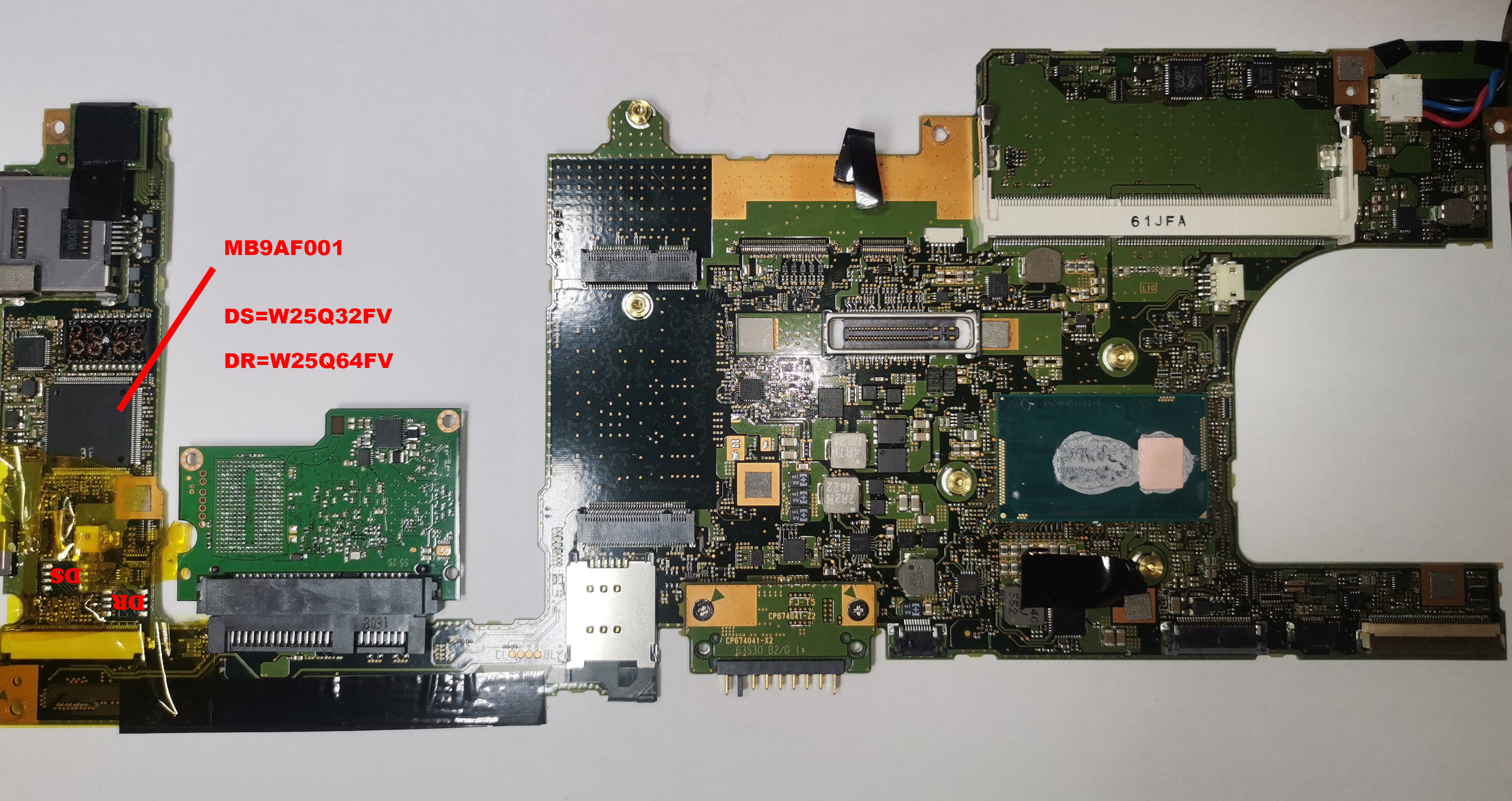

    Please help with bin for programmer.
    all 3 leds are blinking but no image
    I read DR=W25Q64FV 8MB and DS=W25Q32FV 4MB and I attach them here​
    Near to this chips its MB9AF001
    Board Mark
    WHITE MARK

    Board Photo

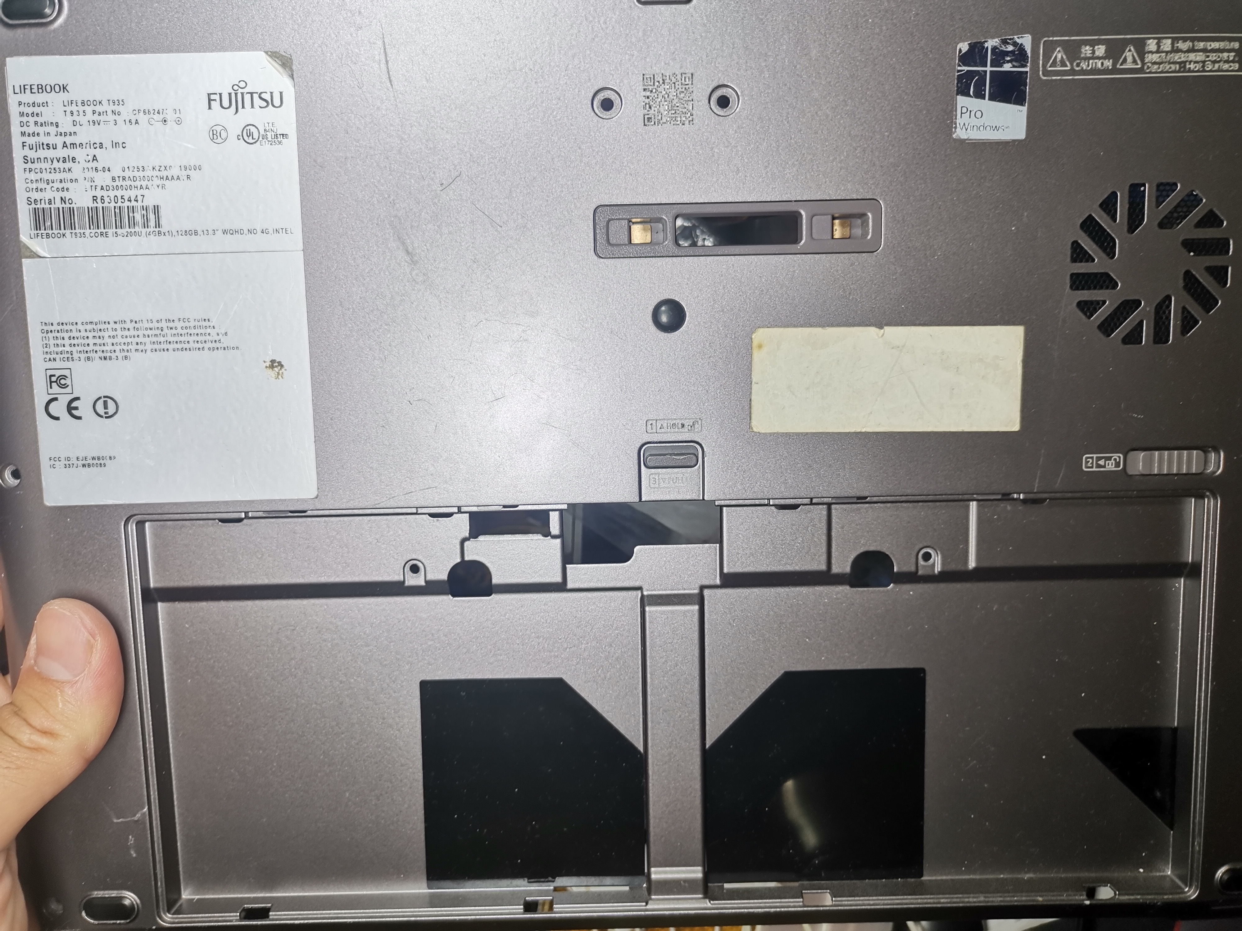

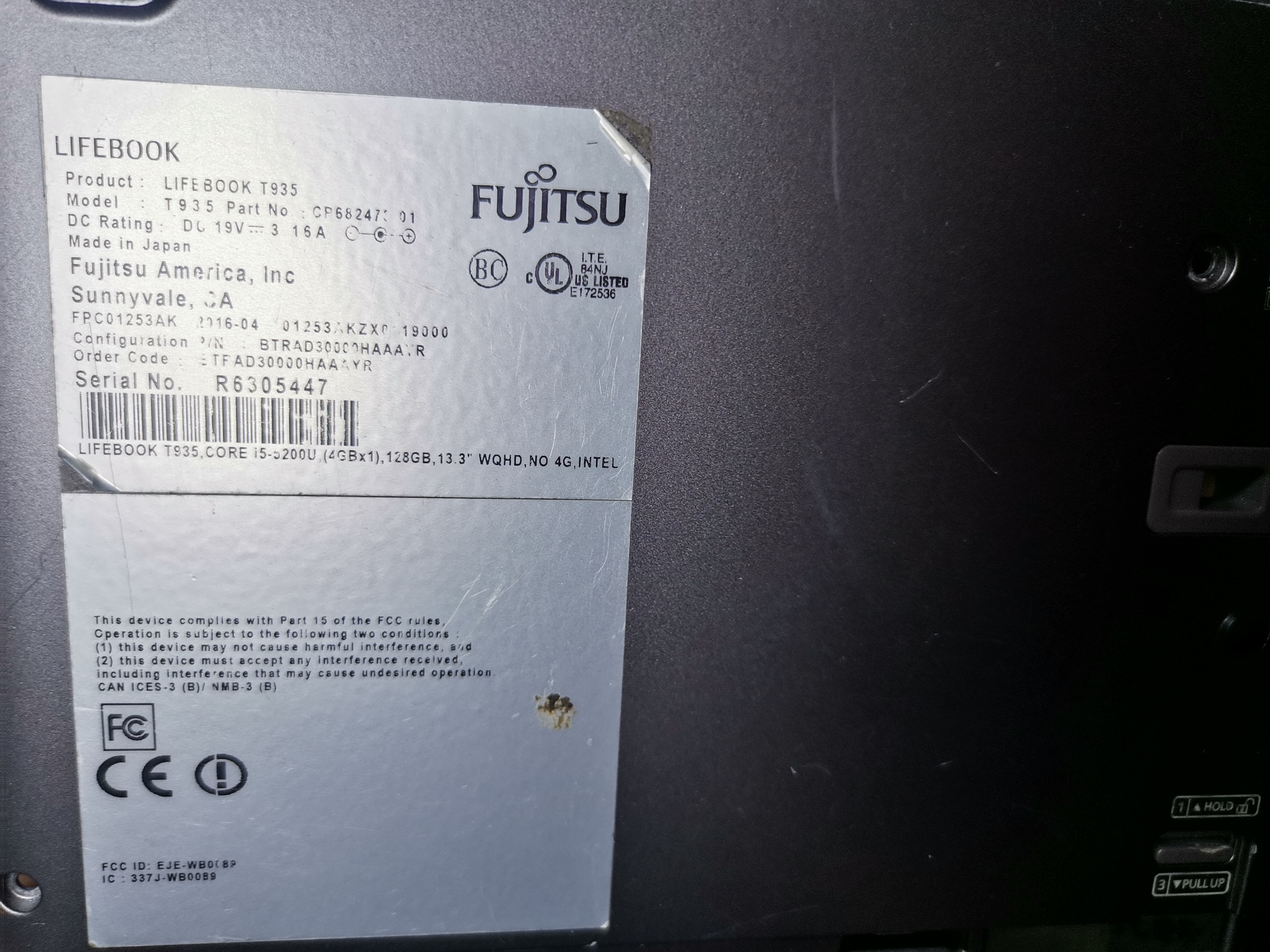

        Serial No. R6305447
        Attached pictures with serial no. and dead bios of W25Q64FV and W25Q32FV chips

          Send to you !!
