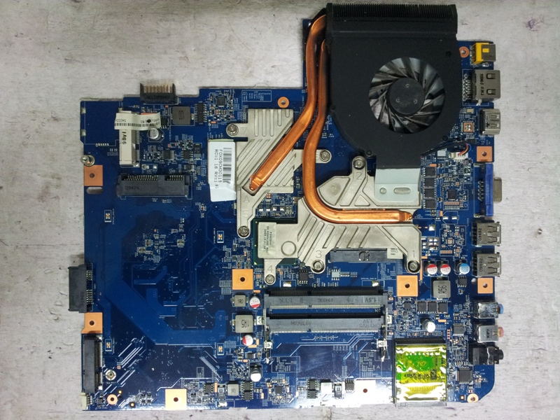

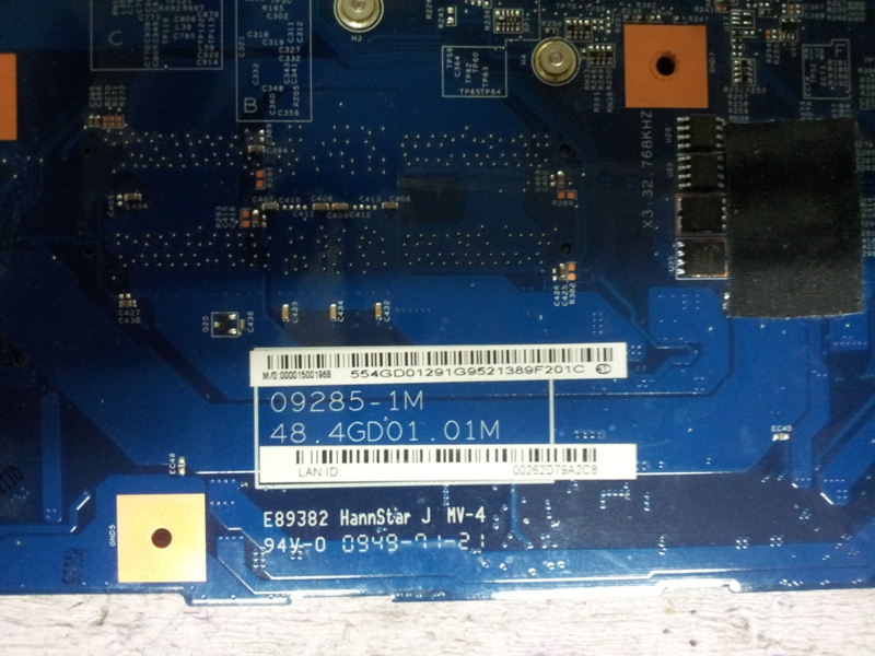

    Ineed file bios (U56) and EC flash (U16)
    Aspire 5740/5340 series
    Model: MS2286
    I enclose photos
    Thanks to all

    Re: Acer Aspire 5740G i need Bios and EC Flash
    Available on acer site.
        How can I do the EC Flash?
          Desolder the u16 and then use a universal programer like tl866 to read the old data and save it just in case! After that you can use the NEW data and try!
            Or you can flash the file to the chip by flashing it from the BIOS.
                thanks bro. its worked.
