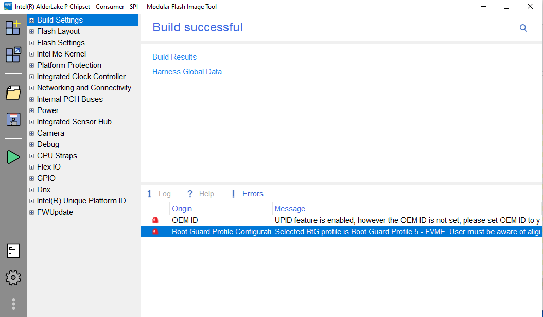

Yoga 9 14IRP8 - Type 83B1 Needs cleaning, thanks.
  • EthanMai
    • Jul 2020
    • 103
    • 美国
    SN: PF4DAD25
    NM-F201

    what means "cleaning"? clean ME Region?

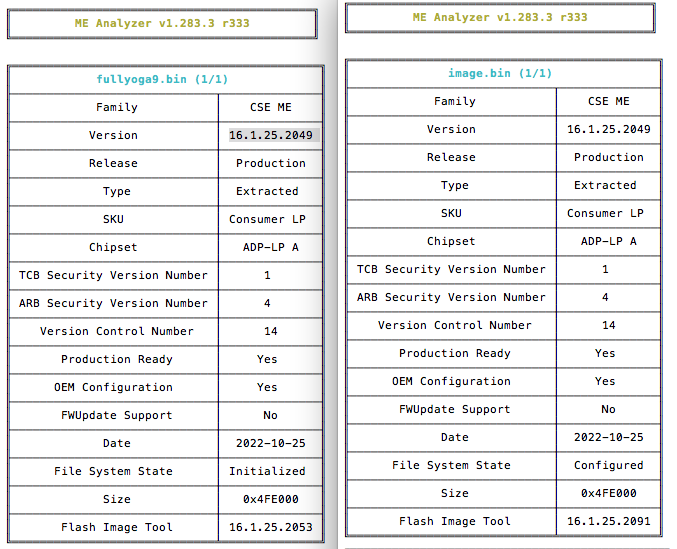

      Yes please help me

        Originally posted by EthanMai
        Yes please help me
        yep, here it is. write both files. Maybe pics will help you to get where you did wrong.

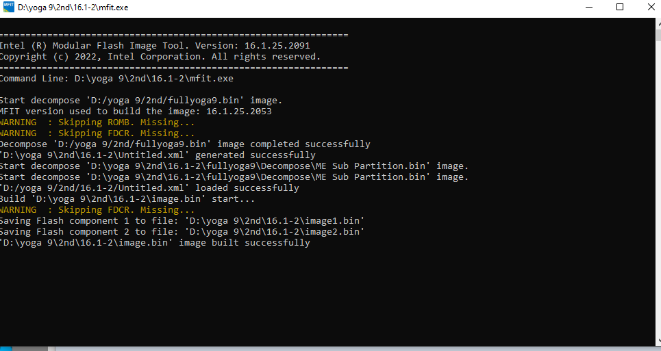

          Yes please help me
          and the pics ...

            Teacher, please give me some guidance...
            I tried 5-FVME, but the build still failed... I don't know why...
              did you merge both bios files? Main and EC?
                  I got it, thanks for your help. Have a nice weekend.
