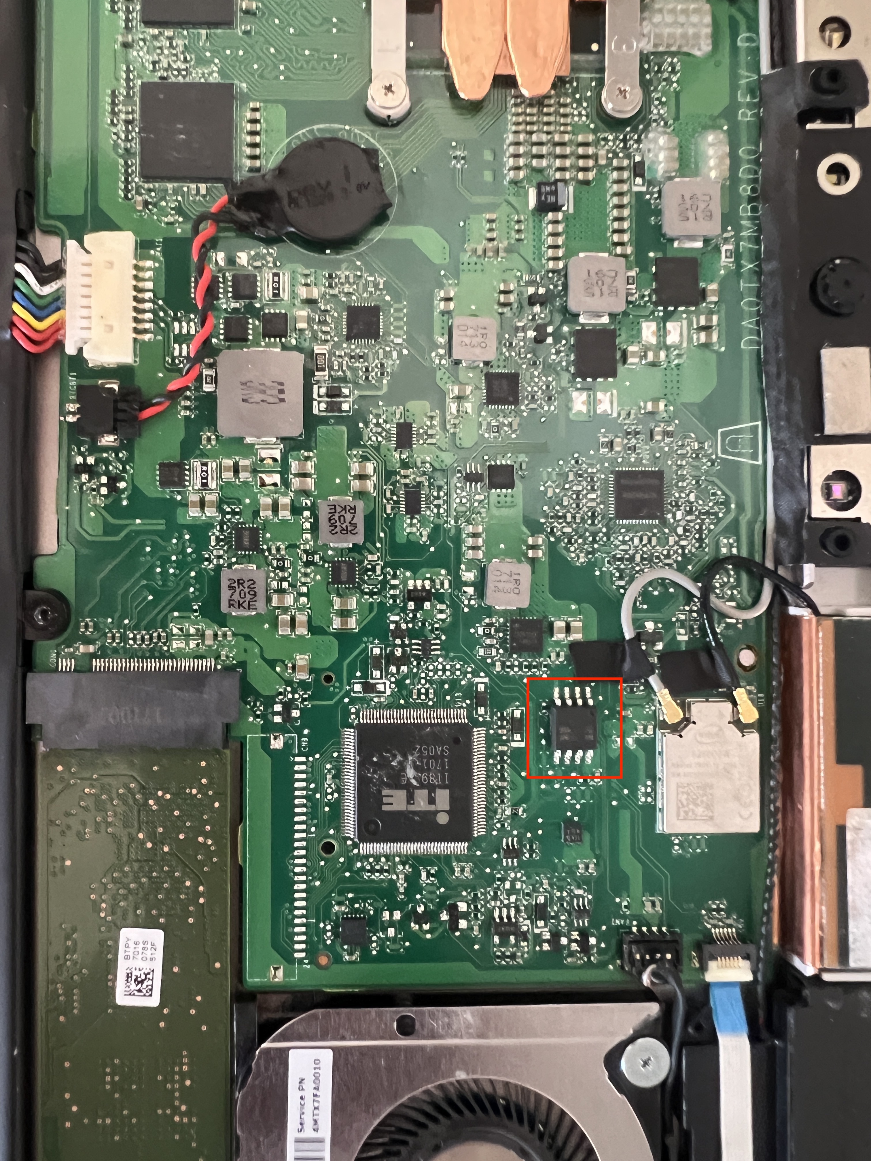

            I successfully removed the touchscreen from the Porsche Design Book and can finally see the motherboard. I just don't know which of the chips is the BIOS chip. Can you help me?"​
              what's the marking of the chipset in red square? Click image for larger version
              • ultravarialheadspin
                • May 2020
                • 47
                • Česko
                Windbond 25q128fvsg 1626
                need fresh bios file, for re-program this one corupted after update fail
                  • 20840
                  Make a backup and post it,even if it is corrupt.There could be some data that can still be retreived from it such as the DMI .

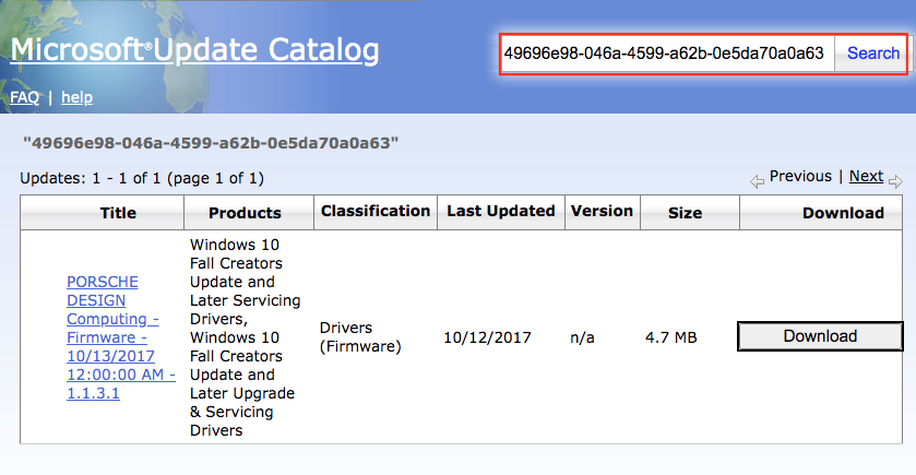

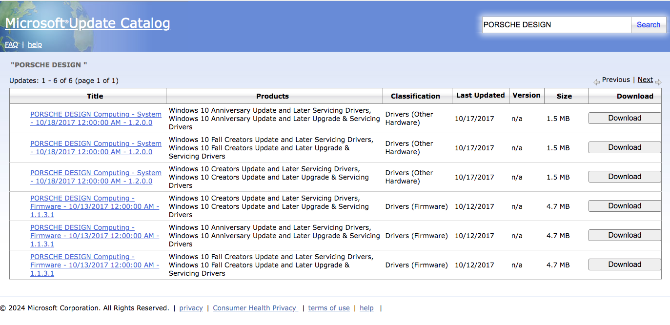

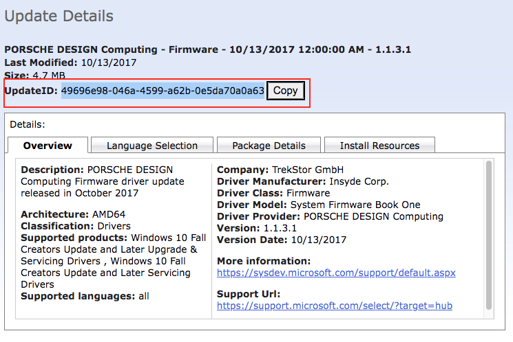

                          Click image for larger version  Name:	Screen Shot 2024-07-19 at 03.36.31.png Views:	0 Size:	262.3 KB ID:	3311911
                          using 3 different programs for reading from chip
                          try bios in attachement.
                          For this kind of sh*tty laptops I advice to use microsoft update catalog to find bios update package, see photos. Click image for larger version  Name:	Screen Shot 2024-07-19 at 03.30.44.png Views:	0 Size:	118.9 KB ID:	3311908 Click image for larger version  Name:	Screen Shot 2024-07-19 at 03.31.06.png Views:	0 Size:	99.8 KB ID:	3311909
