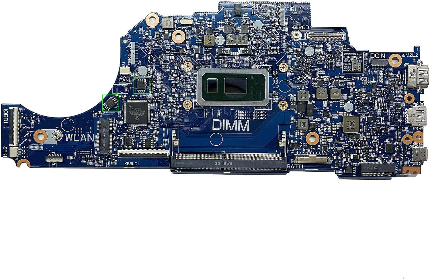

    hello i was hoping to get some help on this laptop.
    bios has password.
    service tag d9kz103-0001.
    I have tried a bios generator and i get master password is not supported.
    bios has password.
    read both bios chipsets and post backups here.

      ok here is the backup
        upload the 8mb chip.

          ok both files uploaded.
            try. I don't know where DMI is, maybe someone will help you to transfer it. Write both chipsets.

                Hi the file worked thank you for taking the time.
                i have one more laptop with the same problem the ST is F7KZ103-0001
                  use same files as previous. Is a clean ME image and Bios Region was replaced with one from bios update.
