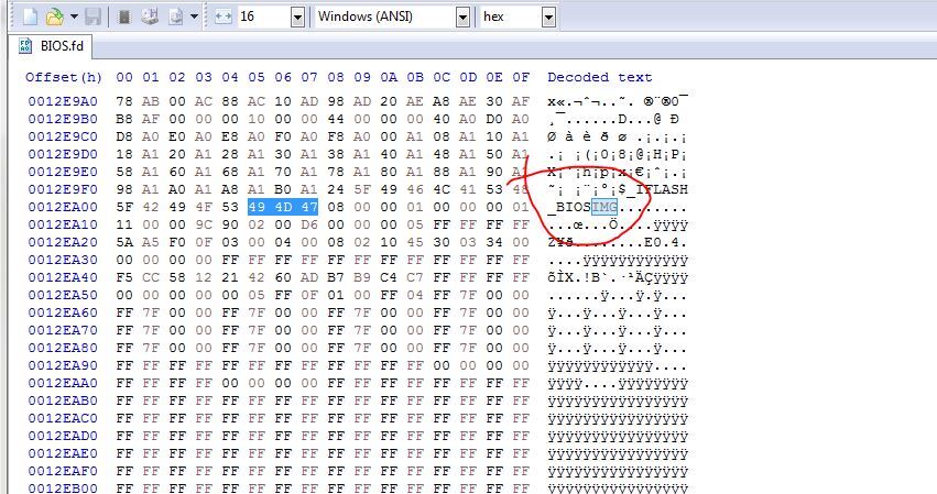

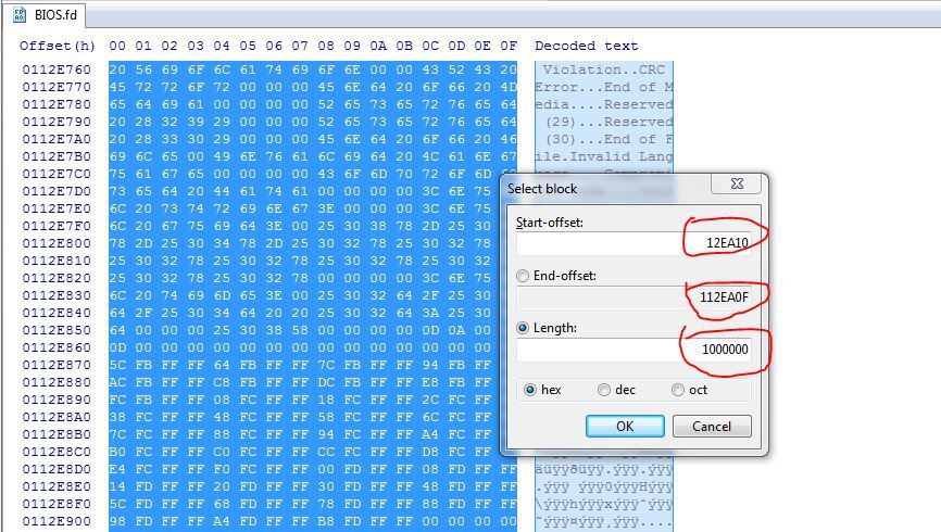

I downloaded a BIOS file from Lenovo and once I extracted the actual BIOS from the executable, it is 16MB in size, but my IC(Winbond 25Q80DV) is only 8MB in capacity. I have read you can trim the BIOS file with a hex editor but I can't find any instructions on specifically what you will remove.
How do you trim a BIOS file?

The file needs editing with a hex editor to get the 16MB bios imageAttached Filesif you find these attachements useful please consider making a small donation to the site
