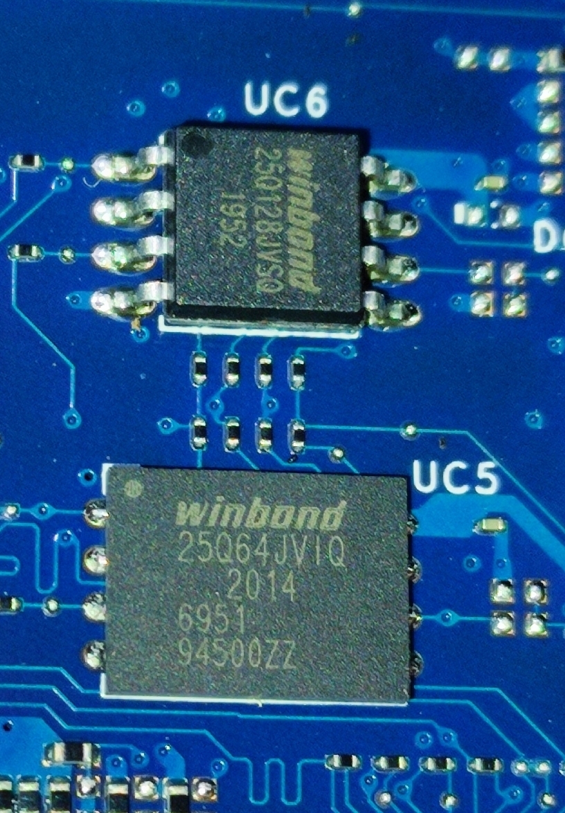

    flash both.
    1st boot, press F2, write service tag, disable Absolute, save (Apply changes), restart. 2nd boot press Alt+F to exit manufacturing mode.

      Thank you very much for answering, I have a question, when I removed the password I only programmed the uc5, now the uc6 must also be programmed? uc5 should use 8mb bin and Will uc6 use the 16mb bin?

        backup first the 16mb and program using my bios

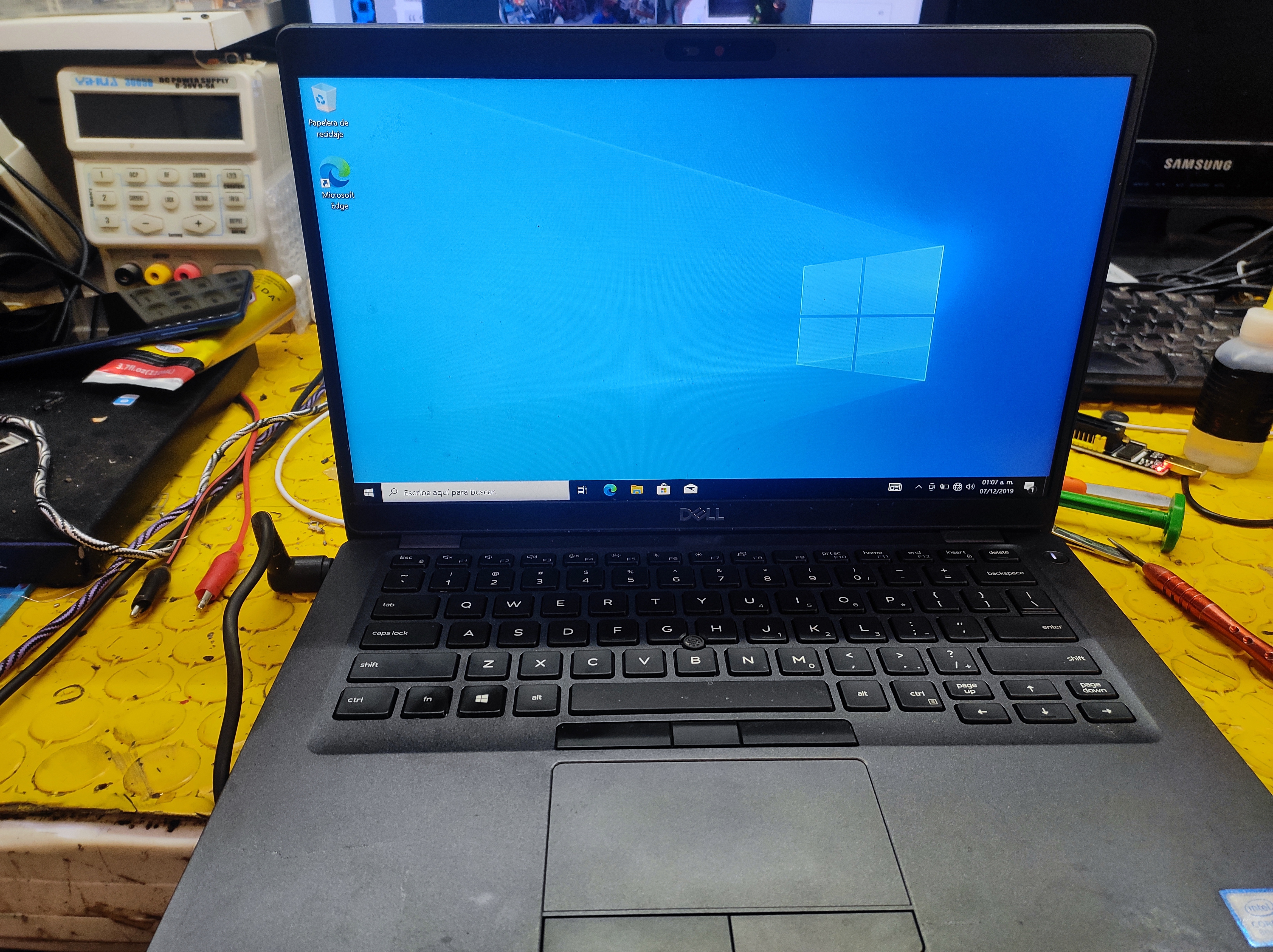

          Thank you very much, it worked perfectly now I have clean access to Windows

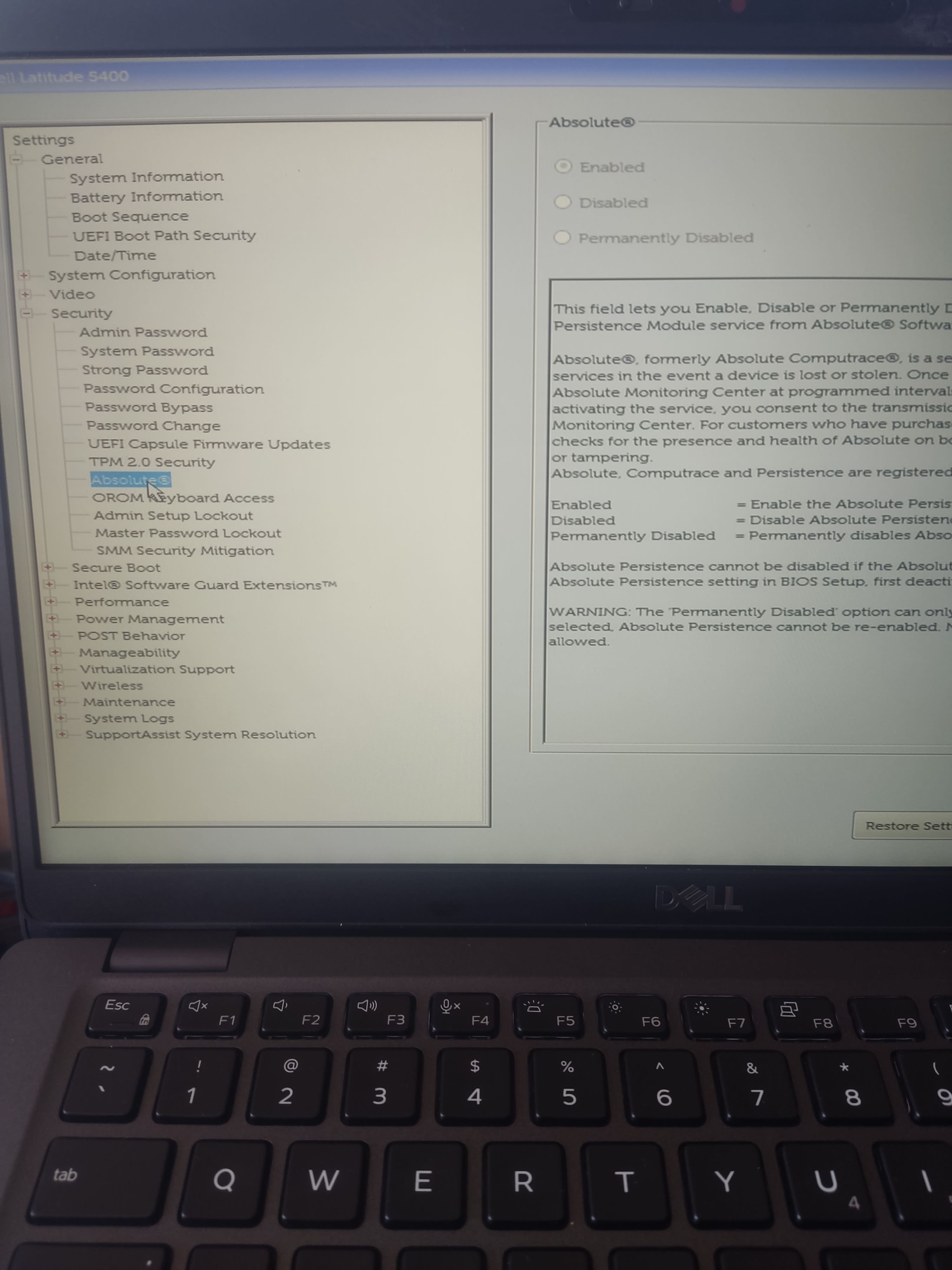

                BIOS unlocked but Absolute is enabled and inactive

                  Your bios version is : 1.9.1
                  Try now and give feedback
                  • Doktorall
                    • Nov 2023
                    • 9
                    • Украина
                    Thank you very much, now it is possible to disable it, everything works

                          Latitude 5400

                                Sorry for the late reply, since I wasn't able to finish my repair until now, thanks for the support but unfortunately even after disabling permanently Absolute in Bios, but the DeviceFreeze-2880 window still keeps popping every windows launch
