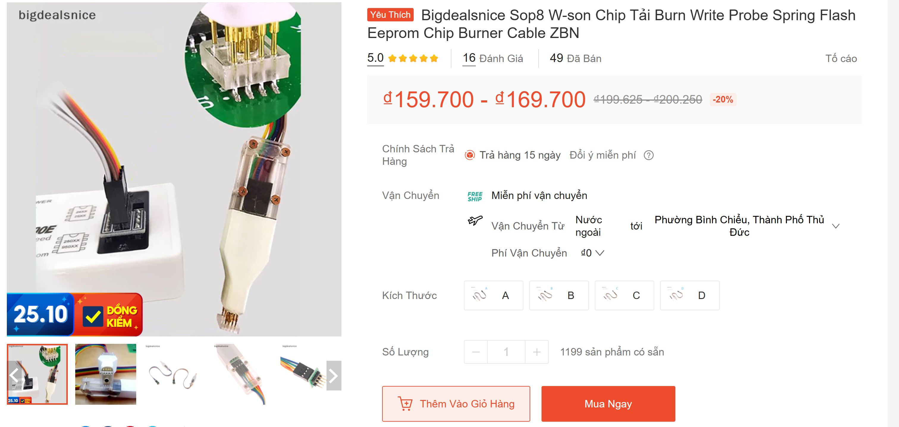

                            Hi, sorry for asking. How did u manage to connect ur bios chip to the flasher? Is it by desoldering or is there any possible way to do it without desoldering? Sorry for the dumb question.
                            • hoaca388
                              Badcaps
                              • Jan 2022
                              • 12330
                              Clamp does not work well with CH341A.
                              https://shopee.vn/Bigdealsnice-Sop8-...8-81cfc5bcf608
