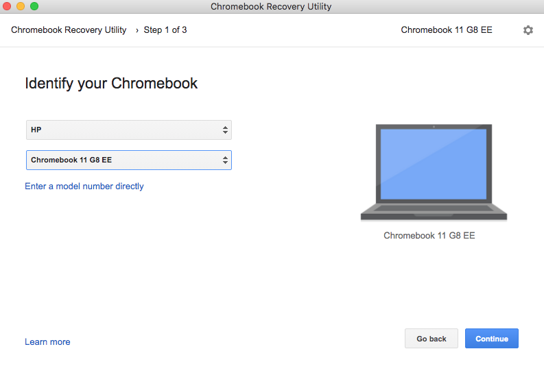

        write this .bin and after that reinstall using USB stick made with Chromebook Recovery Utility for your model. HP Chromebook 11 G8 EE

                          Hello, Have a nice day to everybody, i have an HP Chromebook 11 G8 EE enterprice Locked, can you help me to unlock it?
                          Serial Number: 5CD104Q5V9
                          • lint4u
                            • Nov 2013
                            • 125
                            • lint4u
                            Try this one and reinstall with usb stick
                            • j0r6389
                              • Sep 2021
                              • 5
                              • Honduras
                              Working. you are great, have a nice day.
