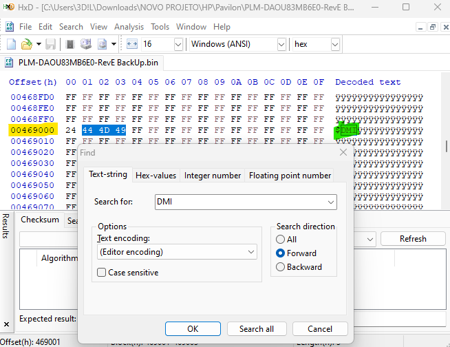

                      A comment that is appropriate, this should not happen, true Click image for larger version
Name:	find DMI lol.png
                      On this day I set out to find the problem in this very particular case, I have the feeling that it was previously manipulated and deliberately left like that, only curiosity takes us to such unexpected place, because the acronym (DMI) and this appeared, now following my intuition I am going to place the DMI in this place and I will tell you what happened later

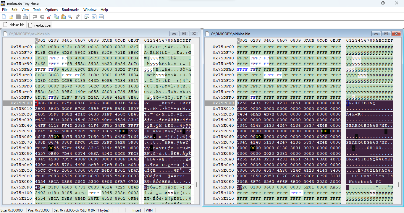

                          I want to thank SMDFlea for leading me to the right path to succeed in recovering this notebook, I will describe the method I used below, using virgin bios provided by the hero SMDFlea (02161.bin) rename the file to newbios.bin I also took the backup I made of the original bios and renown as oldbios.bin I placed these two in a tent with the name C: \DMICOPY; with the Tinyhexer program I opened the two files (first I chose newbios.bin and then oldbios.bin in this order) with them loaded in tinyhexer I went to the tools tab first option compare and then third option compare (then tiny starts to do his thing it takes less than a minute, at the end of the process I dedicated myself to generate a macro immediately going again to the tools tab and almost at the end there is Macro>Record Script ( Well, this step is important, Here you take one of the side scroll bars you step on it with the mauses keeping the mause clip, swipe down ^not scrutinizing^ as if you were going down in a document that you are reading a part that interests you, I did it throughout the document and went very carefully through the directions that were indicated to me when I finished I went again to toolsmacro stop script, He's going to ask you to keep it with a name you put the one you want
                          In my particular case I examined with the tinyhexer the two files side by side and I could see many discrepancies but if you are an avid reader you will see as a pattern how the information is separated mostly in oldbios.bin I perceived that the DMI in my case had other information and I copied the block from 0x75d000>0x75f000 but I also got a text that I found relevant in 0x75c000>0x75c060 which I also copied newbios.bin well with that in mind I went to the Tinyhex tabs save as (don't forget to set the file extension as .bin in my case splitm100brX2.bin
                          I updated the TSOP8 again with this new information and don't despair the first time it turns on it maps the board so you'll see a brogress flashing bootlock bar
                          After that I had to hit the power button three times because it didn't start until it did I'm happy with the work I did and the honors go to SMDFlea thank you for your patience and wisdom that multiplies by 1000 in profits and health, thank you very much, I close the case
