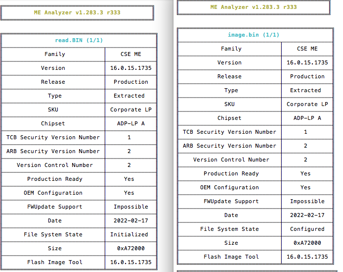

    hello friends,
    i have a samsung laptop that restarts in windows with no reason (almost every 5 min)
    i wanted to flash the bios but there is nowhere to download the update file (apparently samsung doesnt provide bios update for users)
    i wanted to clear me but its 16.0 version and i couldnt find the proper repository
    please help me if someone can clear my original dump
    samsung laptop
    model: np950qed-kb1us
    s/n: 5lbf9fet701589y
    motherboard:mars2-15_hdi

    clean_ME

      Thank you so much sir
      im sorry for bad thread title and many thanks to vesko356 for editing my mistake
      my dear friend volinakis , in the pictures you attached file system state is configured and thats great
      But there is no image.bin file to download
      One other thing: would you please guide me where can i download 16 version repository and proper tool?

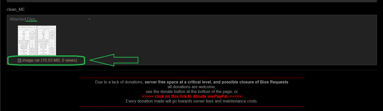

      • Vesko356
        VIP Moderator
        • Aug 2018
        • 4386
        • Bulgaria 🇧🇬
Name:	Screenshot 2024-02-11 at 11-10-45 Samsung Galaxy Book2 Pro 360 np950qed-kb1us Bios request - Badcaps.png

          Vesko356 pointed you to download file. I took ME FW and FIT from winraid forum, you have to dig a little, I saved and made a database with almost all i found there. also, in same cases, you can find ME firmware in drivers for your model. I attached the files used to clean ME for your model.

                thank you so much sir
                problem solved
                no more restarts
                i tried to do it myself with file and tool you attached
                i loaded my read file and choosed the me file you attached and then build the image
                but my result is different with yours in hex editor
                do i miss something?
