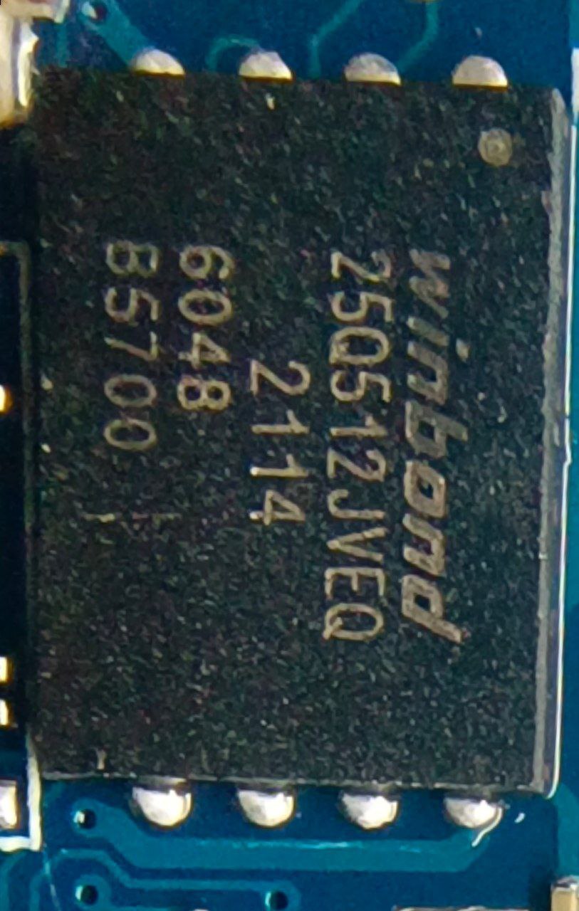

          this bios 64 mb
          • kalilinux25
            • Mar 2018
            • 2093
            • ZAMBOANGA SIBUGAY
            Originally posted by laptchechennai
            this bios 64 mb
            what is the model of your bios chip?
            • laptchechennai
              • Sep 2024
              • 6
              • india
              25Q512JVEQ

                      I think yours is single chip 64mb
                        Motherboard Part No : LA-M402P REV 1.0
                        Dell Latitude 5440
                        ST:CPP9524
                        Still logo only I will try to fixed bud same problem
                        Try this i solved mine with this changing winbond w2r512jven bios chip thyen flash the file i give

                                    Hi guys, i need read chip 512 (64mb) not work rt809f, Any programming that you use that is not so expensive
