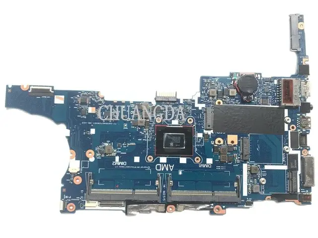

    Hi i need fix bin HP mt43 Mobile Thin Client
    The backlight works without data
    sn-5cg8415yw2
    There is no writing on the rose
    AMD A8-Series PRO A8-9600B - AM960BADY44AB

    What's the problem with visiting the HP support site, entering your serial number to find the exact drivers for your machine, and downloading the latest BIOS update executable?
    Then simply run the downloaded executable and extract the ready-to-program bios to a folder of your choice.​

      Laptop gives a black screen
      Any bin file from the internet does not work with Power

      Laptops failures are not limited to corrupted bios only, in fact most of them are hardware related.
      So if you've indeed tried the official bios, and it didn't give you any positive result there's two options - you didn't program the chip properly, or your problem is not a bios related.

    The problem was solved by uploading the ec file
    I agree with you, but my experience is weak in maintaining the bin service tag. I did not know that AMD does not require maintenance of the service tag like Intel.​
