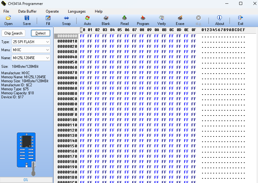

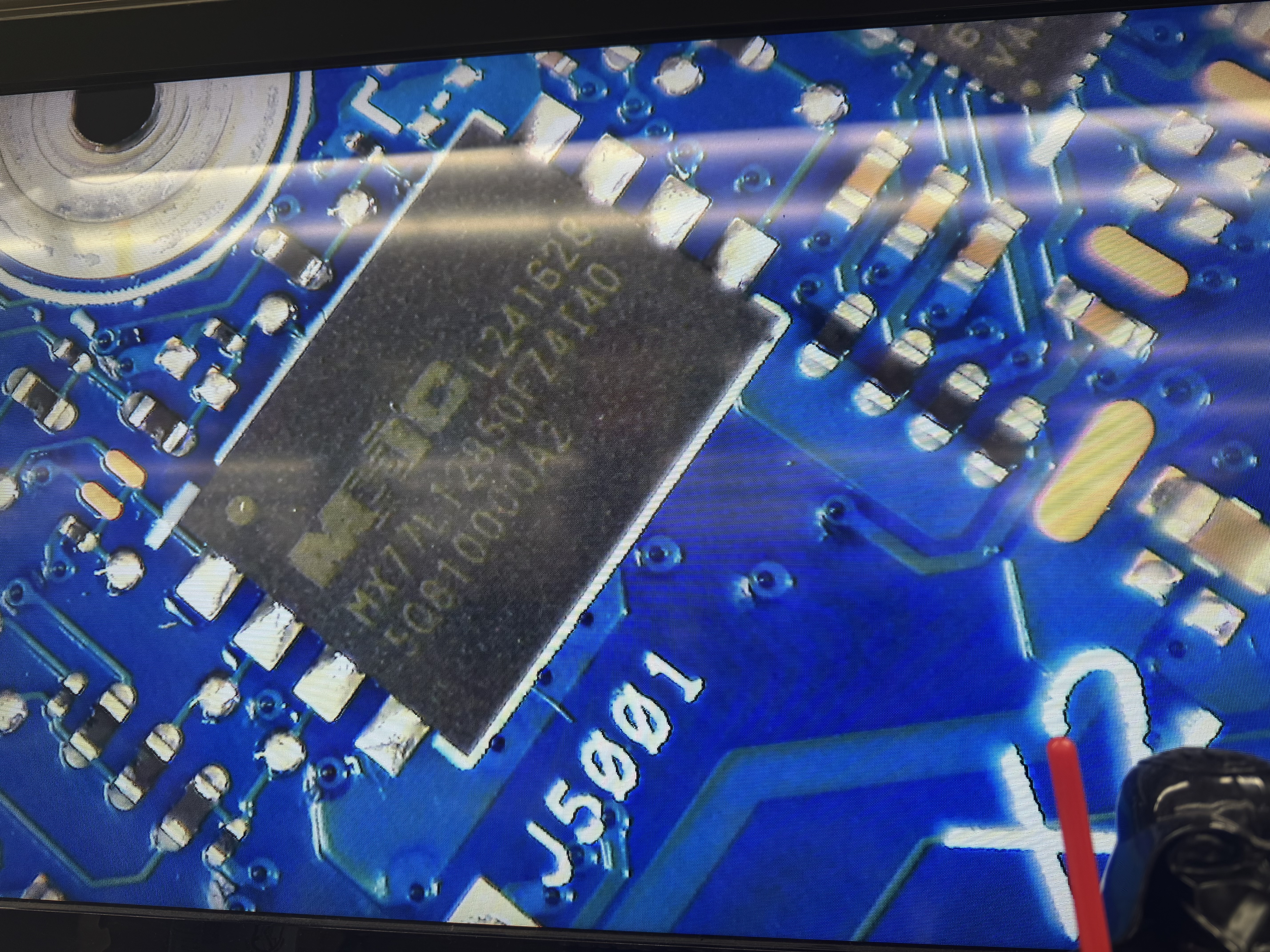

    This is the Bios, I could unsolder it, but I would like to know how to put Properly in the programmer

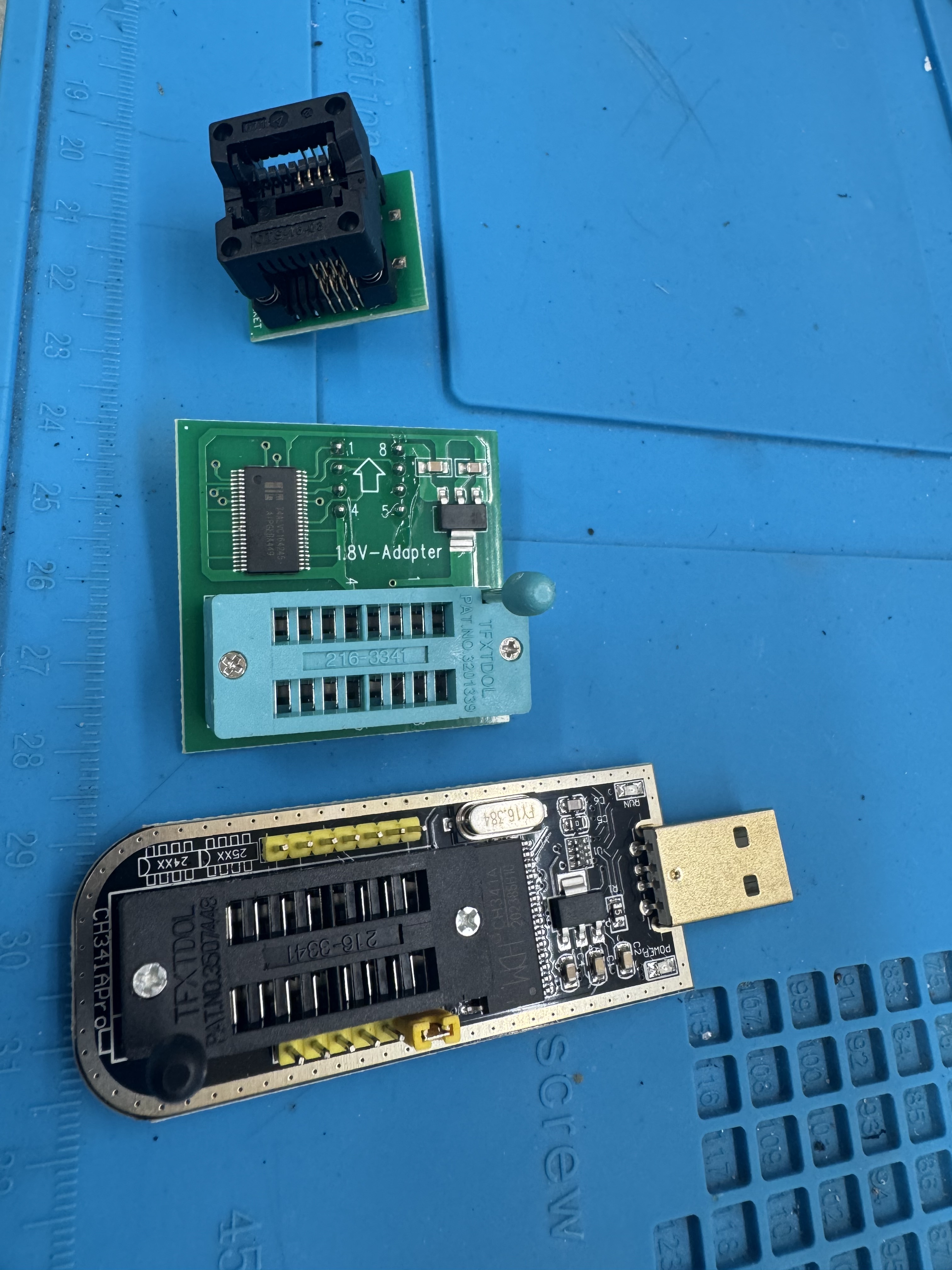

      You can't , you must have a QFN adapter for this type of bios chip
      Ex : https://www.electronicloop.de/QFN8-z...MLF8-zu-DIP8_1

        got it, it works with the QFN8 adapter, but now I need the firmware to reset bios pasword. I could READ and WRITE now im so excited, it was difficult tu config. the correcto position.

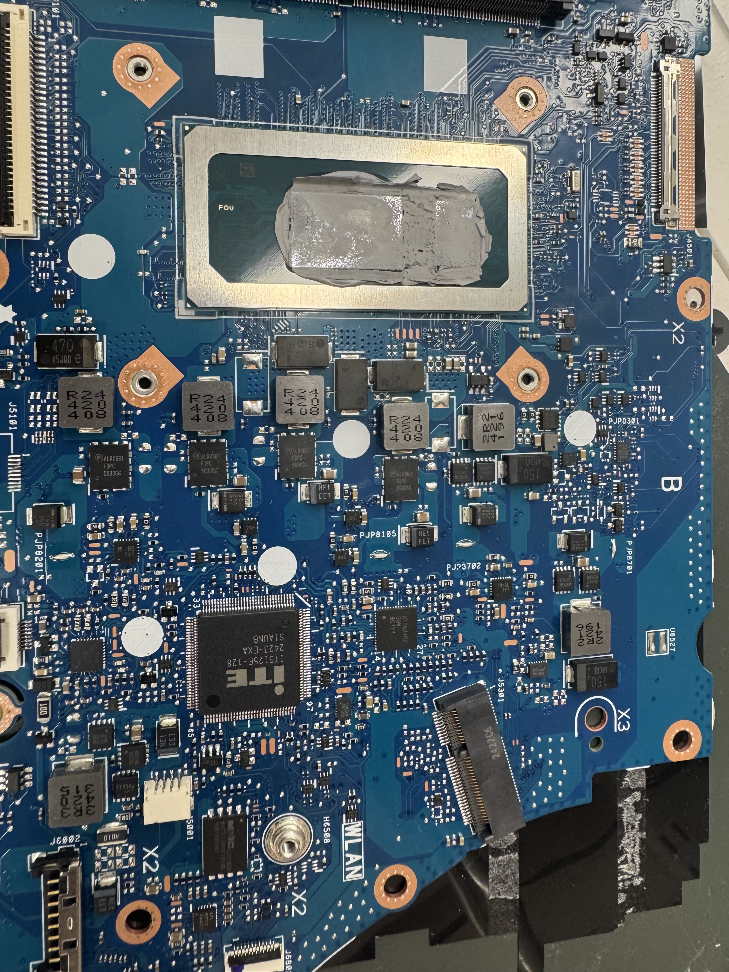

                                        I need help removing BIOS password from my laptop:
                                        Model: ASUS VivoBook X1404ZA-I38128
                                        Serial Number: S9N0CX03K597372
                                        CN: H51D
                                        Manufacturing Date: 2024-09
                                        Mainboard: X1404ZA R2.X
                                        Issue: MyASUS automatically set a BIOS password during an automatic BIOS update. I can boot into Windows normally but cannot access BIOS settings.
                                        Problem with BIOS extraction:
                                        - AFU gives "Error 31 - Unable to read contents"
                                        - RW-Everything shows "Driver cannot be loaded"
                                        - Universal BIOS Backup Toolkit also fails with driver issues
                                        - All tools fail on Windows 11 with driver signature problems
                                        Could you please provide a modified BIOS file for my specific serial number? Or guide me on alternative extraction methods?

                                        Use programmers, not software.
                                        https://www.badcaps.net/forum/troubl...21#post1622421
