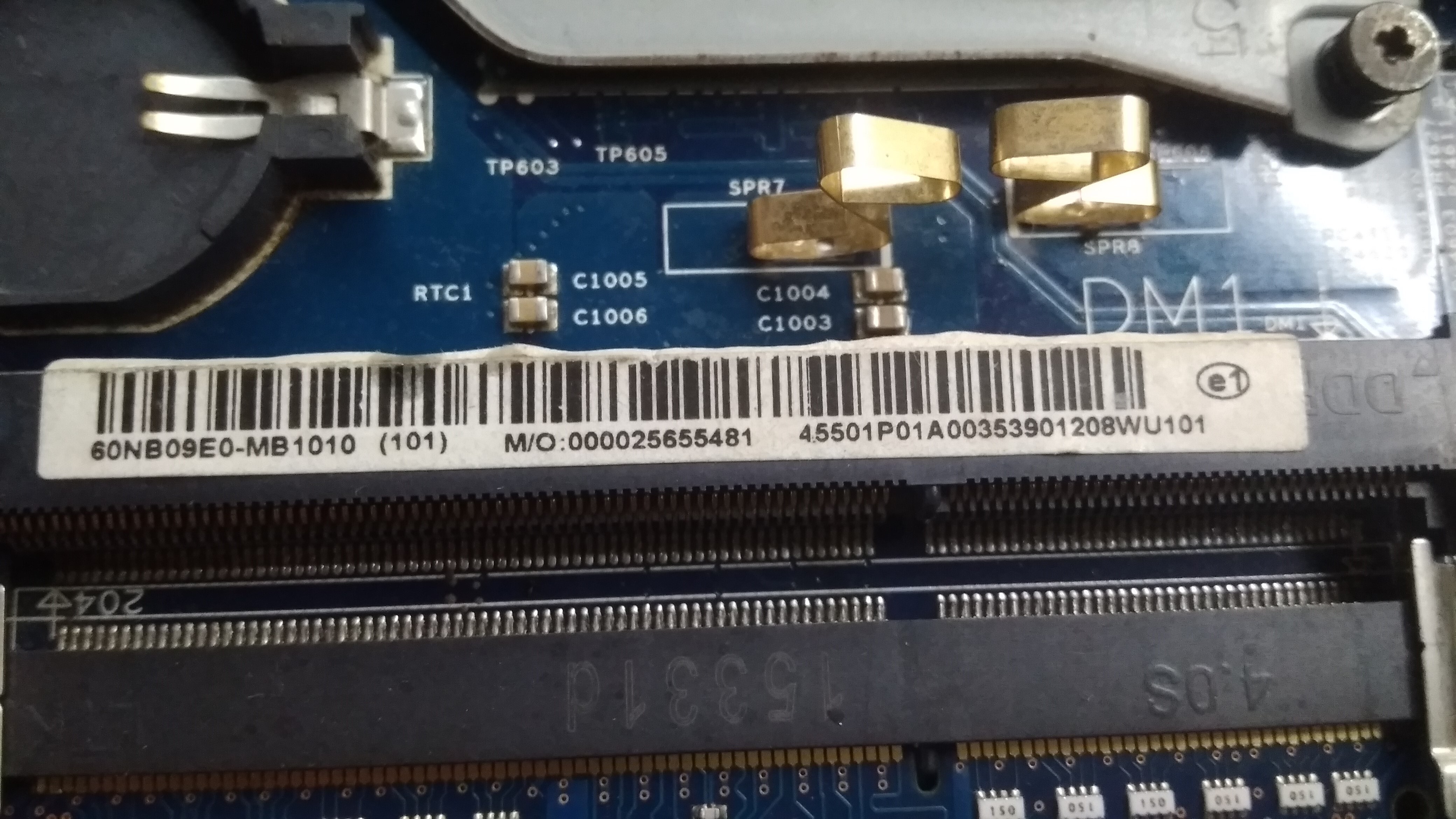

    Motherboard asus X450JB kode SV41 JN MB 13320-1
    CPU intel core i7-4720HQ
    GPU nvidia 940M
    PCH intel HM86
    if with X450JN bios, run windows normal but can't install nvidia gpu driver, not detect gpu chip.
    if with X450JB bios, run windows 30 minutes die/shutdown, install nvidia gpu driver succesfully.
    please help me, sir...

    Serial number ?

        but, this is replacement motherboard, and I found it in a state where the BIOS had been reprogrammed.

          The bios you provide is fresh and shoukld work without issue possible you need to look for other issue

          Post a picture of the long white barcode sticker on the ram slot.
          • jokophp
            jokophp commented
            Editing a comment
            yes sir, i've uploaded it.

          mobo barcode.
