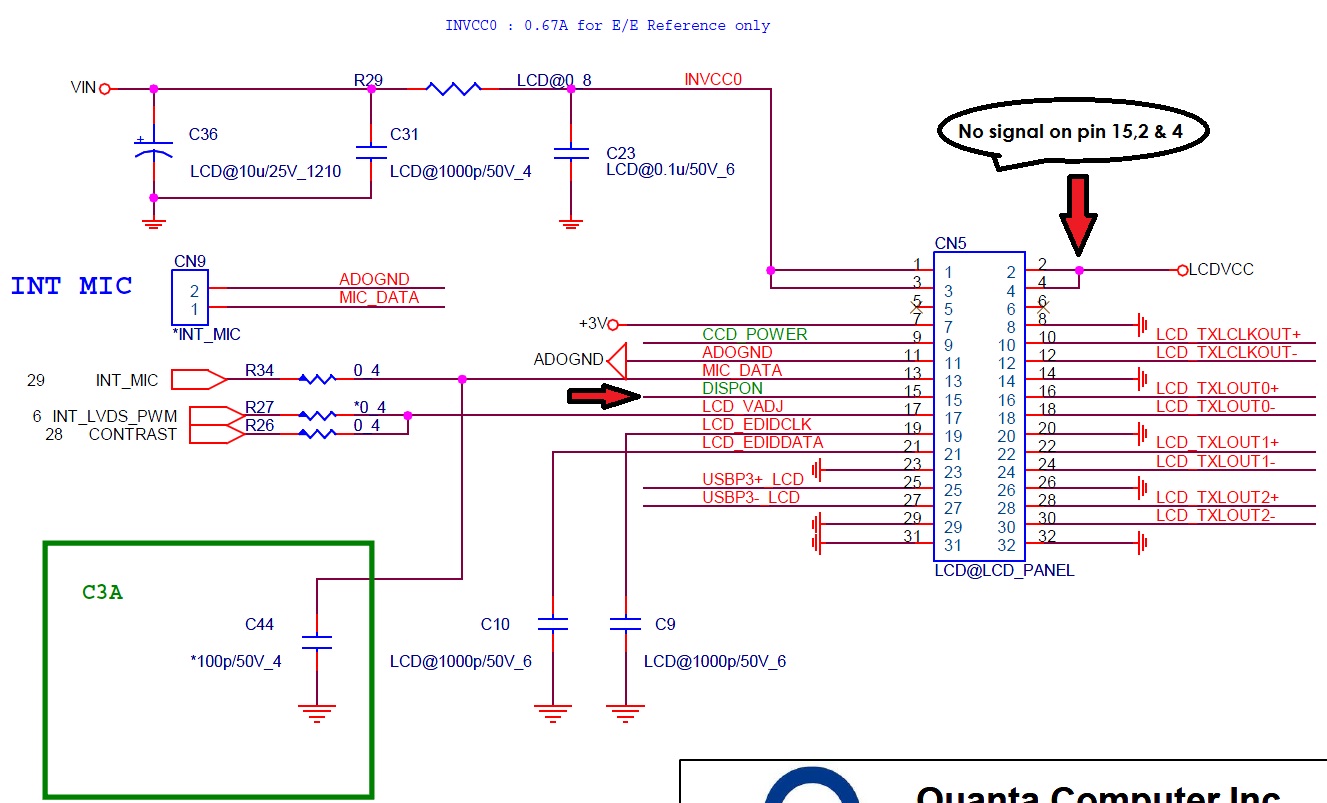

          Thx before spidey, yes you right. I've updated bios with the latest one but still same, before I go to NB chip. Is there possible EC chip problem ? there is no LCDVCC & DISPON signal on LCD SOCKET (CN5). I've check on pin# 6 (EC_FPBACK#) Hall sensor & Backlight with no output, who is controlled that signal ? NB or EC ? Looking forward for your advise

                Re: Toshiba Satellite M300 PSMDCL-05Y00D ( MB : DATE1MMB8E0 )
                check the signals ; LCDVCC, VIN,DISPON,LCD_VADJ on CN5.
                EC_FPBACK# signal is coming from EC.
                if you dont have some of the signals, you can manually add them. get +3v from LCD_VADJ and connect it to DISPON also get +3v for LCDVCC from another supply.
                it should work.

                  Only LCDVCC & DISPON missing signal on my CN5, ok I'll do it tomorrow as you say and I'll let you know the result.
                    After trying suggestions from spidey, with result just Backlight appears but no image, make me confuse, with curiosity before deciding to reballing, I try to check more thoroughly on flex, and guess what... found 4 wire connection is broken ? From there I've learn to more thoroughly when check Laptop that come from other technician , first come the laptop owner say this laptop been repair by other computer shop with condition no display, dismantle and found flux at everywhere. I guessing this laptop have a lot of problem , whereas it's only flex problem. spend a time for few days , I made mistake from beginning that only check flex from visual, not measure it the wire one by one. Thank's spidey, for your suggestions that solved this case. Great forum to learn
                    PS: Problem Solved
