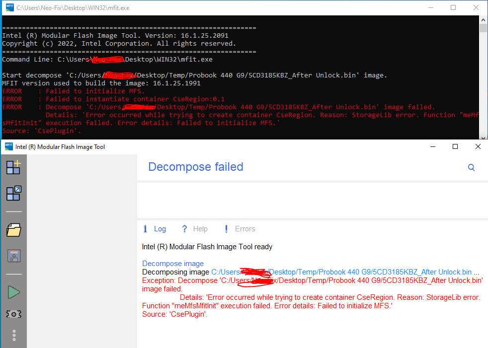

          Re: Clear ME Probook 440 G9
          Originally posted by hoaca388
          16.1
          Can't decompose the dump
          error : Details: 'Error occurred while trying to create container CseRegion. Reason: StorageLib error. Function "meMfsMfitInit" execution failed. Error details: Failed to initialize MFS.'
          Source: 'CsePlugin'.

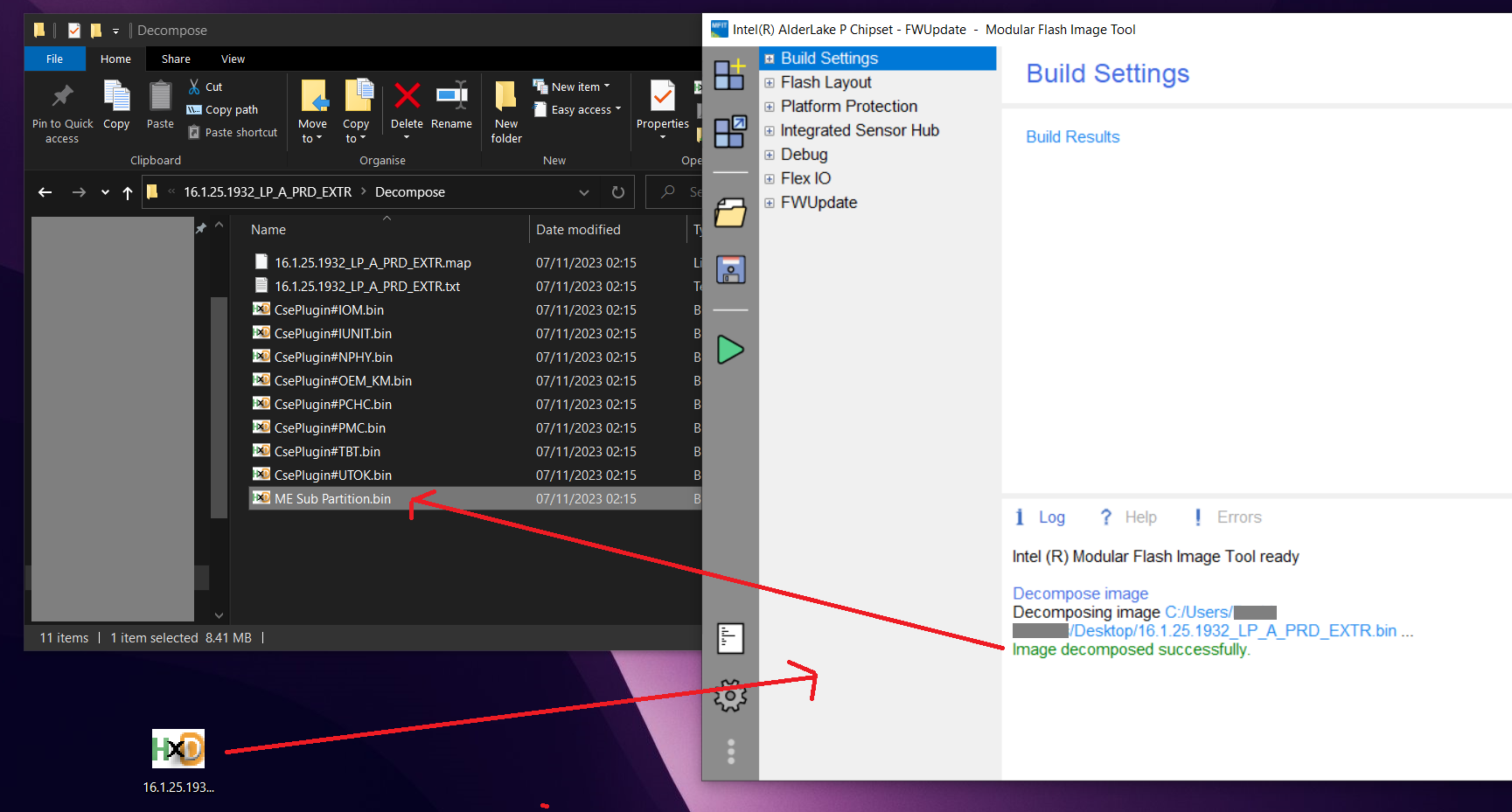

                            • MuertoGB
                              • Sep 2021
                              • 92
                              • United Kingdom
                              It's not decomposing as you're probably using the wrong mfit version, you need the one from here:
                              https://www.badcaps.net/forum/showpo...94&postcount=4
                              Also, I already cleaned your firmware here:
                              https://www.badcaps.net/forum/showpo...54&postcount=9
                              The UEFI in post 6 has an initialized firmware, it is NOT a clean firmware. Maybe the wrong file was posted.
