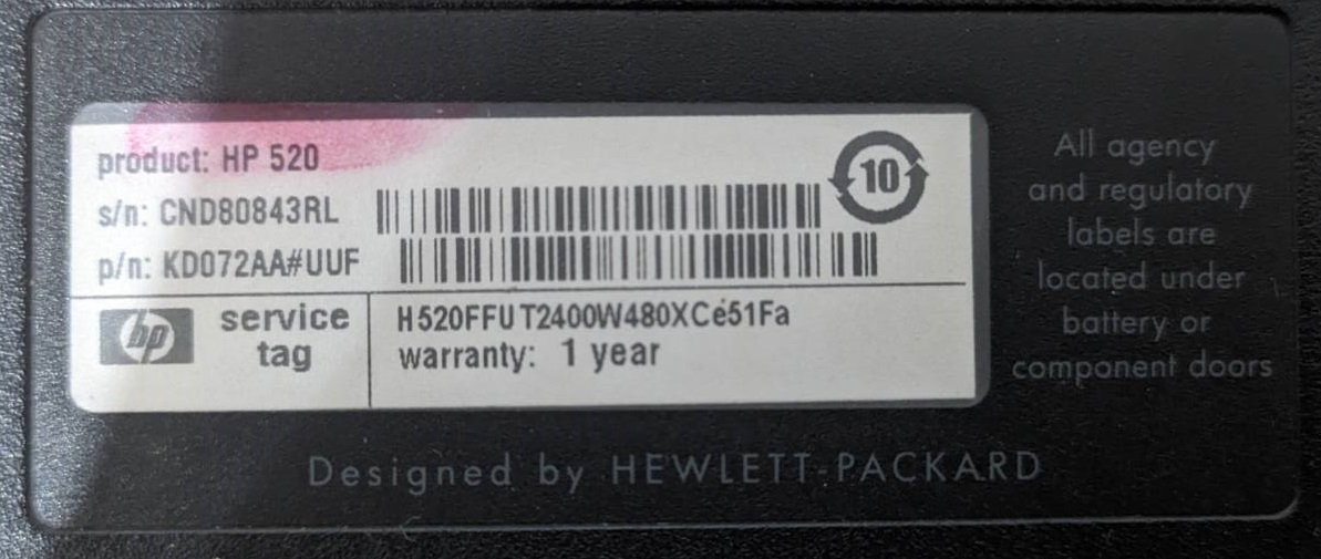

    HP 520
    S/N: CND80843RL
    IAT50 LA-3491P REV 1.0
    issue if you powered on the unit , and you shutdown it will not open again, so you need to cmos reset it to power on again

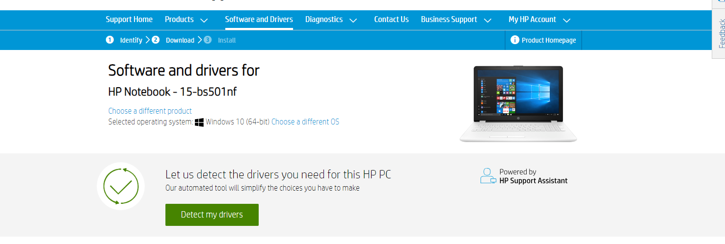

      The HP 520 is a printer. According to the serial number you posted the laptop model number is 15-bs501nf .You havn`t included any model in your thread title !

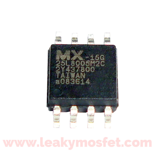

          its a 1MB bios
          My bios chip is Mx25l8005m2c

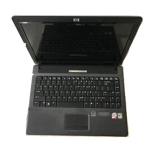

            This is the laptop its old model, based on the serial ive tried also its a different laptop dont know why

              Find another chip, according to the serial number you posted, it has an 8MB bios. Look for a chip with code like: 25Q64...

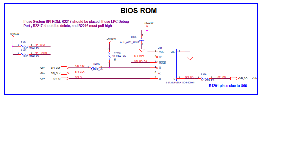

                Ive look in schematic its only 1 U21
