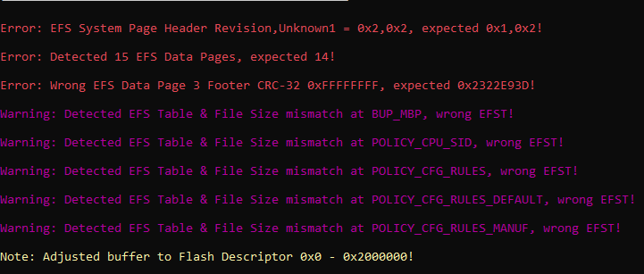

    The laptop came in for not having picture on the screen after a bios update.
    I need the dump file for the main bios.
    Lenovo ThinkPad T14S gen 2.
    HT4B1/HX3B0 NM-D362 Rev: 3.0
    U2201 BIOS 25R256JV
    U2202 25Q256JV

          Thanks for the file! However it doesn't work. With the original bios file the laptop turns on and the backlight turns on. After a 15 seconds it resets and the cycle starts again.
          With your file there is no reaction to the power on button. I've put the backup file back just to check and it works the same way as before.

            You're welcome, there is nothing else to do with your file. I don't know why the device refuse to turn on, perhaps you didn't program the file correctly (Use verification), the chip isn't soldered well or the device has a Hardware issue.
            By the way, your file shows error messages in ME Analyzer, so it shouldn't work at all.

              I've check the soldering and verified the file twice. I've also seen ME error when tried to clean it

                I've found the solution!
                A combination of you file and the update file from the Lenovo website did the job. After reflashing with this file it worked.
                I've attached the file which worked for me if someone needs it.
