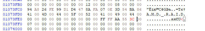

        Help me get DMI information, HP Pro x360 435 g9 with password, SN: 5CG3216GHC, and tell me how to do this, and did I correct main correctly?

            Thank you very much, I know about the stickers, but I would like to learn how to get dmi with a dump, do you get it manually or using a program? Hex did not find the information, is it encrypted?

          For some reason I couldn’t remove the password, can you help? There are 2 files here, my own and one edited by me.Tell me where I made a mistake?
