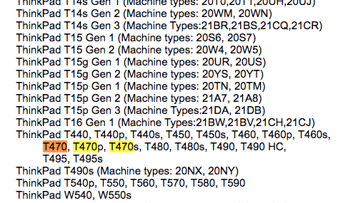

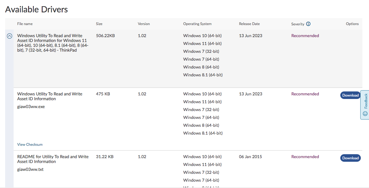

    If it can`t be done by editing there`s a windows app https://support.lenovo.com/gb/en/dow...4-bit-thinkpad

          there is a utility to write Asset ID

              a hint: if you want to do the job faster use a separate bios chipset for patched file and leave original bios chipset as is. You can use chipset with patched file for all 100 laptops if they are the same model, no need to patch every bios dump.
              If you want to get rid of Asset ID by modifying bios you have to clean ME Region. But it would be much faster if you install win on one ssd and that utility and use it for all 100 laptops to remove Asset ID. Just an idea.
