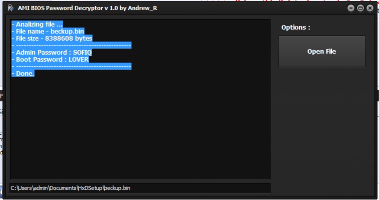

    hi i have asus e200ha rev 2.5 (version 303) locked i have dump bath locked
    plz any solution to unlock it or any clean dump for this model

    You see - it's not that hard to use the search engine and read the rules.
    Here's your passwords as I promised:
    Admin password : SOFIQ
    User/boot password : LOVER

      thank you for help . User/boot password work bath Admin password not work
