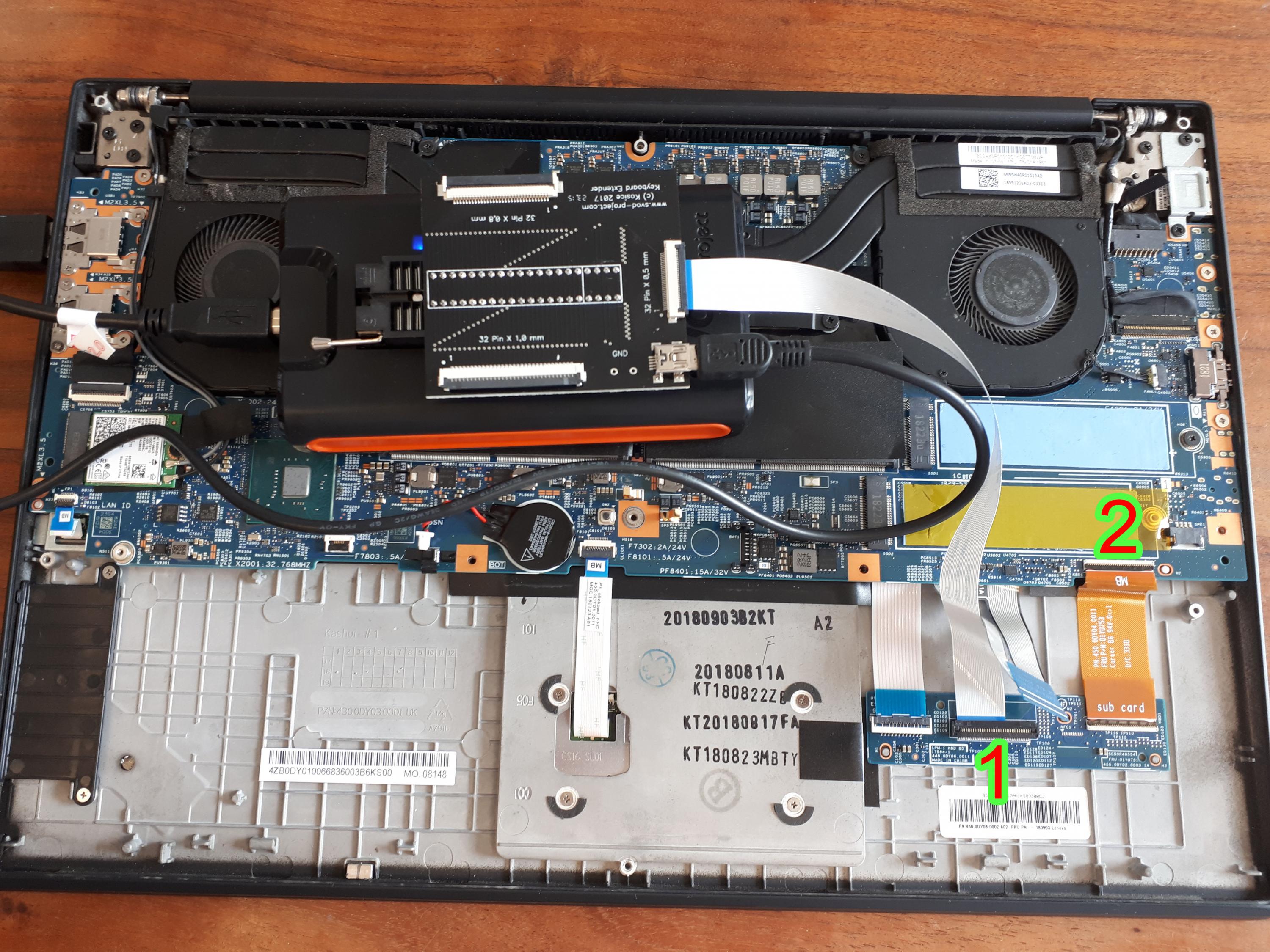

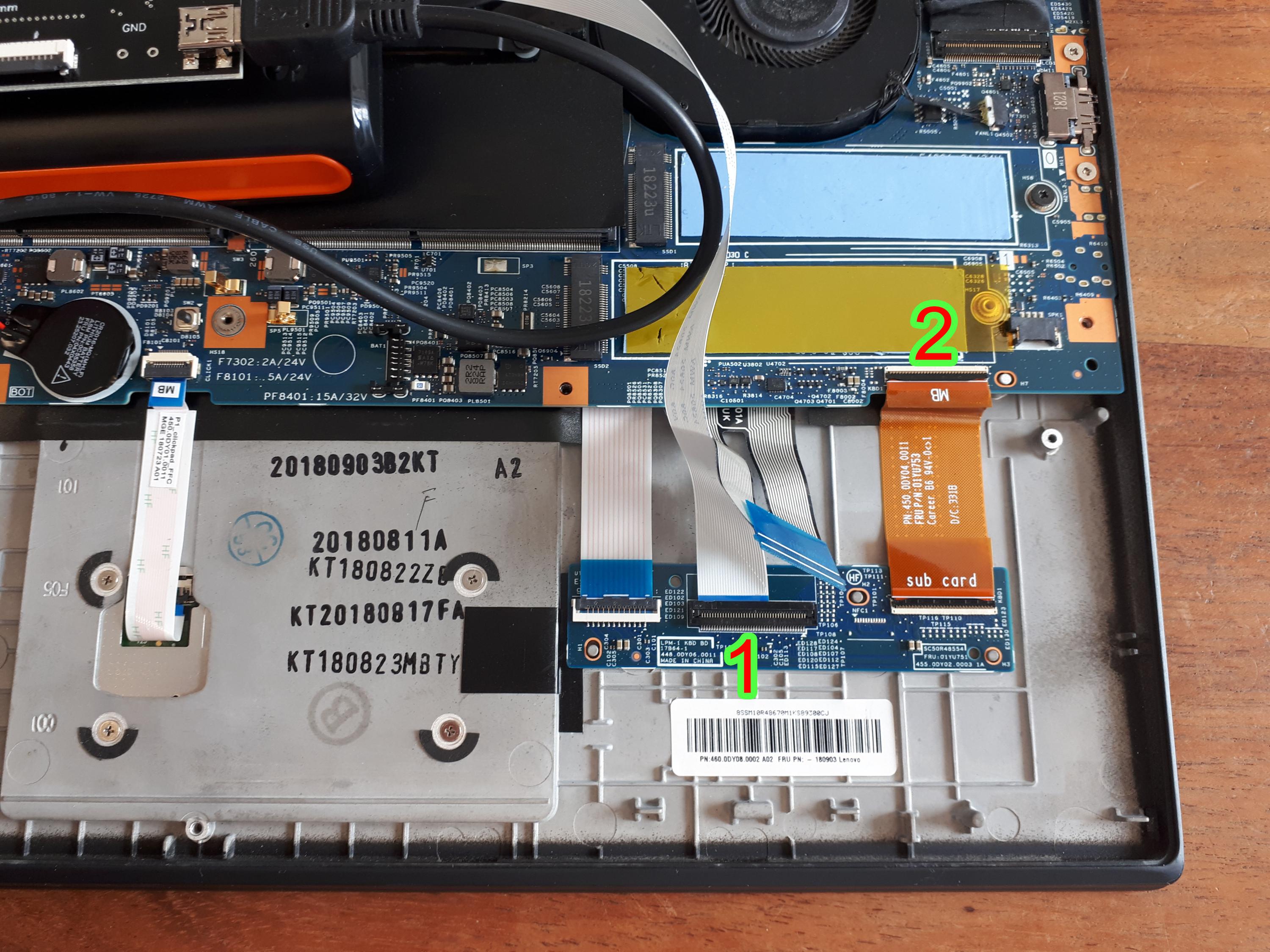

                  Can you tell me, where i have to connect the programmer? On connecter 1 or 2?
                  Edit:
                  OK it is a MEC 1653. So i can't read over keyboard controller??? I have to read over JTAG1. Is this right?
                  Board is LPM-1
