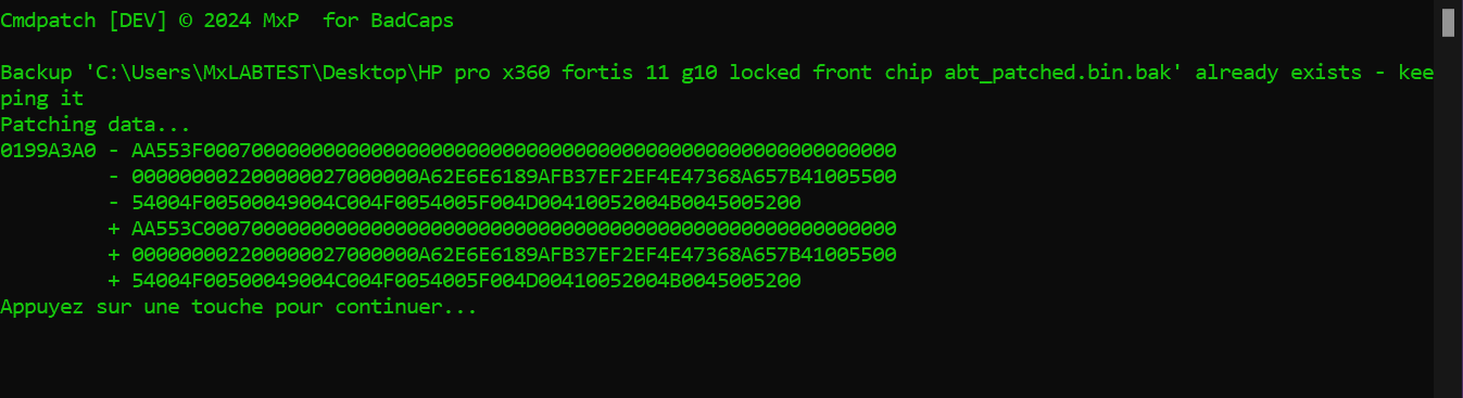

                    [QUOTE=asd90011;n3449749]
                    Good Day,
                    Please help remove or disable Absolute Persistence[QUOTE]
                    try

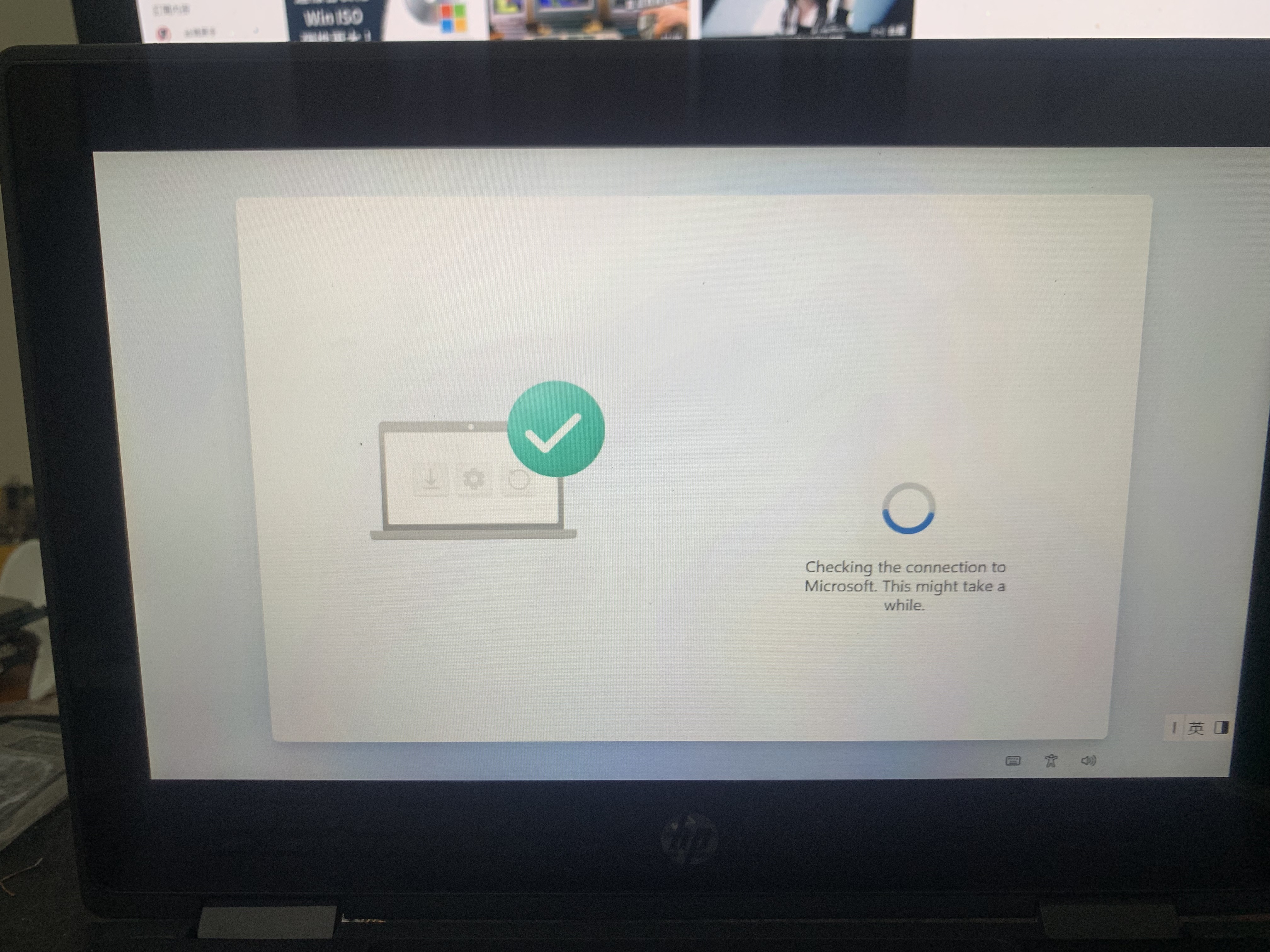

                      After I flashed the bios, although the password has been cleared and Absolute Persistence has been disabled, I found that after installing Windows, it will still force you to connect to the Internet. After connecting to wifi, you will still be asked to log in to a company account before you can continue to use it.

                        try
                        without autopilot

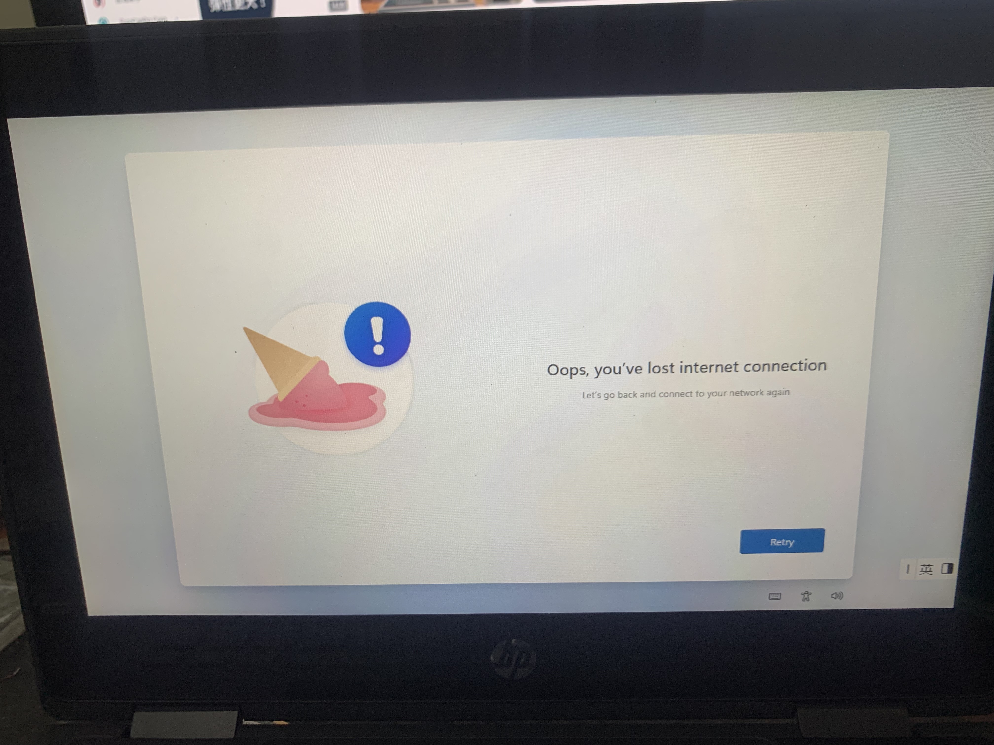

                        • asd90011
                          • Apr 2020
                          • 11
                          • US
                          It will always appear now
                          Oops, you‘ve lost internet connection
                          Click a few more times and it will appear
                          Checking connection to Microsoft. This may take some time.
                          Just keep spinning in circles
                            try
                            first boot press f10 apply factory defaults and restart, 2nd boot reset security settings to defaults and exit.
                            use BCU. you can permanently disable Absolute lock in BCU.

                              Hello, I have no problem after testing. Thank you very much for your help.
