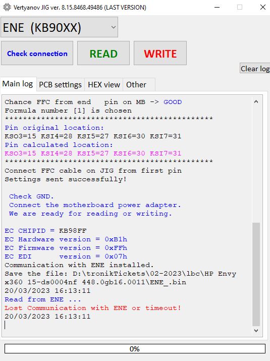

    Hello all
    Machine is an HP Envy x360 convertible.
    Model 15-ds0004nf
    board info
    Pacific Ocean Rota 15 Picassco
    18747-1
    448.0gb16.0011

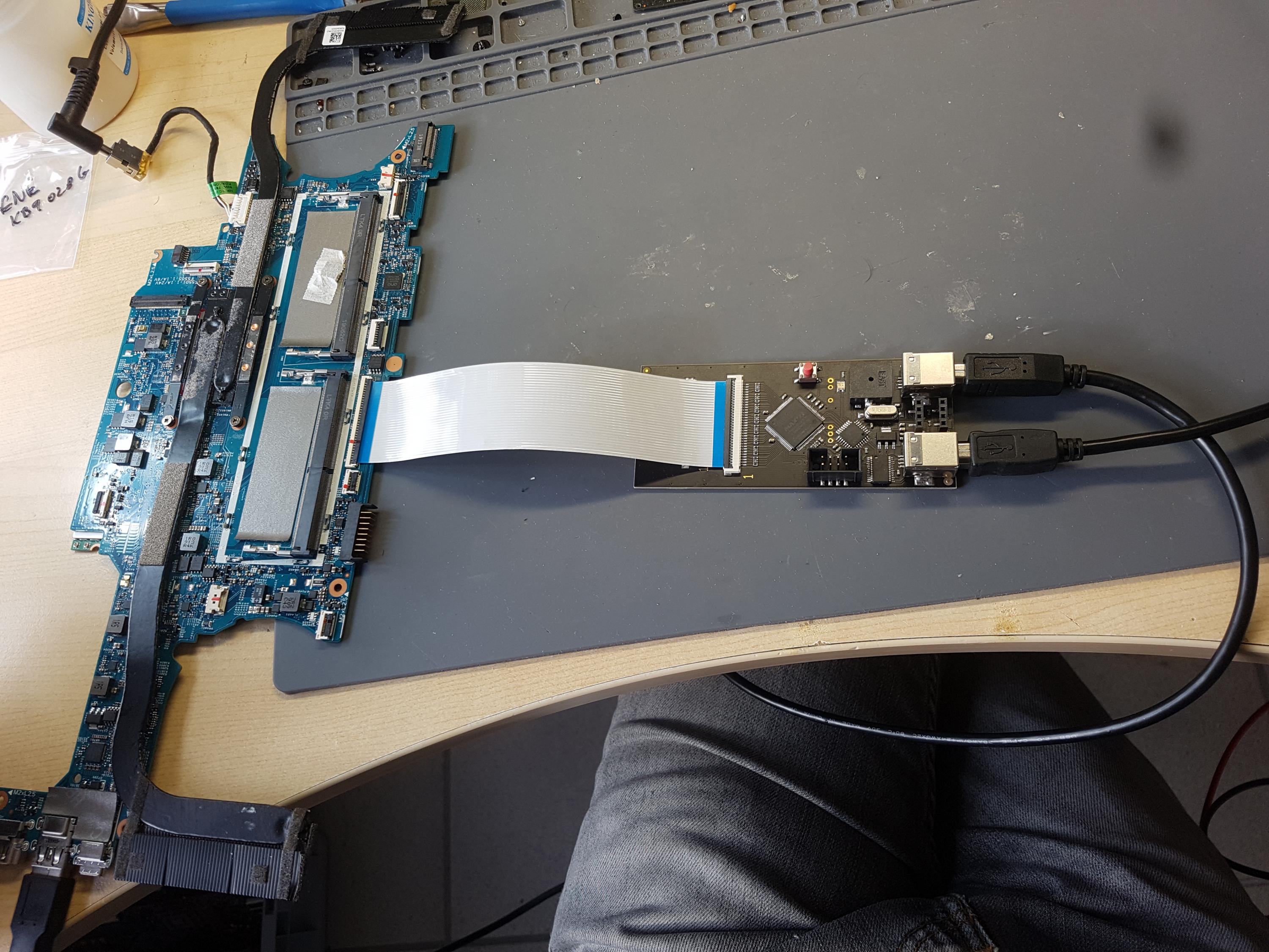

    Im working on this motherboard, can check the other thread here.
    https://www.badcaps.net/forum/showth...ht=15-ds0004nf
    I was able to get the board to a better condition after replacing KBC, 3.3V and 5V ics
    But it still does not power on
    As ive replaced the ENE kb9028g , I think it needs programming
    Has anyone a dump for the KBC for this model?
    Im using Vertyanov Jig, when I try to read/save the kb9028g I have a lost communication error...not sure why
    When I have a dump I will test
    Thanks!

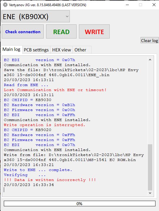

    Humm
    Tried with an MSI dump for this KBC IC, and It says data written incorrectly...
    Doesnt look promising...
    I ordered 2 KBs from Ali, first IC did not worked at all, this one at least is detected but seeing these errors , not sure they are 100%...
