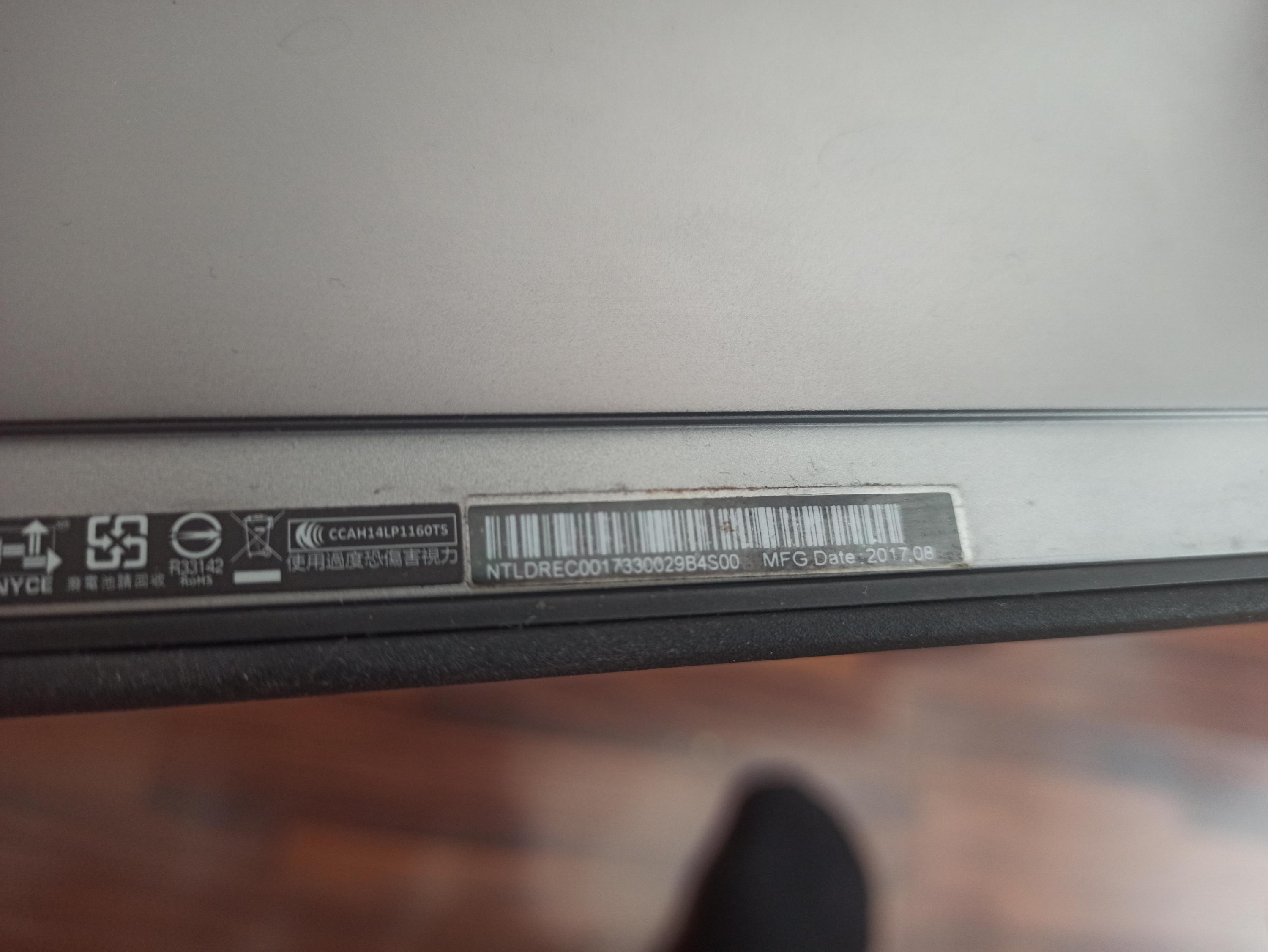

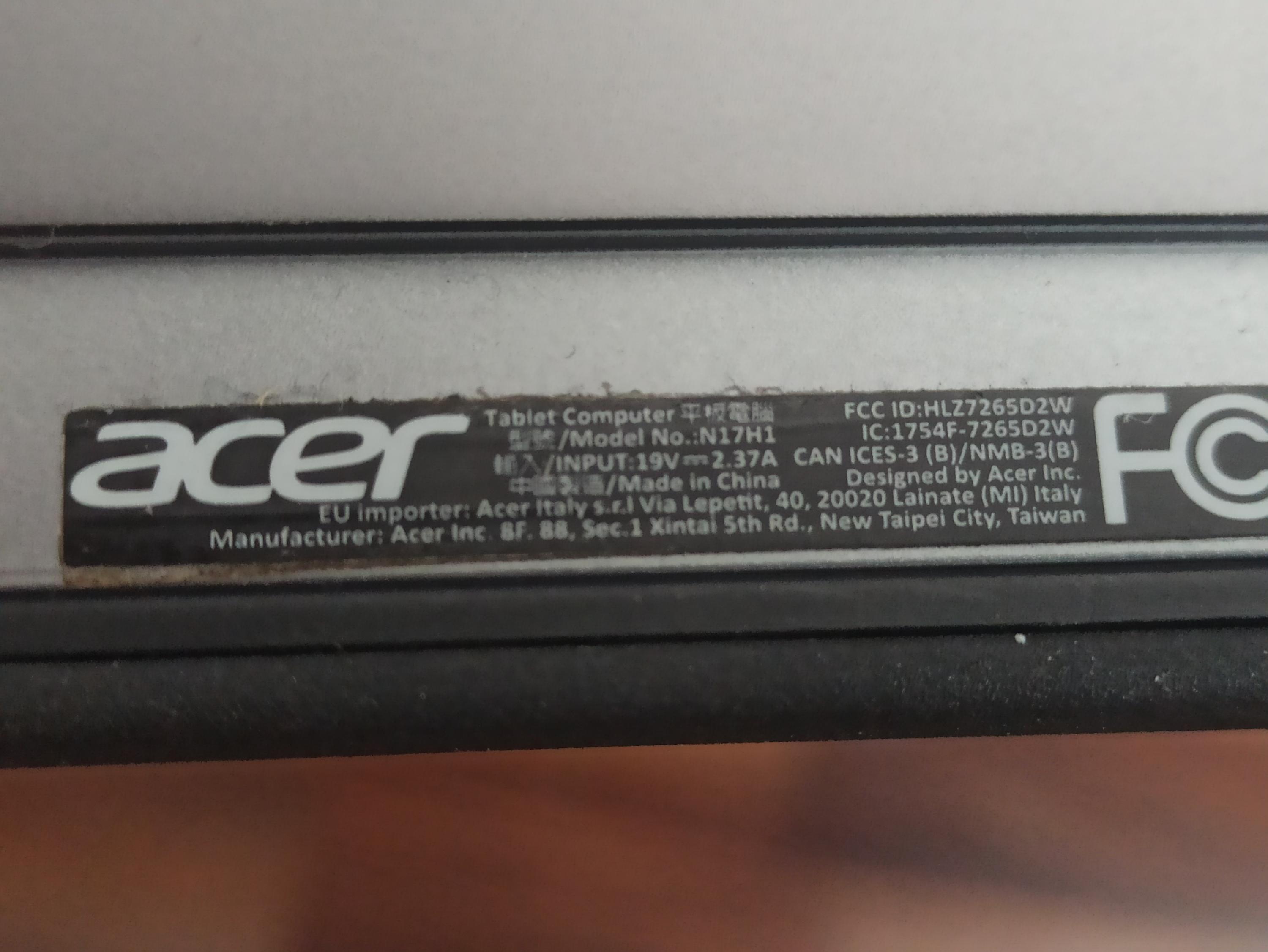

    write here laptop snid /serial number

      Re: Have somebody bios for acer switch 3 sw312-31
      here

            Here's your New BIOS, it's a Virgin BIOS from Acer with your DMI and Windows Key.
            Serial Number: NTLDREC0017330029B4S00.
