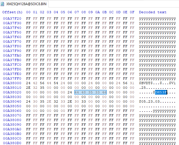

    when press power display light up white (i think backlight) then turn off

    I think this file not your Original Bios, because it doesn't contain your Serial Number, also its board is (DH53F) not (GH51M).
    Try those files one by one and see what will happen:
    https://www.badcaps.net/forum/showpo...4&postcount=16

              According to your Serial Number and Motherboard Number, one of those files in that thread should works, Post #13 and #16.
              https://www.badcaps.net/forum/showthread.php?p=1191194
              According to your Backup BIOS, one of these files which I attached here should works.
              Note: All files are Virgins from Acer website, so if they doesn't work you should have a Hardware issue.
                Its been flashed with the wrong bios
                Originally posted by darckreign1984
                on motherboard
                GH51M
                GH51M
