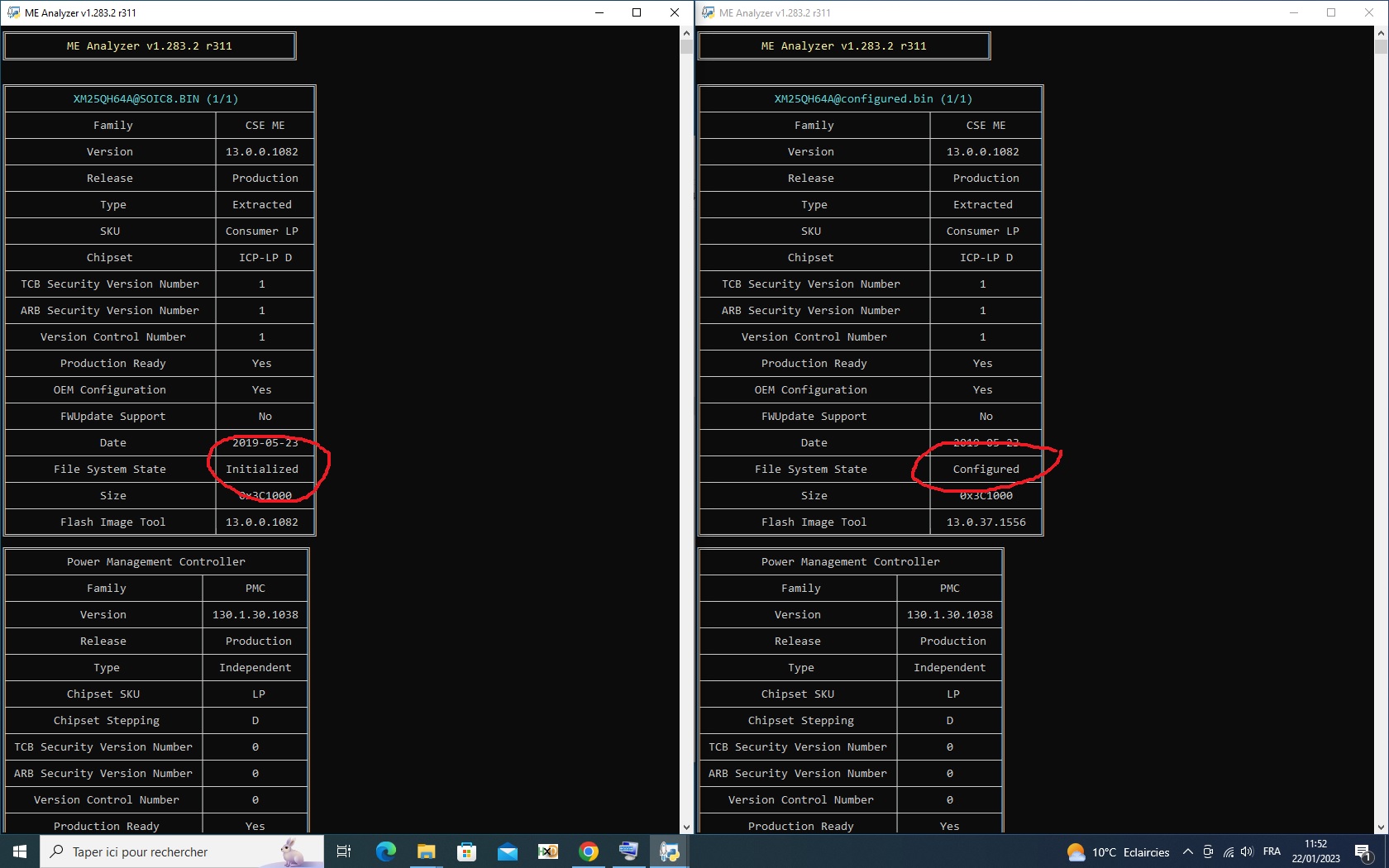

    dell Inspirion 3591 dump needed
    hello friends
    kindly help me fix my bios
    the machine does not start at all
    when i cam to the site i tried different dumps but it only went on but without display.
    board number:
    FDI55 LA-J081P rev 1. 0(A00)
    i cant access the serial number
    where its written is blur. u can no longer see it.
    its an i3 10th gen

        • 22275
        Re: dell Inspirion 3591 dump needed
        Originally posted by hirens
        let me load it up
        gona give feed back
        If it does work it will boot slow, the ME firmware will need cleaning as its "Initialised" (dirty) and not "Configured" (clean)
          it runs the backlit, fan runs , screens goes black but no display
              no display still
              fun runs
              screen goes balck but no display
                okay i got a working dump from vina fix
                let me attach it for future help
                • lapfix
                  • Mar 2020
                  • 2764
                  • my workshop
                  Thank you
                  this files posted are initialized
                  this is the configured one
