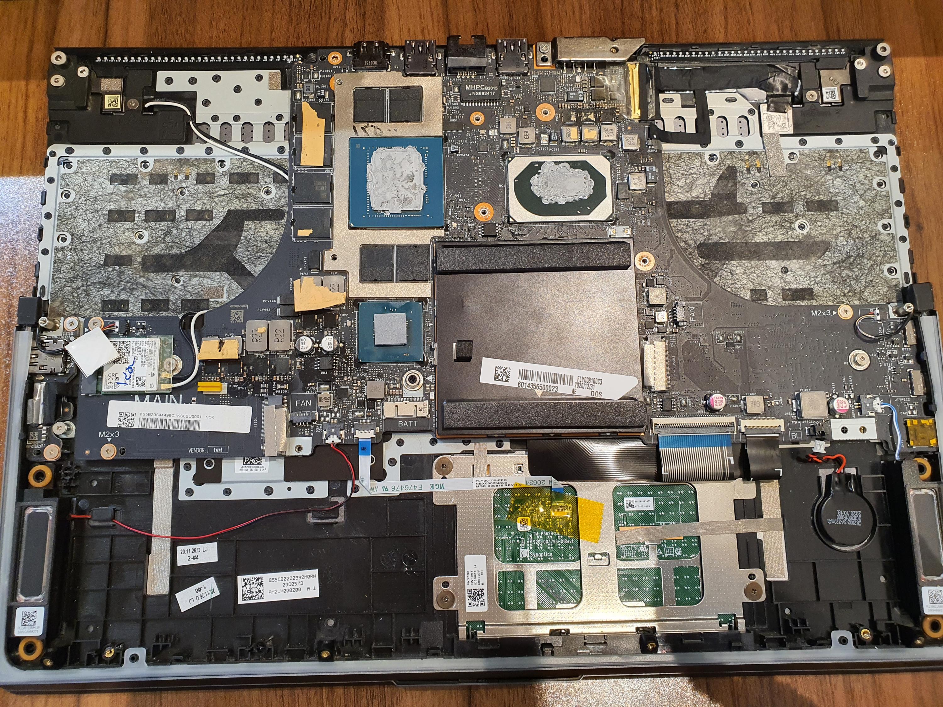

    my lenovo legion 7 decided not to post one day and its stuck with only RGB on (no display output) so i decided to remove the cmos battery and leave it over night nothing changed (still only rgb on) so i decided to reflash bios chip (winbond 25Q80EWSIG) and when i downloaded a bios binary (from here) (insyde bios) and my programmer (ch341a) says its too big of a file size (it says my ic chip is 1m-bit and the bin file 16m-bit)(and even though its literally desinged for my model) so i said ok i'm gonna download from lenovo the biospackage.exe file then i would extract it and reflash it and guess what (that file is 16m-bit too) i just don't know what to do now please HELP

    The winbond 25Q80EWSIG is not the bios chip, it is for Thunderbolt firmware or something else.Don`t erase the contents of that chip,i hope you made a backup.The bios chip is somewhere else on the board

              Neither of them. What is the motherboard part number, it will be in white silkscreen paint, it could be LA-J561P .The chip is most likely to be WSON8 ,look under the plastic sheet ,it could be hiding

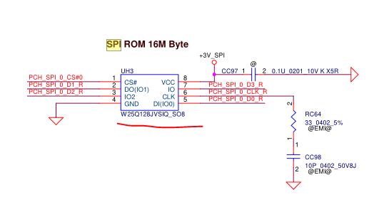

                    According to the schematic the bios chip location is marked UH3 ,and it is a SOP8 chip https://www.badcaps.net/forum/showth...light=LA-J561P
                    Make a backup and post it here, don`t try flashing any other bios yet.

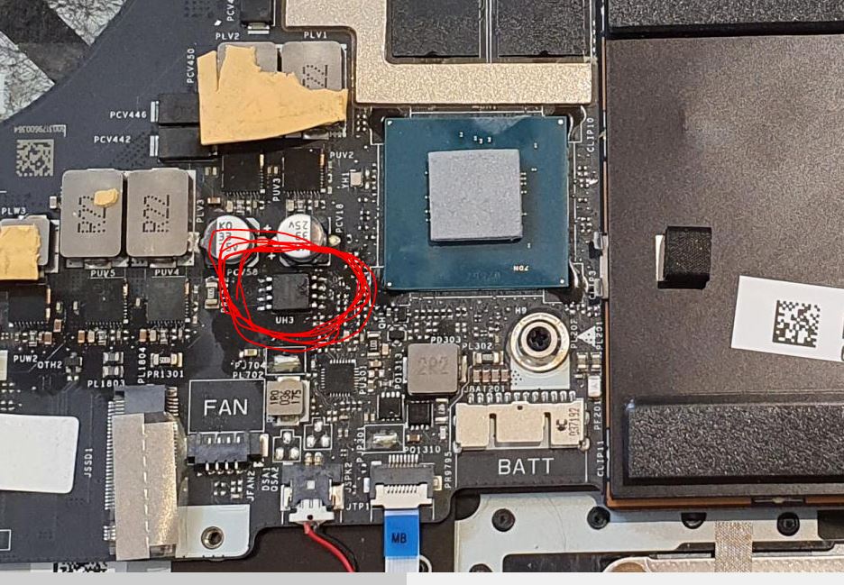

                      ok so i found the letter UH3 right below the chip you said it wasn't a bios chip written on the board it self so i put my clip on top of it but it doesn't connect to my raspberrypi is that a spi device or other kind of device because SOP8 is SPI i think
