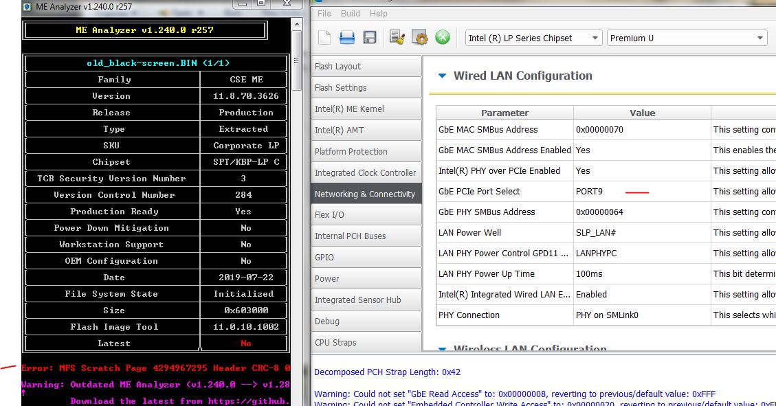

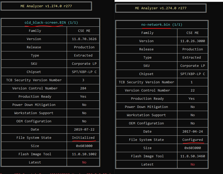

    Are you sure the file which named (old_black-screen) is your original file? because it has no MAC Address. Otherwise the file (no-network) has MAC Address and also ME Region is Cleaned.

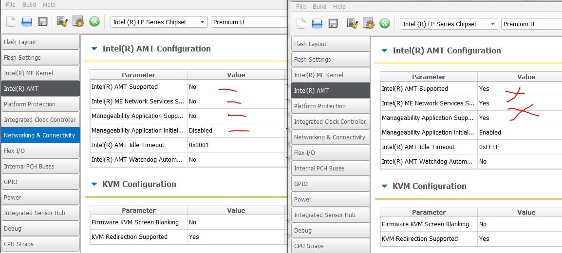

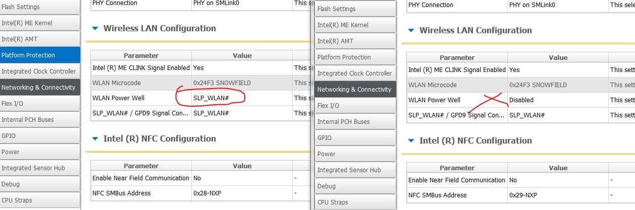

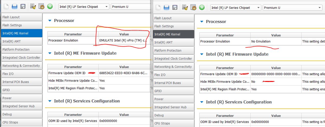

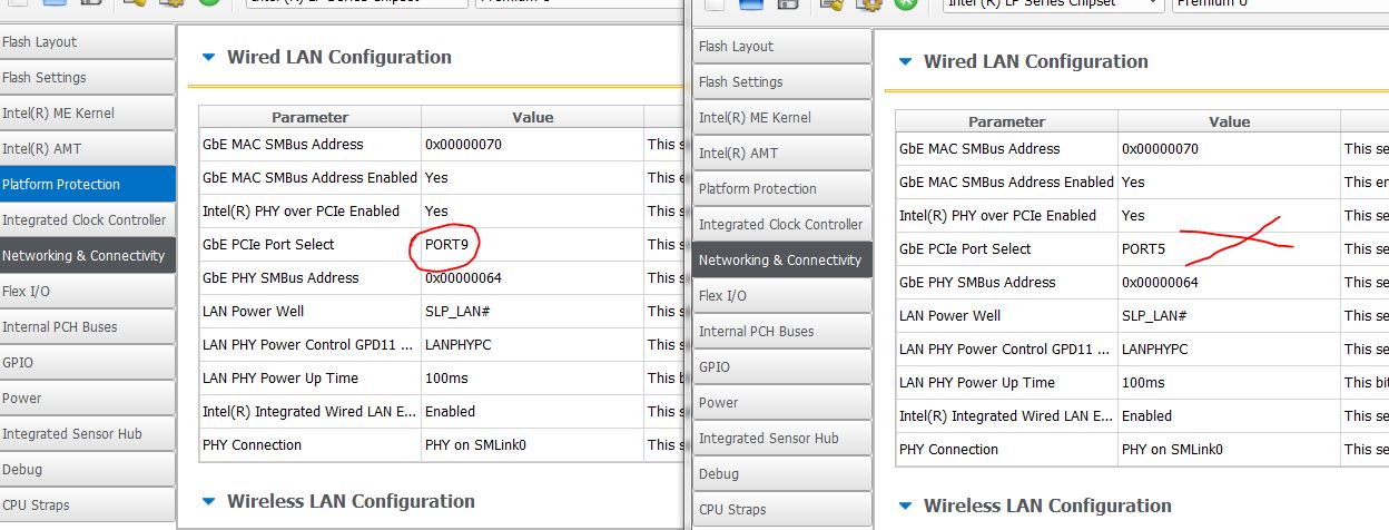

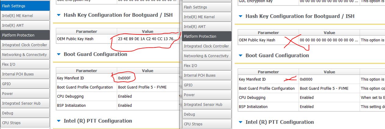

        Its advised to always post the original bios to get the original OEM ME configuration when cleaning the ME firmware.Here`s pictures of both bios opened with FIT showing the differences between the two,and why the 2nd bios isn`t working properly
        Your original bios does have some problem with the MFS part of the ME but cleaning it should have fixed that,the ME settings are the original OEM`s.

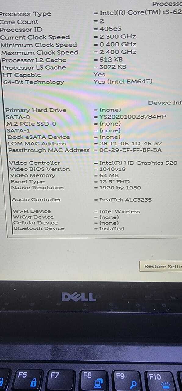

                      HI every one i have DELL E 5270 st- G4TMR72 Problem is not wifi show in bios here is bios file can any fix for me

                          Thanks for repaly hoaca388 problem is not sloved fist time shows wifi than restat not show in show

                            This is clearly a hardware fault.
