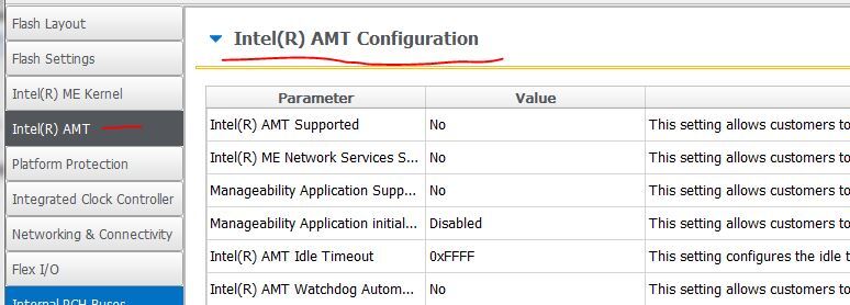

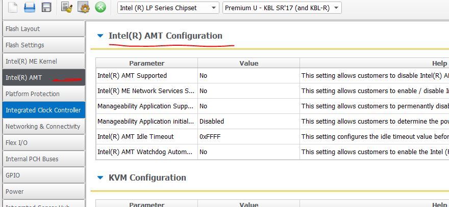

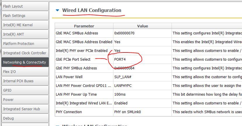

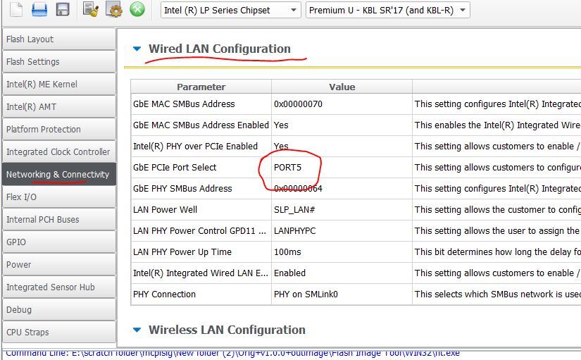

        Check differences between the original bios at post 16 ,and the one you tried at post 20
        post 16
Name:	1. Product specs.jpg
ID:	3159908 Click image for larger version
Name:	2. vPro Disabled.jpg
ID:	3159909 Click image for larger version
Name:	3. AMT config.jpg
ID:	3159910 Click image for larger version
Name:	4. Wired LAN config port.jpg
        post 20
Name:	1. AMT config.jpg
ID:	3159912 Click image for larger version
Name:	2. Wired LAN config port.jpg

          THANKS FOR THE INFORMATION. BUT WHEN I CHANGING POST NO 20 BIOS (DISPLAY OK BIOS) GBE PCIE PORT 5 TO 4 THEN DISPLAY NOT COMING
            CHK YOUR LUCK AGAIN
