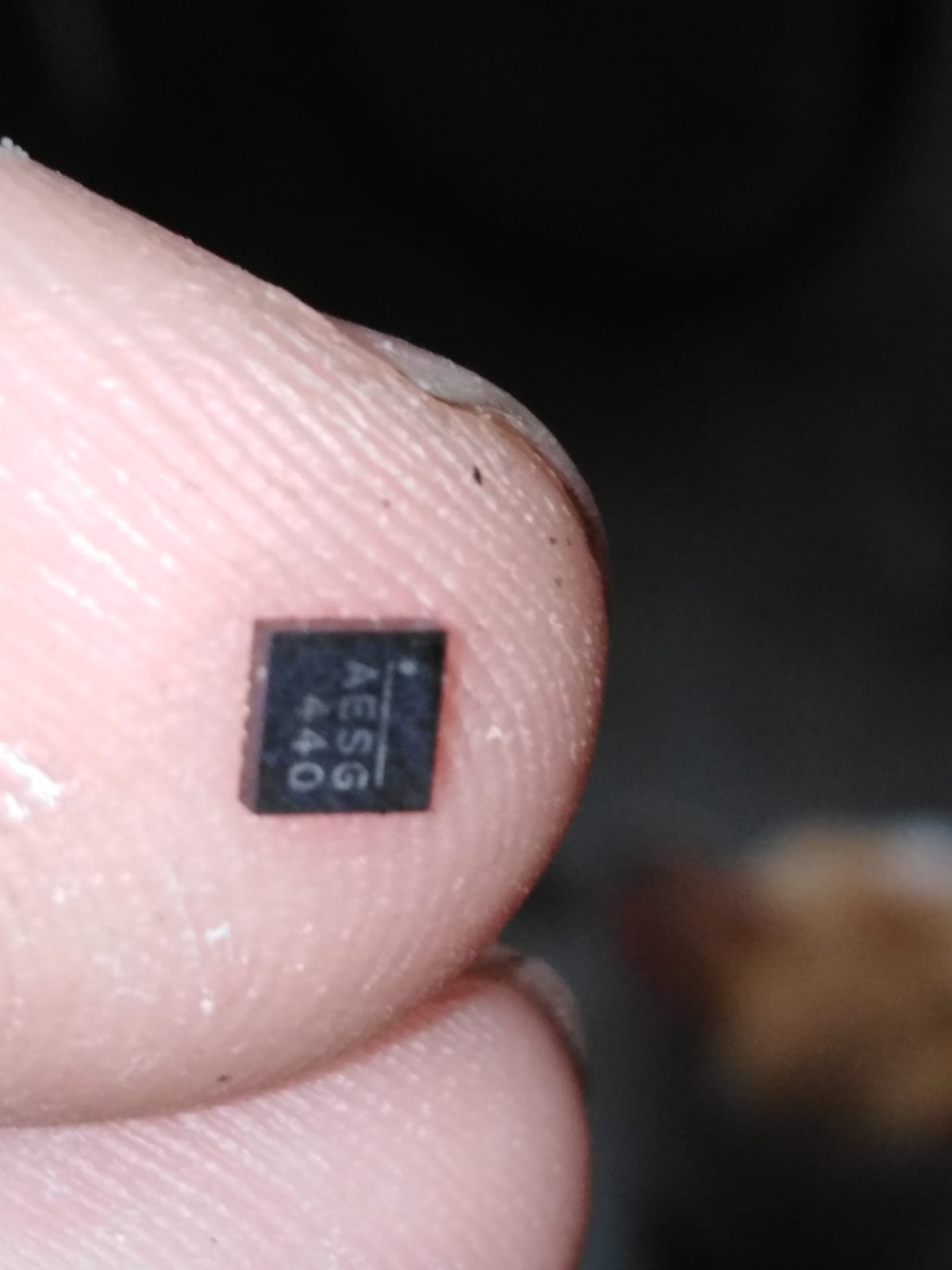

    hp elitebook 840 g3 ic problem
    problem with AESG 440 ic cannot find this one anyware did any one know compitable one attached photo

    Re: hp elitebook 840 g3 ic problem
    I thik it is NB6771GQ
      I think you made a typo
      AES NB671LGQ QFN16 (3x3mm)
      https://www.badcaps.net/forum/showpo...85&postcount=3
      Marking List April 2022 pdf https://www.badcaps.net/forum/attach...3&d=1652723341
      Datasheet https://cdn.badcaps-static.com/pdfs/...d4fe333f1e.pdf
        Yes sorry you are right.
        My excuses
          tnx all
